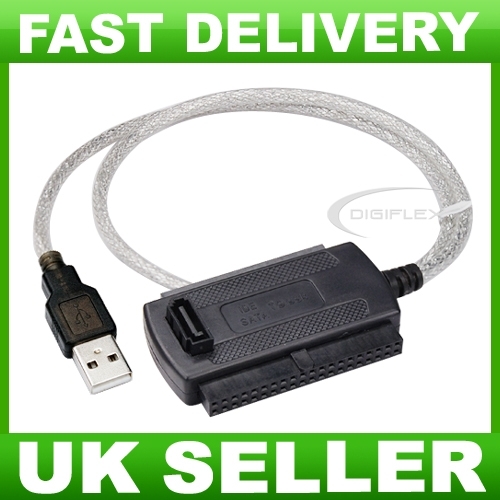

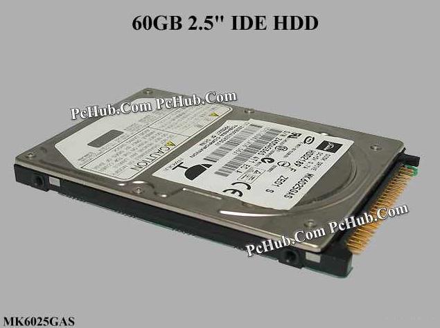

Hello, i've this Toshiba MK6025GAS which is detected in windows with this IDE to USB adapter:
If i connect the drive in pc3k DE with PC-2″ adapter, the drive isn't detect

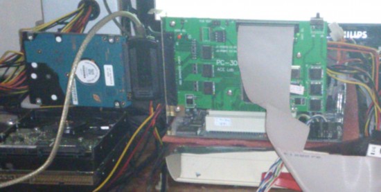

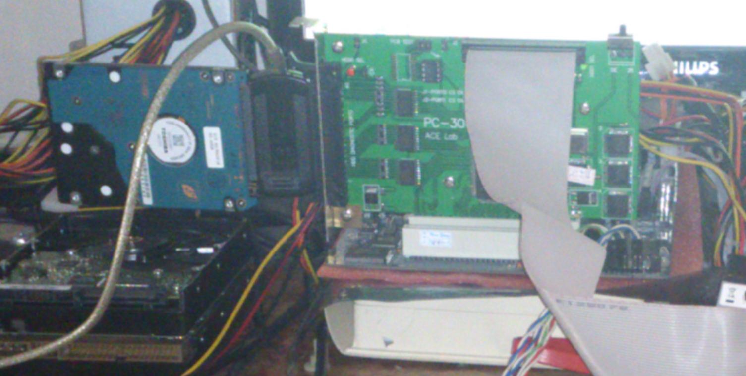

Problem solved
I solved the problem in another way...
I took the IDE to USB adaptor which you can see in the first pic i posted in the first post, which has the mini IDE connector.
I connected the drive to the mini IDE of the USB adaptor and the other side of the adaptor (IDE) to the ATA-0 port of pc3k.
Then i powered it via the usb cable, i builded an ATA to USB cable to power control the adaptor via pc3k ATA-0.
Works fine. :lol:
