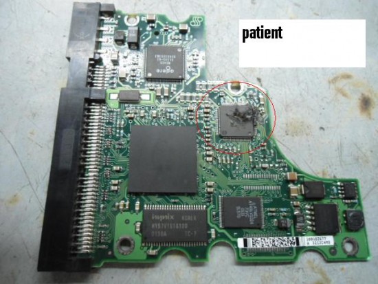

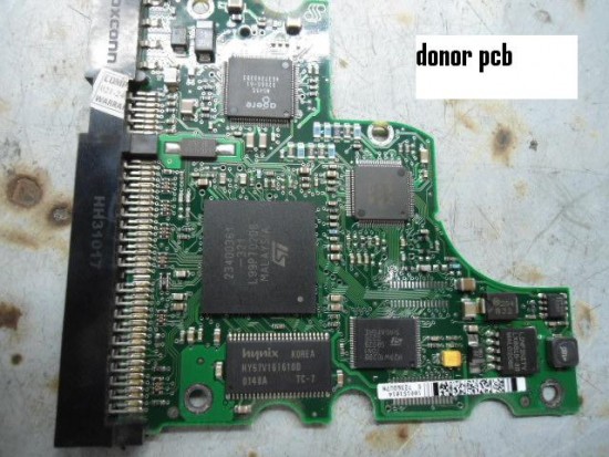

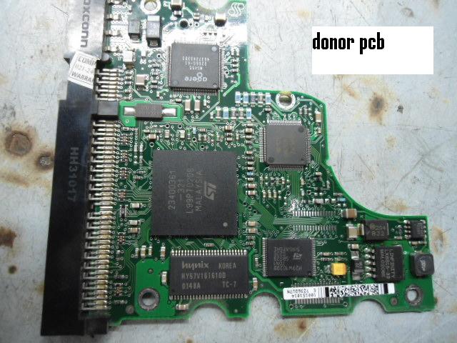

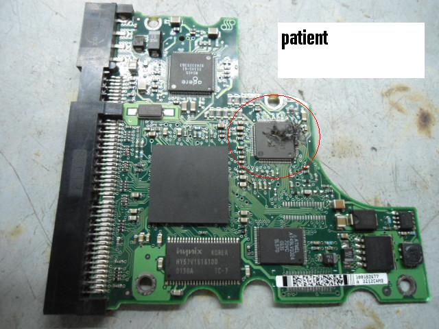

dear friend & seniors
I have a hard disk
seagate BARRACUDA ATA
Model ST320011A
i have replace a damaged pcb with ok pcb but hard disk has no power
please guide me how i solve this problem

IF PCB is compatible, either headstack is killed (you have a precise output) or motor is killed, or both.
Time for cleanroom work :(

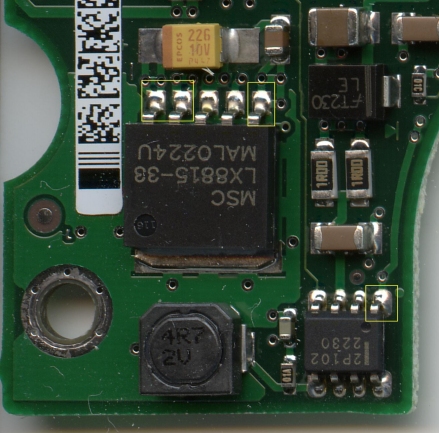

The damaged chip is the motor controller, and the damage is on the motor side. Did you measure the resistances between the motor terminals?
You could also verify the voltages at the LX8815-33 regulator and the FDFS2P102A FETKY. See the attachment.
FDFS2P102A, Integrated P-Channel PowerTrench® MOSFET and Schottky Diode, Fairchild, 20V, 3.3A:
http://smartdata.usbid.com/datasheets/u ... 2p102a.pdf
LX8815-33, 3.3V, Linfinity, Dual Channel 1A Low Dropout Regulator:
http://www.datasheetcatalog.org/datashe ... SC1645.pdf
