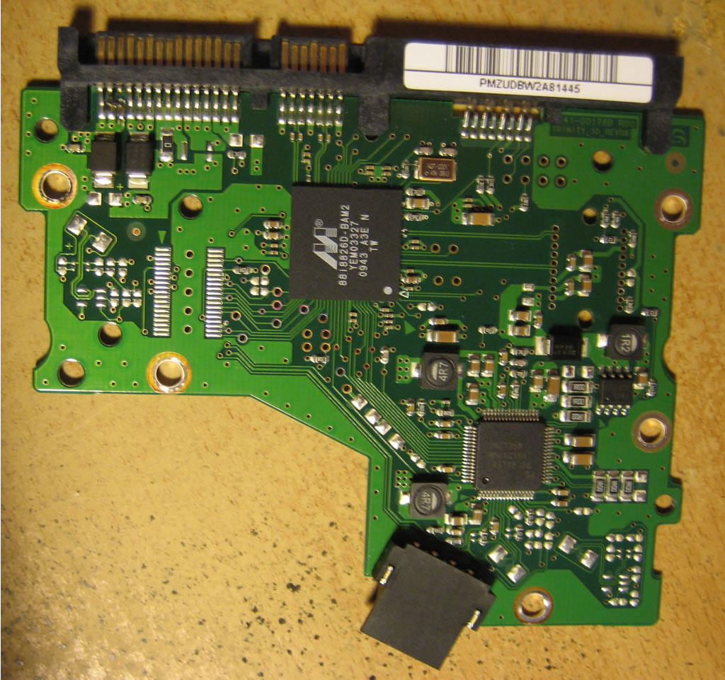

I have a faulty samsung drive, and i think that the PCB failed... the drive is not spinning, not taking any power at all... tried to put it to an external USB adapter, the adapter's led stopped responding... tried to put only the power cable on a PC, the PCB had that lovely smell of a burning capacitor... so i guess it must be the PCB. So, i'm trying to find from ebay a new PCB, but i need to know if i need to swap the ROM chip as well... I don't have any experience with heat guns etc, so i pray it's just a simple PCB swap task...
My hard disk:
Samsung
Model: HD502HI (500GB/R54/16M)
HDD P/N: HD502HI - Rev.A
P/N: 49082-A421-A0Z4R
S/N: S1VZJ90SC28113
Numbers on the PCB:
PCB Version: BF41-00178B
PCB Family: R00 Trinity_1D_REV08
Firmware: 0
Rev A
You will also find a picture of the PCB attached, just in case it helps
Thanks in advance for your time.
File comment: Samsung HD502HI PCB, PCB Version: BF41-00178B, PCB Family: R00 Trinity_1D_REV08
 Post subject: Re: Samsung HD502HI PCB swap
PostPosted: July 4th, 2013, 14:08
The damage can be seen near the power connector.
Check the 2x TVS diodes and the fuse.
It may well be repairable to save you the hassle of getting a replacement PCB which probably won't work anyway, due to firmware incompatibility.

Well, it's not only that, for sure. When PCB failed, the 2x TVS diodes and the fuse were OK... That visible damage happened after a few attempts... but anyway, i wanna try with a new PCB just to be sure.
According to this (http://www.donordrives.com/pcb-replacement-guide), a simple PCB swap might do the trick (numbers imprinted on the ROM chip do not start from 25).... However, if i need to change the ROM chip, swapping this too won't work?

Your board's "ROM" is embedded within the Marvell MCU. I don't know whether you would need to transfer the ROM code, but if you are considering sending your drive away, then you might like to read these threads:
http://www.tomshardware.com/forum/29438 ... ment-again
viewtopic.php?f=1&t=25524&p=173689
viewtopic.php?f=1&t=26205&p=178603
BTW, the 12V TVS diode in your photo is probably shorted (as you are probably aware).
The 8-pin chip is not a flash memory. It is associated with the -5V supply for the preamp.
See http://www.users.on.net/~fzabkar/HDD/HD ... _Regs.html

Maybe I misunderstood the OP, but I'm thinking that the OP's drive failed with a symptom that suggested a dead PCB. He then checked the TVS diodes and fuses and found them to be OK. Then he made a few more attempts, both in an external enclosure and in his PC, and it was only then that the PCB became visibly damaged. My thinking is that maybe the enclosure's PSU introduced a new fault, and the OP may have chosen to give up there and then, without rechecking the diodes.
That's exactly what happened. The drive was an external drive when it failed. Symptoms: no power led on the enclosure, no spinning to the drive, no sound at all, like there is nothing powering up the drive. I opened the enclosure, tried to use it as an internal drive. PC would not even powerup. The tried to use another enclosure, again, no power with this drive was in use. When the enclosure was empty (no drive at all), the power led was on. When this hard disk was used, led went off.
I then inspected the PCB, there was no visible damage on it, no smell, no burnt areas, nothing. But all the symptoms suggested a dead PCB. I tried to check the drive again one more time, with an external enclosure, and that's when the damage shown in the pictures was done (most probably because of a faulty enclosure PSU, which i don't care). At that point, i thought that i don't really care fixing that damage, since the PCB should be replaced anyway, so i just gave up trying.
I am pretty sure that the physical drive is not damaged, so i thought that it must be a PCB related problem. Since the PCB is dead, replacing it seems the only option.
I just hope i won't need to swap rom chips as well... i hope that a simple PCB swap will fix it.

PostPosted: July 5th, 2013, 6:36
Posts: 17393
That usually means that the drive was shorting the PC's PSU. ISTM that their must be a short on the drive's 12V input.
So you never actually tested the TVS diodes and "fuse"? Well, that's explains a lot.
Could you please indulge us by testing the 12V TVS diode? Alternatively, since you don't care about your data, just remove this diode and try the drive again.
