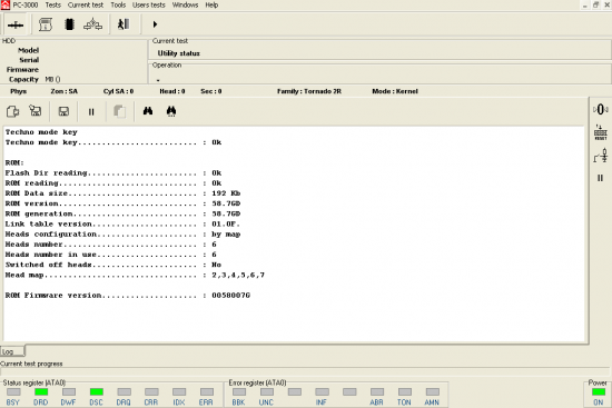

The disk clicks three times during power on, comes ready and then spins down
Please find the attached screenshot.
Is this heads damage?

90% heads
10% PCB

Have you tried to edit head map in ram or rom?
