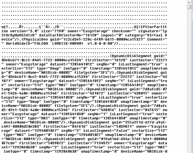

we have NAS. There is something special like LVM, but it's managed by Falconstor IPSTOR
software
here is preview of the beginning of the drive.
Can somebody give advice what to do with it ?
see the attachment
 Post subject: Re: Falconstor IPSTOR NAS
PostPosted: July 18th, 2013, 10:18
Posts: 2984
For Falconstor, the partition starts approx 384 sectors after start so even when built right (and built with LVM) partition is not directly accessible.
You have built the RAID correctly? What do you use for building it so far?
