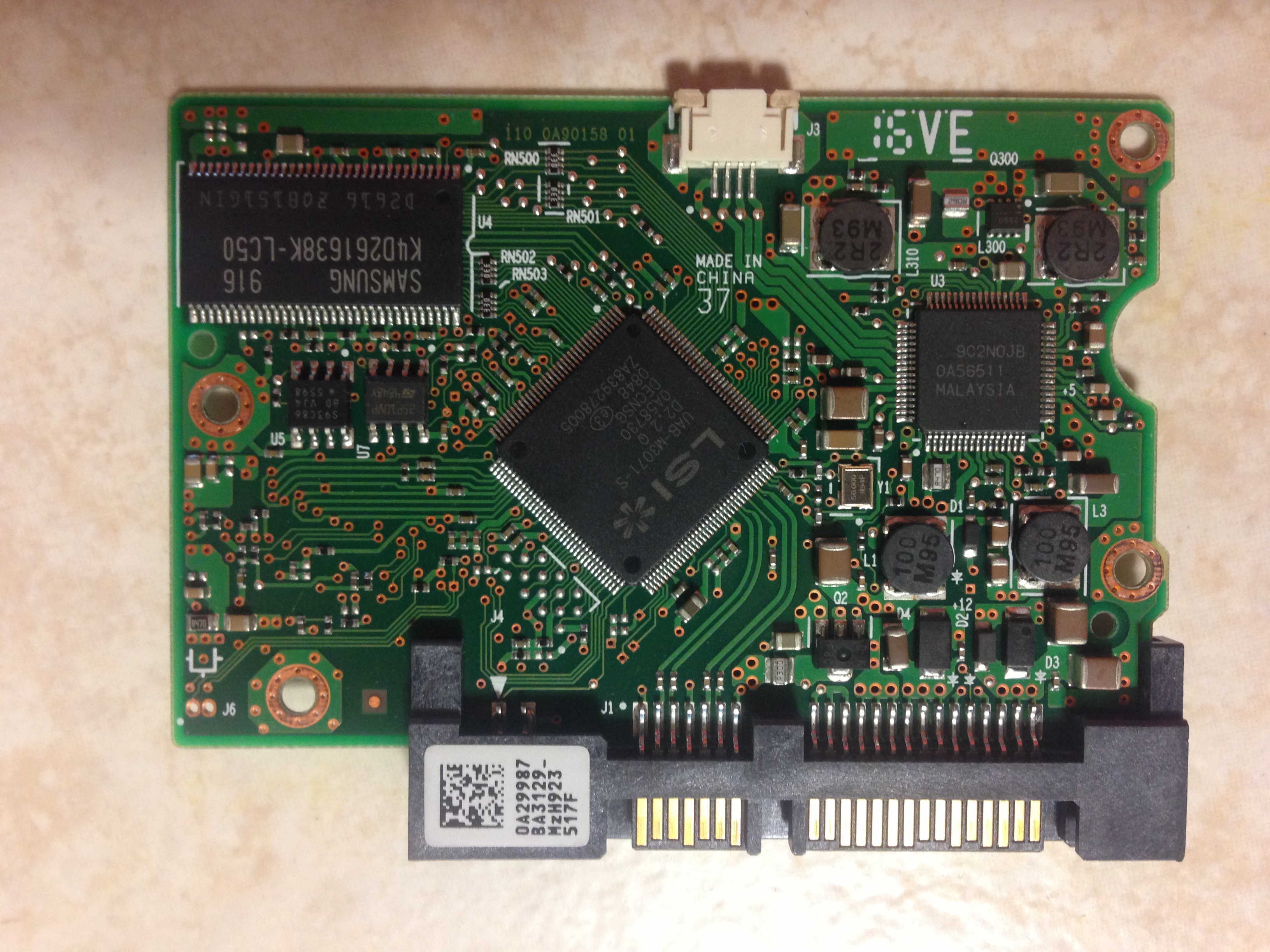

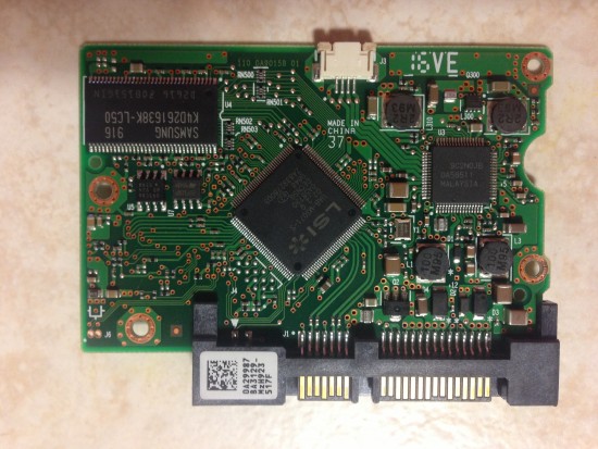

I switched my pcb on my harddrive with a new pcb and i need to swap my nv-ram for my HD to run properly. But im a little puzzled on which one is it, or do i need to switch both of the chips?

NVRAM=S93C86

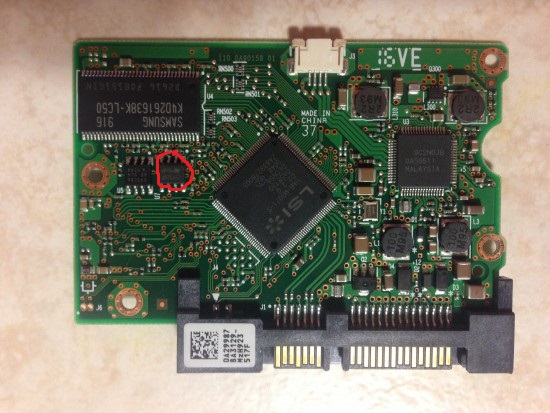

plz swap this u drive is work now perfectly

so im confused should i switch the two 8 pronged chips or just one of them? Hardrecover circled the opposite one of what moltke said was the nv-ram? thank you for your posts.

Moltke is correct. That said, "NVRAM" is an unfortunate misnomer that could easily be applied to either chip as both are "non-volatile". It can't hurt to do what Spildit suggests, although I'd transfer the S93C86 first.

Swap both of them, but make sure you are not rotating the chips.
