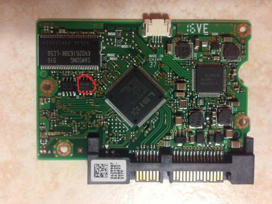

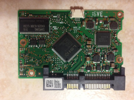

I switched my pcb on my harddrive with a new pcb and i need to swap my nv-ram for my HD to run properly. But im a little puzzled on which one is it, or do i need to switch both of the chips?

NVRAM=S93C86

plz swap this u drive is work now perfectly

so im confused should i switch the two 8 pronged chips or just one of them? Hardrecover circled the opposite one of what moltke said was the nv-ram? thank you for your posts.

Moltke is correct. That said, "NVRAM" is an unfortunate misnomer that could easily be applied to either chip as both are "non-volatile". It can't hurt to do what Spildit suggests, although I'd transfer the S93C86 first.
BTW, what is the problem with the patient PCB?

Swap both of them, but make sure you are not rotating the chips.
