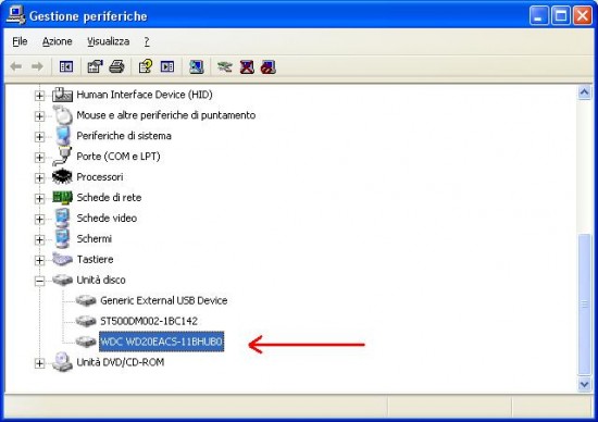

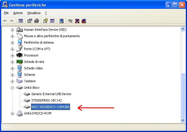

Hello, i've this My Book Essential which wasn't detect anymore in windows (no spinning).
I opened the case and pull out the drive, drive is WD20EACS-11BHUB0.
I found burned 12V TVS diode on the pcb which i substituted with a new one, now pcb works and the drive spins.
No clicking sound (but good calibration sound) and the drive is detect in bios, but not in windows, mhdd detects it but on surface scan i get all !!
I can see the drive only in Device Manager
In WDR i checked all SA mods and rom, all good exept mod 6F (which is normal to be bad on this drive).
Is this issue due to Essential encryption?
I inserted the drive into his My Book case again but still can't be detect (but it spins), i don't understand...
What should i do?

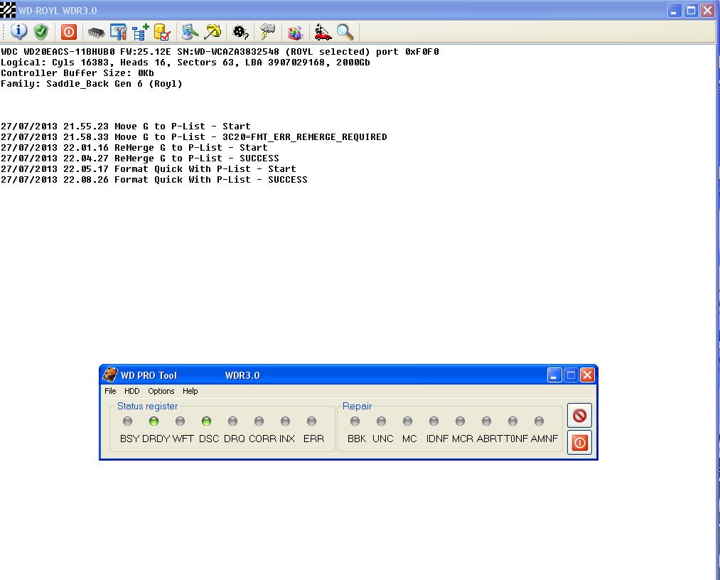

 Post subject: Re: WD My Book Essential with drive WD20EACS-11BHUB0 encrypt
PostPosted: July 27th, 2013, 16:24
Online
Posts: 1768
Location: Verona, Italy

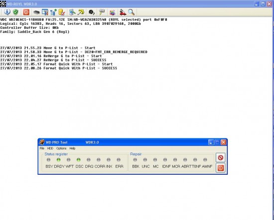

I did move G to P but with error 3C20=FMT_ERR_REMERGE_REQUIRED
Then i did quick translator on P list but drive is still not detect in windows and in mhdd i see only !! quickly scrolling on surface scan.
So i reloaded the G-list defects from INI file backup, then i did again move G to P, i got the same error but this time i also did REMERGE G to P, and after i did quick translator on P-list
Drive is still the same.
Should i give up?

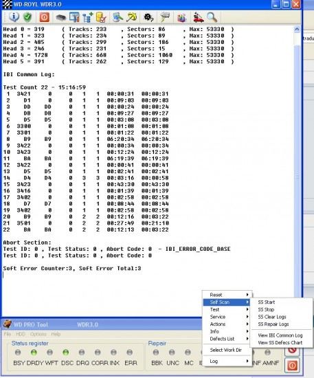

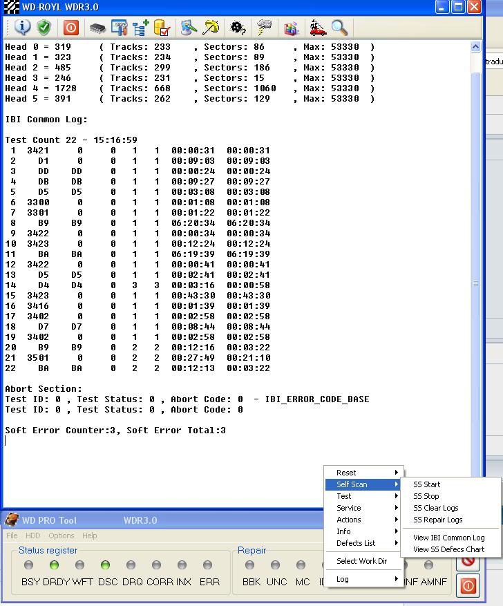

PostPosted: July 27th, 2013, 17:29
Online
Posts: 1768
What option should i select to re-create P list from SS logs?

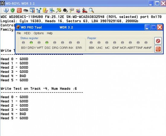

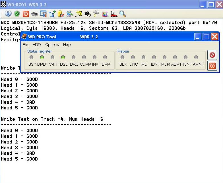

PostPosted: July 28th, 2013, 8:20
My money is on a bad head.
Does WDR allow head map edit in RAM?
PostPosted: July 28th, 2013, 10:16
Online
Posts: 1768
pcimage you are right, head 4 it's bad.
Stupid me, i had to try before this test.
Ok, now i should depop that head on ram and try to recover data with file carving software?
P.S.
:evil:
Grrrr, i forgot this is an encrypted drive, what can i do?
