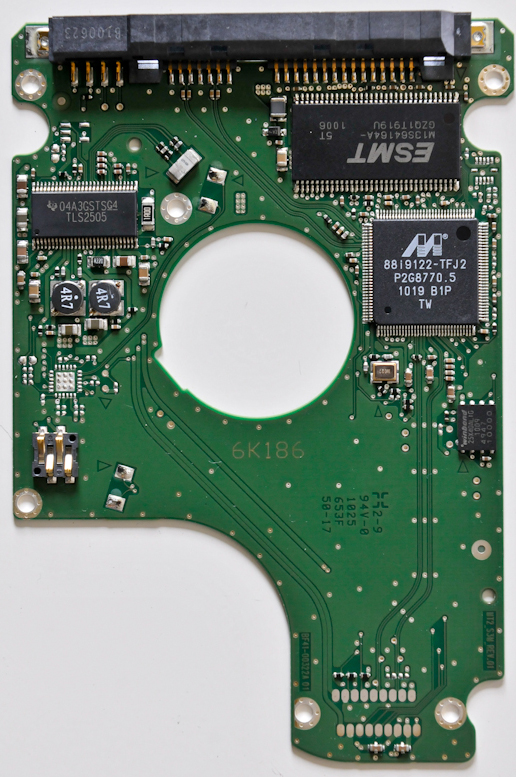

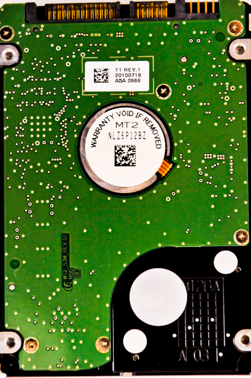

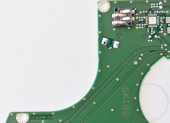

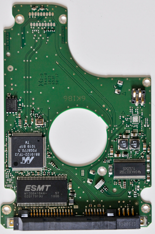

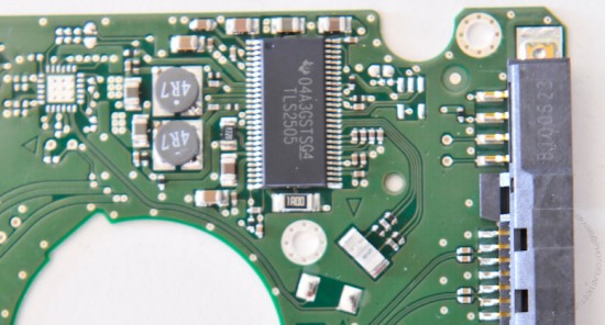

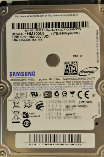

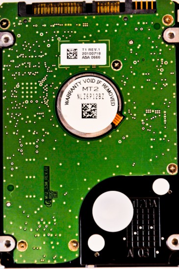

I think a power surge blew my PCB. I have video on the drive and would like to get it, but the price of recovery makes me shift towards DYI rescue. I happen to have another Samsung 1TB different release date. Switched the PCB, powered up the drive and in was spinning without strange noises or smoke. Computer did not recognize the drive, tried it on a Mac and a Vista 64x, firewire 800, eSata and USB and nada. So probably the wrong PCB firmware and maybe more. The question, if I go hunting around for the same drive, what numbers am I trying to match? Here are the front and back of the drive that is broken. Searched all over the web and still could not figure it out.
Thanks for any help.

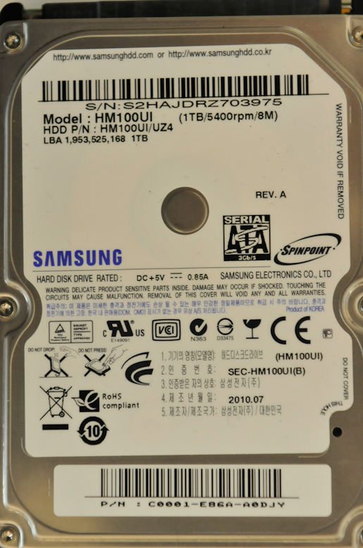

SAMSUNG SpinPoint MT2 HM100UI 1TB 5400 RPM

upload another photo for the pcb from the other side
does it spin with its original pcb? sounds normal or totally dead?

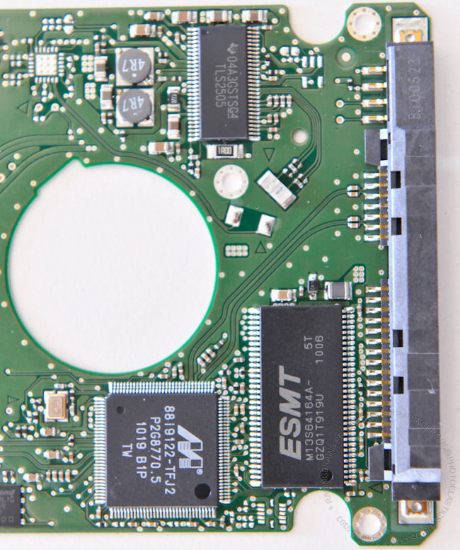

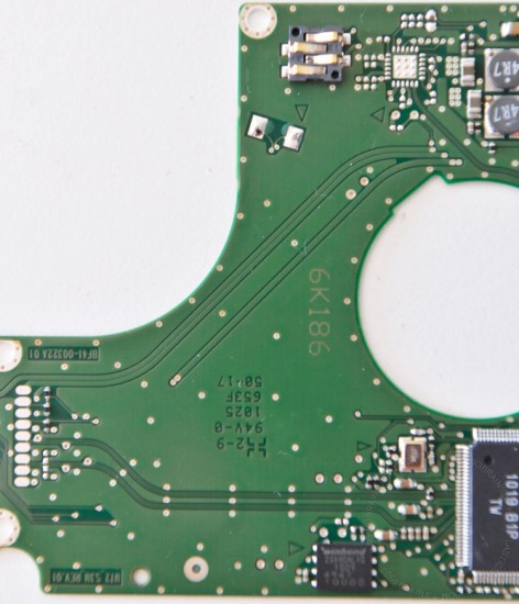

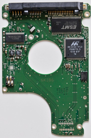

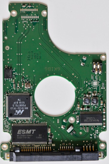

As requested the PCB. Totally dead with the original PCB no sound, no vibration just sadly silent. Spins with the other PCB from my newer drive and no strange clicking etc.
Put a photo of the same PCB in twice so it was easier to read the codes.
File comment: Broken PCB view 2
File comment: Broken PCB view 1

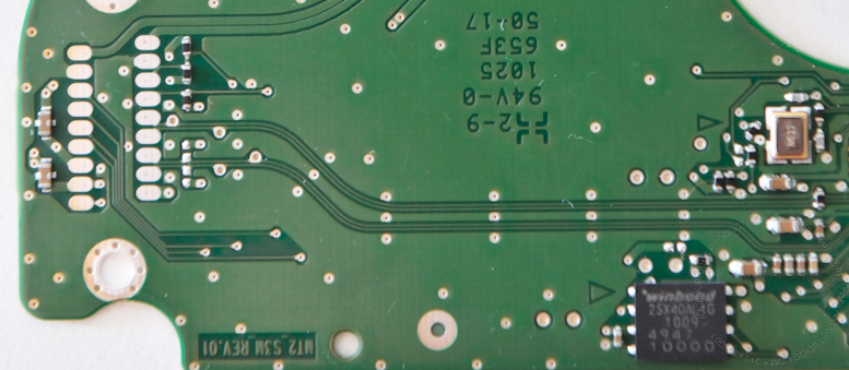

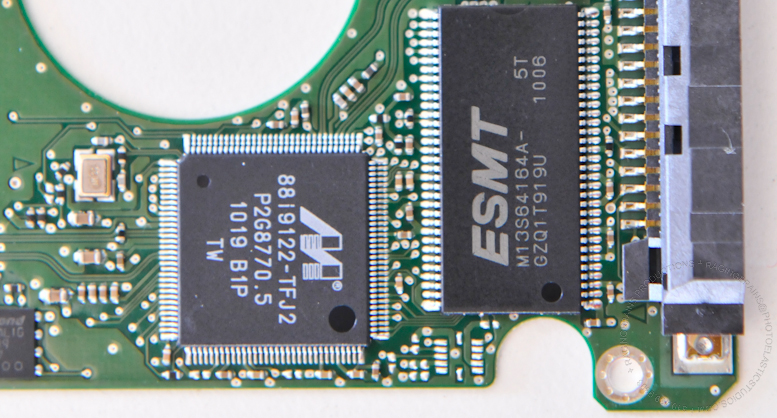

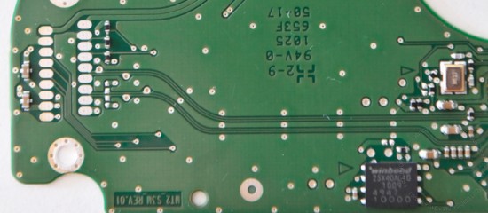

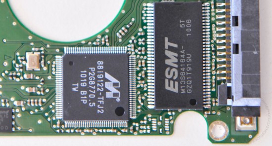

You need to transfer the 8-pin serial flash memory chip, or its contents, from patient to donor. This chip stores unique, drive specific information. It is located below the Marvell MCU (big "M") in your first photo, and has a "25" in its part number. Your local TV/AV repair shop should be able to do this for you.

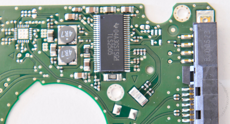

However, before going ahead with the swap, can you zoom up on the area around the ESMT SDRAM chip, especially the left and top sides? There may be some protection devices, such as fuses or diodes.

Not to mention the chip looks like a BGA, which should be taken into consideration.

Just FYI, since we can see pads (along 2 edges) and for that specific component, it'll be a WSON package (one of the QFN family of packages). Agreed that this needs to be considered, especially if Samsung chose to solder the bottom pad to the PCB.

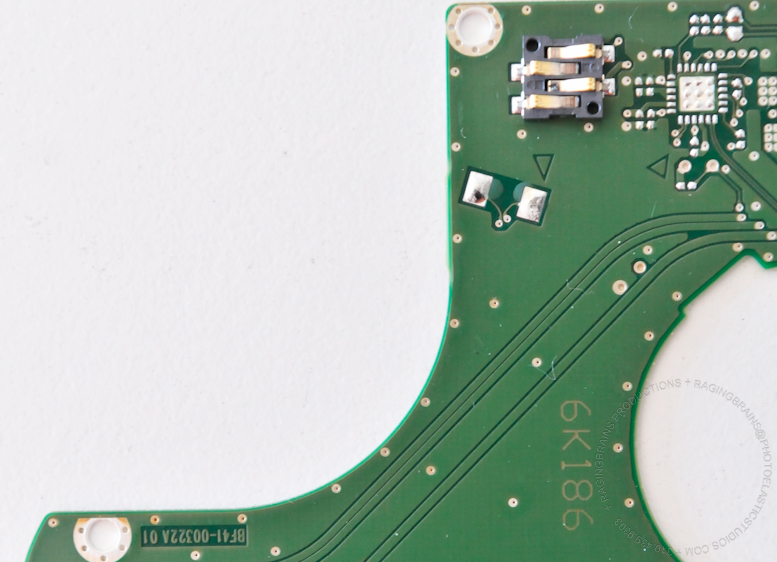

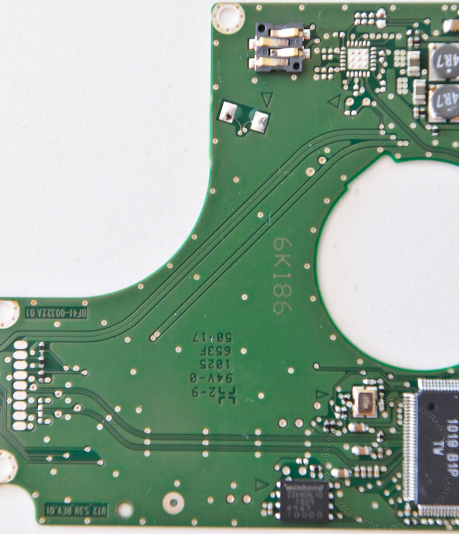

Not sure what edges you meant so I just took some up close shots. Hope that helps unravel the solution.

in your second image there, you have just that one component, you can see that there are 4 pins on either side, the chip says
winboard
25k40...(cant make that out but its the PN)
1009
4947
10000
Thats the guy he's referring to, it may have a pad on the bottom of it as well (IIRC it would be a grounding pad). you'll notice too that the arms wrap up under the component and there are some caps and resistors right next to the arms. this is definitely not a DIY, and most pros wouldnt want to do it either, unless they could do a partial reflow of the board. i hate to sound like a pessimist but assuming that component is moved successfully it may well be fried too.

The thread starter was only asking how to identify the PCB maybe to buy a new one (?). The answer is
MT2 S3M Rev.01 R00
= an identical PCB from identical drive. BUT don't expect a straight swap to work.

Can you read the number on the flash chip?
Is it 25X40AL<space>IG ?

The Winbond chip is the W25X40BLIG with this pin lay-out:
http://www.dz863.com/pinout-82887663-W25X10BL/
So looks like it`s not a BGA package... THANK GOD!

But the good news is that the board-swap works directly without any soldering required...now it´s time to find out if that solves the issues or if it needs to be fixed from the inside...any pros here from Bangalore who can do an inside-job. Have an identical drive for head replacement etc...
