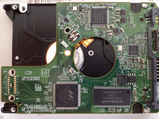

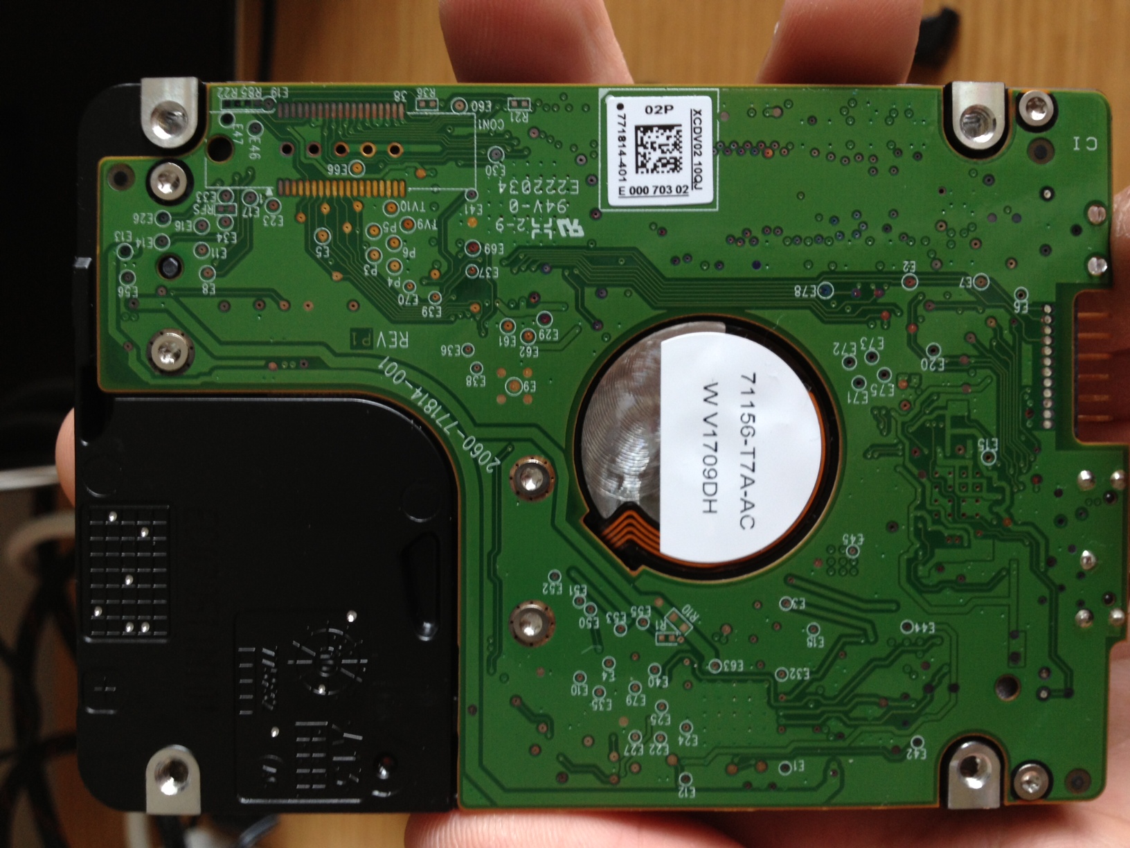

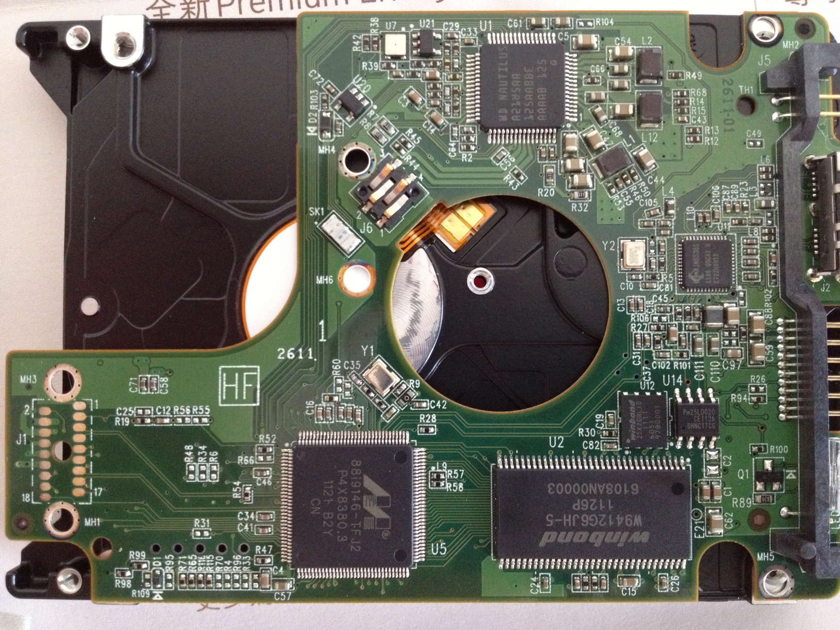

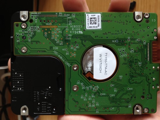

Hi
My WD 1.0TB Passport Essential SE does not show up in my computer.
It was working fine one day while transferring 80GB of files from it to a 3TB drive, but the drive disconnected somewhere halfway during the transfer, and now won't work anymore.
It shows up in Device manager as "Western Digital 0740" and listed in
My computer as D: drive, but it does not access the drive when I open
it.
Disk management shows up as 0kb capacity, not initialized. I cannot
initialize it because of an I/O error.
The drive makes a faint spinning sound, so I presume it is spinning.
WD10TMVW-11ZSMS5 (USB interface, no SATA).
Model: WDBACX0010BBK-PESN
Should I order this PCB from hdd-parts and ask them to transfer the BIOS for me, assuming the PCB is at fault?
http://www.hdd-parts.com/12103612.html
How many chips on the PCB need to be swapped? I've heard of U12 / U14 chips?
Could I just take it to an electronics shop? As I live in Hong Kong, I could buy the PCB locally, but I wouldn't know which chips to tell them to swap for me?
And finally: Is the data encrypted? Would replacing the PCB with a donor BIOS swap work and allow me access to my data?
I've heard some people say WD drives are encrypted.

99% NOT a PCB problem

Is it still even worth a try? It's only $50 for a PCB vs. $500 for data recovery.
The problem is I don't even know what documents /files were on the drive, to decide if it's worth recovering.
Why do you say it's 99% not a PCB problem? I've heard that sometimes with a faulty PCB, the drive still spins but recognises as 0kb capacity.
It now doesn't even show up in disk management.
Over the past 1 year, it would stop working (same problem) then randomly start working again.

islamm3rouf wrote:
its Busy problem
common fault
Hi friend,
Please explain what is "busy problem"?
How can I fix it?

The drive is detected in WD Lifeguard Tools at the correct capacity,
and has green ticks for all the SMART tests.
Does this mean the PCB is just faulty and the drive is fine?
It is busy running the "Quick Media Scan test"
 Post subject: Re: 2060-771814-001 WD10TMVW - PCB replacement
PostPosted: July 29th, 2013, 5:47
Posts: 2984
At a reserved area of the surface is a set of firmware modules, each has a specific set of instructions that the HDD depends on for functionality. When one or more of these modules become erroneous for any reason, functionality of the HDD is affected. In this case, issue seems to be common in this series and relates generally to the relocation defects list. As this information is stored on the media surface, PCB change will not help, if anything it will make it worse. You need specialist recovery equipment to gain access to the surface, and you need at least some level of understanding of the service area and how it works to rectify the problem.
As you dont have the specific knowledge or equipment needed, this is something you can not resolve yourself.
