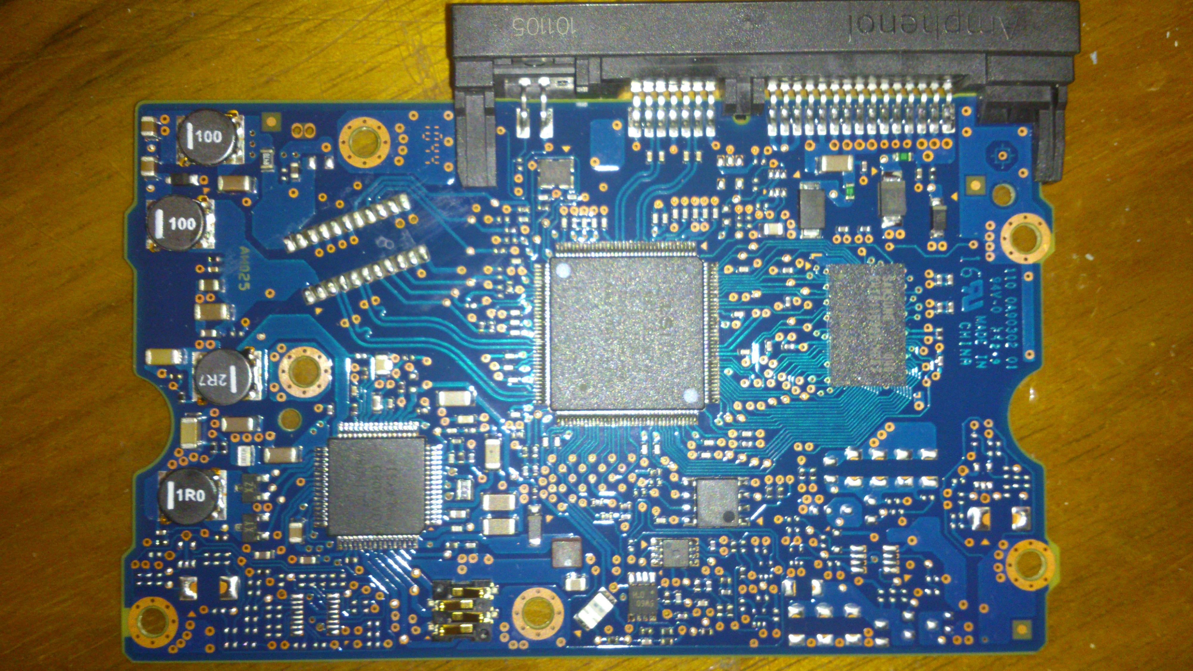

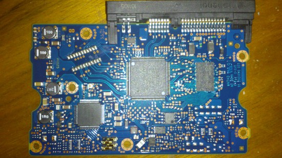

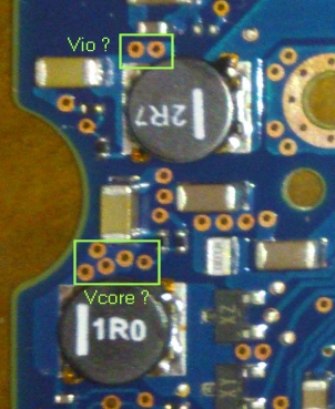

Hello, i've this Hitachi HDS723020BLA642 which isn't detect anymore since a power surge.
PCB seems to be ok, i don't see any burned component and any shorted diode with multimiter check.
PCB: 110 0A90302 01
MCU: 0J11389
Motor Chip: 0A73080
Drive spins, sometimes does 5 clicking sounds cand spins down, sometimes 1 clicking and spins down and sometimes 4 clicking with NO SPIN DOWN.
When heads do clicking sounds is because motor loses rotation speed half second before!!
Can you help me to identify the problem?
Is this a head, motor or pcb issue?
Does someone know what tension value to check on pcb?

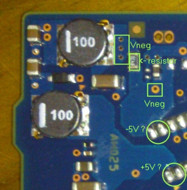

It doesn't sound like a PCB issue but here are the test points AISI.

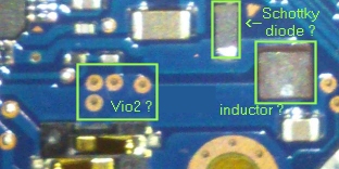

I think there may be a second Vio rail. Let's call it Vio2.

Therefore one of the Vio supplies must be providing +1.8V for the SDRAM. The other Vio supply must be powering the NVRAM, possibly +2.5V or +3.3V.

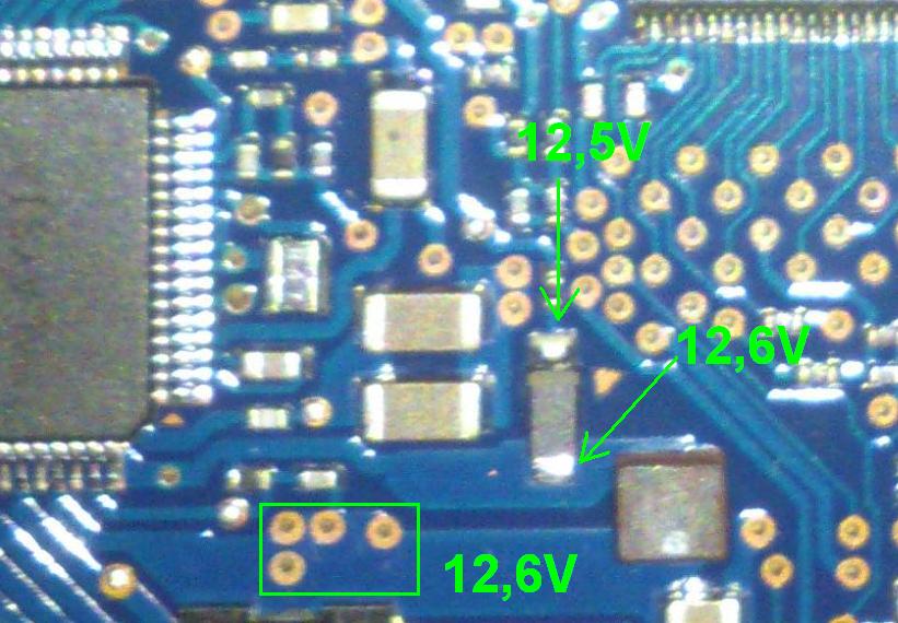

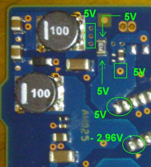

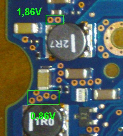

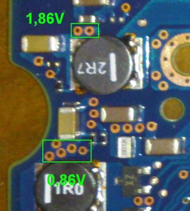

This are the value i detect with voltmeter
My firmware database:
 Post subject: Re: Hitachi HDS723020BLA642 always different sounds - diagno
PostPosted: August 10th, 2013, 19:46
Posts: 17323
I got the two 100R coils in the Cuk converter the wrong way round, but -3V seems reasonable for the Vneg supply.
+1.86V seems about right for the SDRAM. I expect that the Vio2 supply would be +2.5V or +3.3V.
Vcore seems low, but you would need to compare it against a working PCB. It's most likely OK. In any case, if it were low, I would think that the motor controller wouldn't release the POR signal, in which case the PCB would be brain-dead.

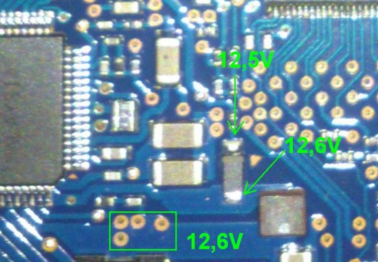

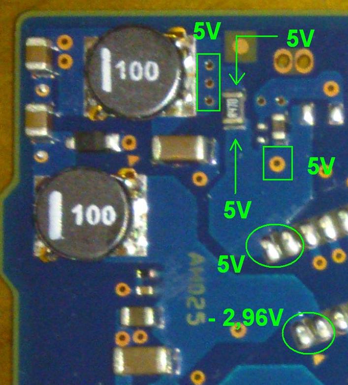

MCU an motor chip get pretty hot without pcb connected to the hdd, is it normal?

It appears that I was wrong about Vio2. I don't know what to make of that section of the circuit, unless it's some kind of charge pump for the motor and VCM MOSFET drivers.

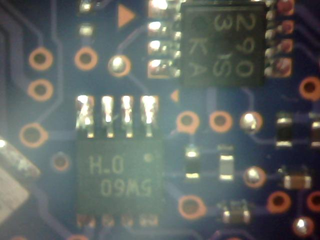

Can you tell us the markings on the other two 8-pin ICs near the "5W60" chip?
As for the motor controller and MCU getting hot, I wouldn't think this would be normal.

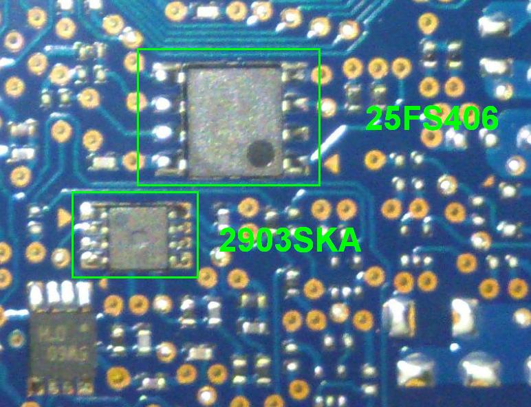

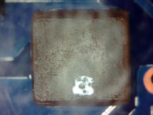

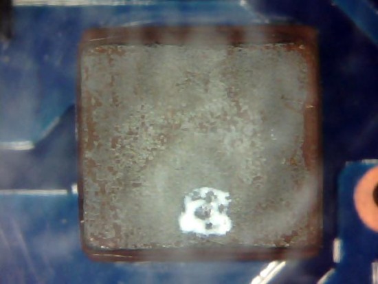

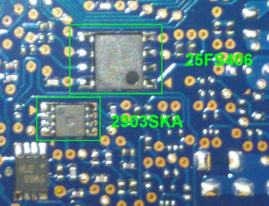

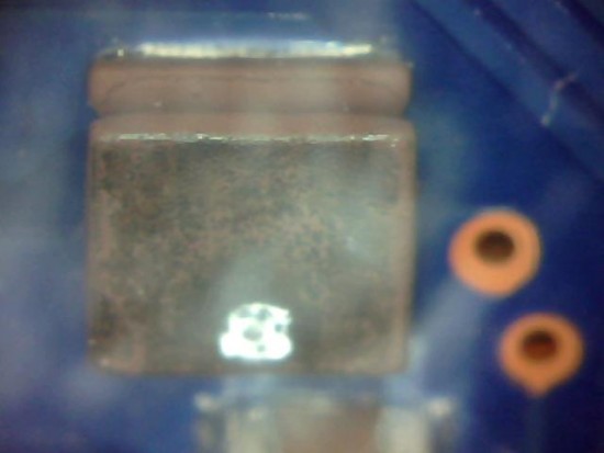

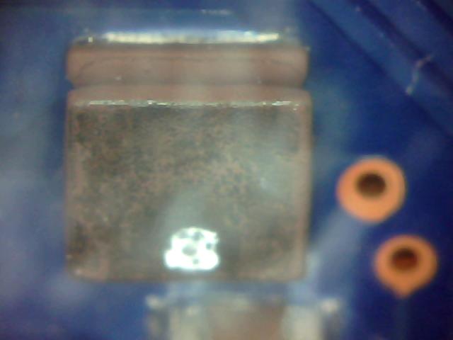

Microscope screenshots
it seems that the inductor is burned, what do you think?

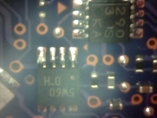

What do you think?
PostPosted: August 10th, 2013, 20:37
Posts: 17323
The flash memory is a 1.8V part.
LE25FS406, Sanyo, 1.65V - 2.1V, SPI flash memory:
http://panasonic.co.jp/sanyo/news/2010/02/16-3.pdf
The other chip appears to be an analog part, possibly a low power, rail-to-rail variant of the LM2903 dual comparator.
If I'm right about the charge pump, then AIUI the boost voltage should be around 18V. However, it could be that the motor controller may not generate this voltage unless commanded to do so by the MCU, and the MCU may not be commanding it to do so if it thinks that something is wrong, eg if the preamp is not being detected.
But that's just wild speculation. You would need to compare your readings against a working drive. Otherwise look for the four "12.6V" test points on the other side of the PCB and measure the charge pump boost voltage (Vcp) while the drive is spinning.
PostPosted: August 10th, 2013, 20:42
Posts: 17323
It's hard to tell. If it has shorted turns, then that could explain the heating and the absence of the boost voltage. However, a multimeter resistance test won't help. You would need to test it with an inductance (LC) meter.
Your photos show the ferrite core, however you should be examining the wire turns for any evidence of blistering in the insulation.
BTW, if you're concerned about the white spot, I believe it is just a manufacturing mark.

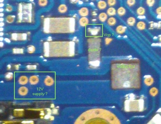

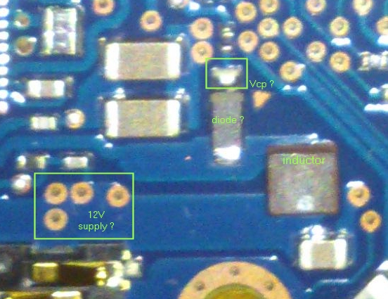

BTW, I have re-examined the Vcp supply and I think it may work like this:

PostPosted: August 10th, 2013, 22:44
Posts: 17323
+12V O--- )()()( ---+---|>|----+---O Vcp (+18V ?)
           coil     |  diode   |
                    |         _|_
                 ||-+         ___ capacitor
                 ||<- MOSFET   |
   PWM pulses ---||-+          |
GND  O--------------+----------+---O Ground
The MOSFET would be internal to the motor controller.
