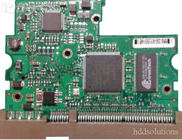

Please help me confirm the location of the TVS diode on my ST340015ACE. It contains valuable data that I need to back up. Any help would be greatly appreciated. Thank You, in advance! I have included a photo.
File comment: Seagate ST340015ACE Board
st340015ace-firmware-3-01-seagate-pcb-controller-board-c0c1.jpg [ 70.42 KiB | Viewed 10480 times ]

Hi I will help you - to help yourself.
1. the picture is not good enough quality to read the markings on any component.
2. The TVS diode is normally one of the largest black components that is not an IC. They are normally near the IDE or SATA connector.
what you need to do is start plugging in the numbers on the components into Google that are candidates based on what I just said.
or, google images:
tvs diode Seagate hdd ide

Thank You very much for your help! Sorry about the duplicate posts, I am new to the forum and I wasn't sure if this post would be rejected for having a link. So, I saved the image as a. Jpg and it posted without requiring approval. Btw, the markings are 611 15A. On the larger diode and AE 0611 on the smaller. [*]

SMAJ5.0A, AE marking, 5V TVS diode, ST Microelectronics:
http://www.st.com/stonline/products/lit ... 4/smaj.pdf
http://www.users.on.net/~fzabkar/HDD/TVS_diodes.txt

P6SMB15AT3, ON Semiconductor, TVS diode, marking 15A, 15V breakdown voltage, 600W:
http://www.onsemi.com/pub_link/Collater ... 8AT3-D.PDF
http://ae6pm.com/Semidata_books/Motorola/DL150-D.pdf
