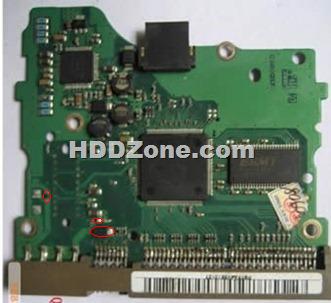

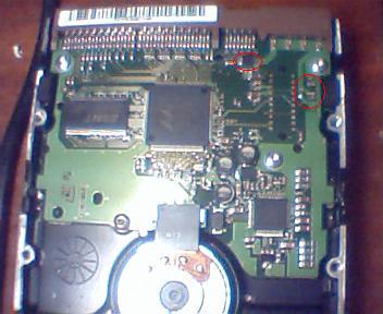

I am sending a photo of PCBs the components that were marked with the problem was Diodo Open and exchanged fuseresistor open the hdd back to work again thank you all for your help, so do more each day the forum grow

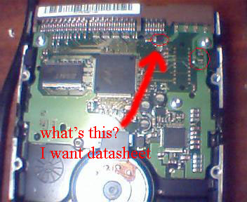

I want datasheet. pls

A part number for a similar (Perhaps even the exact part) has been posted here already. With the part number, a datasheet is only a Google away. Or, you can read the numbers off the part you have, and search for a datasheet.
If you just want to know what it is, what it does, and how to test it, that's already been mentioned here as well.

I see a part number AE GP403.but I don't sure.
I search for a datasheet in http://www.alldatasheet.com. It not have.

I've got bad news, and good news for you....
I'm too lazy to find you a datasheet for the part.
If it's a TVS, You don't need a datasheet. I'm going to repeat that... You don't need a datasheet. If by chance you're designing a circuit with a TVS, you wouldn't be asking for help. If you're trying to diagnose or repair a dead drive, YOU DON'T NEED A DATASHEET.
Oh, by the way, you really don't need a datasheet. You only need to know how it functions, and how to test it. It's already been mentioned before. That horse has long ago been beaten to death. If you still have questions, I'll do my best.
Also, in case I forgot to mention it, you don't need a datasheet.

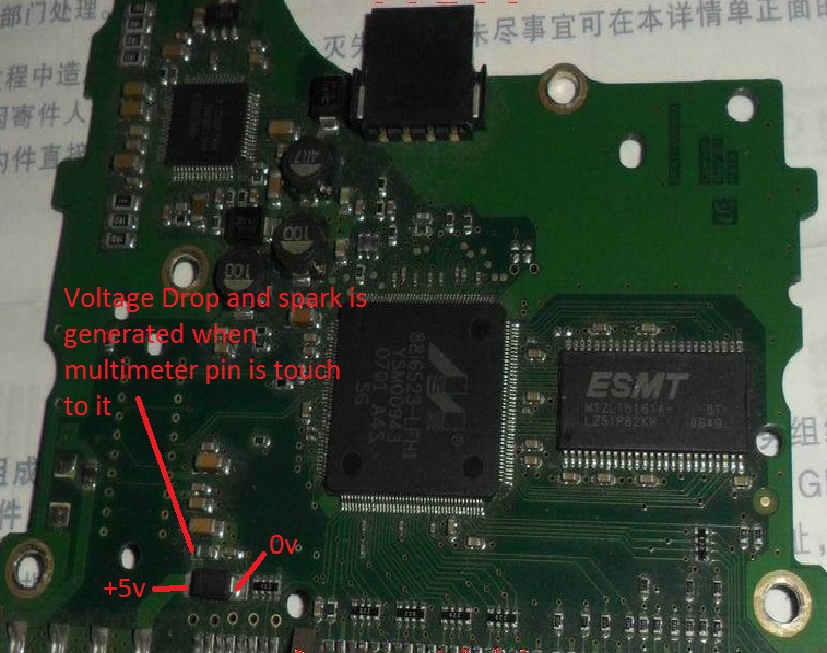

Guys help me out,
my same HDD (sp0842n) is not powering. . :(
is this is the same issue(may be)
does that worked for any body . . .
pls reply. .
thanks
 Post subject: Re: SANSUNG SP0842N STOP
PostPosted: August 23rd, 2013, 3:17
Joined: August 22nd, 2013, 4:19
Posts: 5
Location: Mumbai
desoldering the diode and the capacitor is not helping . . .
the HDD is still dead. . .
no spining in the harddrive . . ..
here is the img with the mark on the component i removed. . .
one diode and two capacitor. . .
pls help me out. . .

Did you measure anything before removing the components?
Can you provide a photo of your own?
PostPosted: August 23rd, 2013, 4:20
@Djisd
Before you waste your time with measurements : if all the power problems on PCB are ruled out (?), you have problems in the MCU or around it. Dead MCU = have to find out something that work for your drive OR make it work, but it's not DIY.
IF the PCB is the same of the picture there's nothing else to do UNLESS you are able to repair it (but I don't think so).
P.S. depending on what happened, if the damage went beyond the PCB, the drive will click furiously at startup : add a dead hedstack and other problems, then.
Good luck.

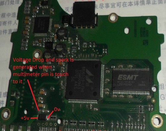

@fzabkar :
i do measure voltage across the TVS and capacitor with multimeter. . .\
(since i dont have high resolution camera)
@BlackST
thats what i thught
since there is no spining in the harddrive there must be something with the power. . .
bt if MCU is dead there is nothing i can do . .
can i buy the same PCB board from internet and try my luck . . .

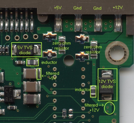

Here is a photo of a similar PCB:
AFAICT, there should be unfiltered +5V on one side of the inductor, and filtered +5V on the other side. If the inductor is open or high resistance, then you can simply flow a blob of solder over it. However, if you choose to do this, let's see a close-up photo of that area.
