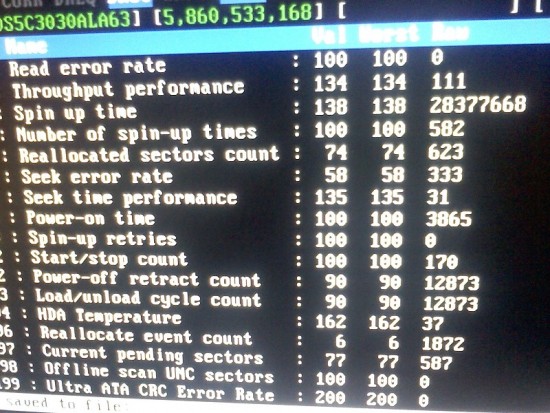

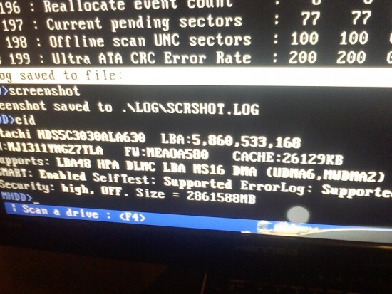

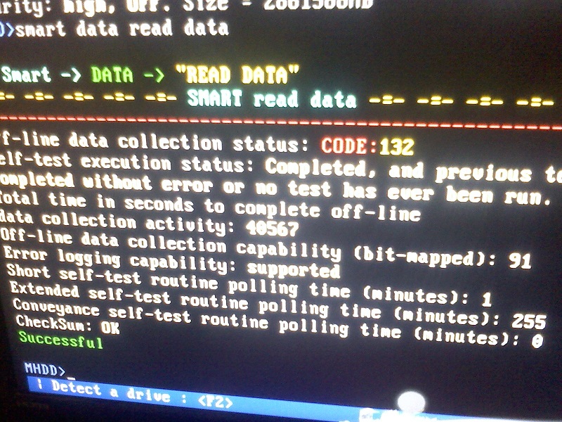

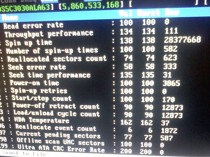

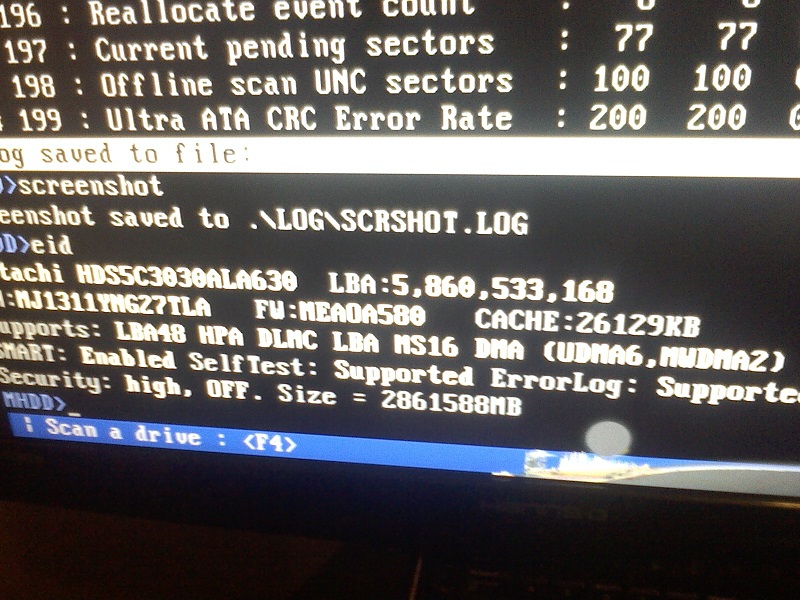

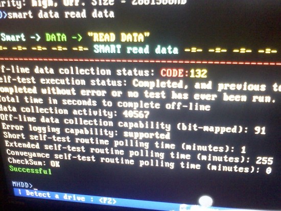

I went ahead and tried MHDD, I wasn't exactly sure what I would accomplish in there but I've got what information what I could. I also tried running a scan utilizing MHDD, now it did scan through all the sectors (after skipping through multiple hiccups).
When the drive started scanning, it would run, majority of the sectors seemed to be reading fine with the majority under <3MS and then almost like clockwork there would be these "hiccups" where I could actually hear when the drive "hiccup" / click and then the reading abruptly stops. I would have to skip through 10k sectors to get past the hiccup and the reading would continue, then almost like clockwork/a full oscillation, the reading hiccups again thus needing to skip. I would have to skip around 50+ times by the end of the scan for it to complete.
When connected by Sata, the bios pauses to catch up on reading the drive on start up, the drive is recognized by Windows but the drive itself is not accessible - stating - it's not a recognized file system.
I've attempted to use GDB but again, scanning would start and start to recognize file types however the drive would start to hiccup/halt the program and since there's no way to actively cause the program to do a hard skip, the program just seizes up.
If I attach the drive through USB - it correctly displays the 2 partitions of the drive which there should be but still it is not accessible. Is MHDD capable of doing a sector-sector copy or are there any programs out there that are fitting to do any kind of clone with a drive like this?
I've attached some pictures of what information I could get from MHDD.
If anyone has any input on this I'd really appreciate it.

Either the disk is developing a media problem, degraded head OR it has been kicked HARD (my bet is on 3rd)
The risk is that it will die during the DIY copy with free stuff (becomes unresponsive, if there is MD it will start clicking and it dies OR it "dies" anyway) but you'll never know until you try.
I would not recommend it but it's me. GOOD LUCK.

Sounds to me that the drive has a bad head.
