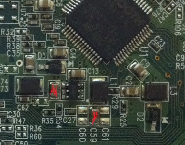

Could you show us what you are talking about?
I can not find that causes shorted, is the patient's pcb. shorted: c65, c45, c52, c49 and one that is marked in red in the photo.

In the case of the WD5000AAKX, you should be able to transfer U12 from patient to donor. If there is no other problem, and assuming the two boards are compatible, then that should be all you need to do.
If the board does not have a discrete flash memory at U12, then its contents will need to be reconstructed from backup modules in the System Area on the platters, assuming that these exist.
An additional complication may be damage to the preamp inside the HDA. Which of the following components were damaged?
http://www.users.on.net/~fzabkar/HDD/bi ... diodes.jpg
Is there a short circuit between the Vcc and Ground pins of U12?
What is the resistance between ground and each of the L1 and L2 inductors?

If I understand you correctly, the patient WD5000AAKX PCB did not have any damaged TVS diodes (D3 and D4) or open circuited resistors (R67 and R67). However you did find that various capacitors were shorted, namely several bypass capacitors around the Marvell MCU plus C59 (near L1) and another capacitor near D1/L2.
If this is your board ...
http://cdn.shopify.com/s/files/1/0207/3 ... x1024.jpeg
... then there appear to be 3 power supplies below the SMOOTH chip.
L3 and D2 constitute the negative supply for the preamp. It appears that C59 connects to the anode of D2. This is the Vneg (my terminology) test point, probably -5V. With the PCB off the drive, can you confirm the resistance between D2 and ground?
Can you confirm the resistance between pin #8 (Vcc) and pin #4 (ground) of U12, both on the PCB and on the chip? This will tell us if the Vio supply rail is shorted, or if the chip is shorted, or both.

If I understand you correctly, the patient WD5000AAKX PCB did not have any damaged TVS diodes (D3 and D4) or open circuited resistors (R67 and R67)....
If correct. In shorted c65, c45, c52, c49, c59 and another capacitor near D1/L2

If the 320GB patient PCB has a ROM at U12, and if there is no internal problem with the drive, then a PCB swap and ROM transfer should have solved your problem. The fact that the patient drive spins up with donor PCB and patient ROM suggests that your ROM transfer was successful. Therefore it appears that the drive has internal problems.
The short circuits that you measured on the 500GB patient PCB indicate that there is a shorted component on the Vcore supply, most probably a bad MCU. The ROM would be powered from the Vio supply which appears to be OK. Unfortunately the MCU on the patient PCB contains the embedded ROM code, so even transferring the MCU to a donor PCB would not work for you. In any case your donor is not a match, unless you reconfigure certain resistors to tell the MCU to look for an external ROM rather than internal. At least that's how I understand it.
BTW, it would have helped a lot if you had provided full photos, and if you had created separate threads for each drive.

That's interesting. I used to see a lot of short-circuit failures in disc ceramic capacitors, but I haven't seen too many in the MLCCs, although my colleagues in the electronics repair game are reporting numerous problems with them. Apparently these problems are the result of manufacturing stresses. Why don't you just remove the capacitors one at a time and hope that the short goes away? The board would probably function without the bypass capacitors at the MCU.

Compare the resistors and capacitors around the MCU. Some locations will be populated, while others will be vacant.

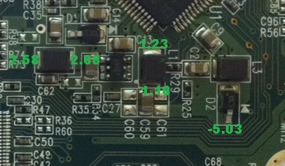

Yes, that would be interesting. I would start by taking the 500GB donor and measuring the voltages at L1 and L2, and the anode of D2.
That's what I'll try when I have some time.
500GB donor measuring the voltages at L1 and L2, and the anode of D2.

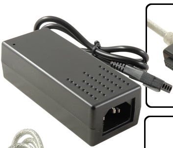

There is something I have noticed in the power supply that I use on hdd came with a converter ide/sata to usb. In this psu I measure AC current is this normal?

The +2.5V and +1.2V voltages are the Vio and Vcore supplies. The negative preamp supply is -5V.

Your AC measurements make no sense to me. Could we see the setup, and could you indicate the measurement points, including the ground reference?
My psu is similar to this.
The difference is that I changing the molex connector because the original could be connected with reversed polarity by accident.
Measurement made ​​without the pcb connected to psu molex cable end this only brings a ground wire.
I think this alternating current that comes out of this psu can interfere with the proper functioning of a HDD that is what I have noticed since using this source with my WD1600BEVS sometimes I have to connect several times to be recognized. When I use a standard psu desktop pc is almost always immediately recognized.
So this may be another cause of the 500gb HDD is not recognized. For this try with a atx psu soon to see if it works.

Those AC voltages would seriously damage a HDD. They cannot be correct.

I had this PSU few years ago, it blown up and did a lot of smoke.
