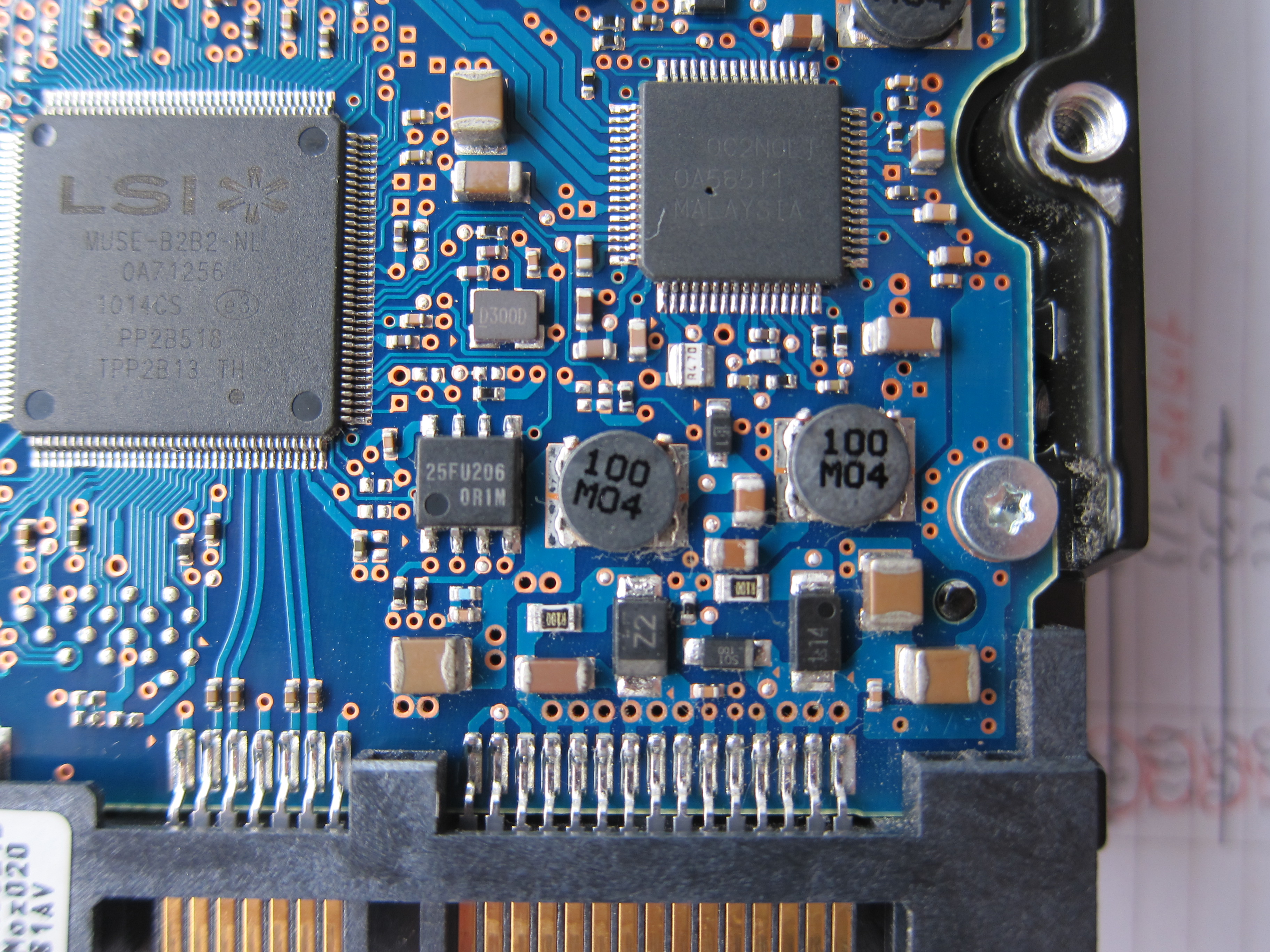

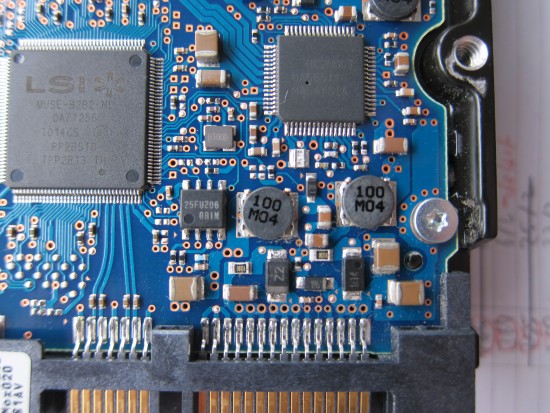

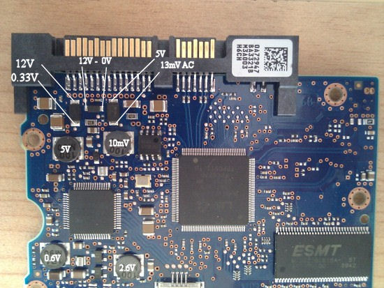

I have a totally dead Hitachi 1Tb HDS721010CLA332. It was working fine for a few year, no strange noises. Then the MB went bad and the HDD was out of service for 2 weeks or so. Now I wanted to get some data and the HDD is totally dead, no sound, no small, nothing.
I sto.... I mean borrowed a picture from another user here added the voltages that I measured with a cheap MM. One voltage I could only measure in AC mode. My oscilloscope is not on hand right now.
The three TVS seem ok, they are not shorted. Is there anything else I can try? Any idea what it may could be?

Please let me add a piece of new information: I checked the the two (current sense?) resistors marked R100 and their resistance is high (out of range). I wonder if that is normal. The seems to be connected to the TVS and part of the protection circuit.

The R100 resistors should be measuring 0.1 ohm.
The Vcore supply should be around +1.2V IIRC.
The Vneg supply should be -5V.
Could you post a link to the larger photo?

Where are the measure points for what voltage?
All voltages were measured against GND. The two R100 were measured with power off. I could replace them, but have no similar resistors on hand, I guess I could simply measure out a piece of wire and solder them in?
The picture I posted wasn't mine, but my board is exactly the same. I will take a better picture late.

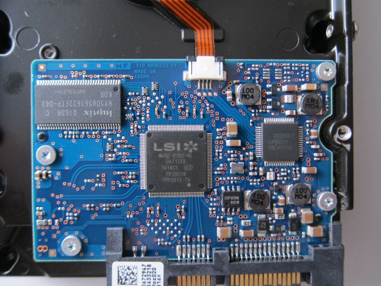

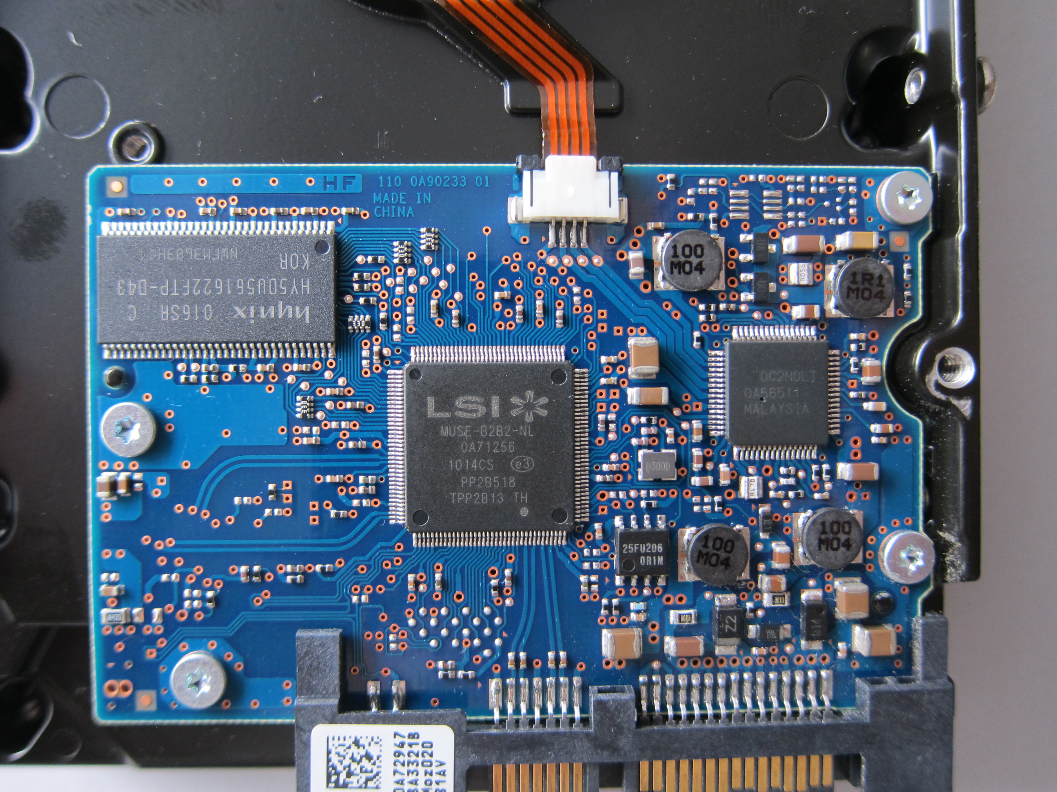

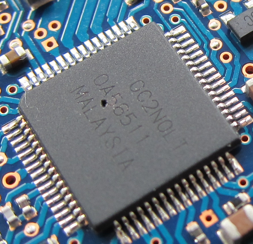

I added two pictures of MY board. I should disclose at this point that I work in circuit assembly and have a vague idea about circuits. I can not see any mechanical damage, or shorts.
I am not clear about the function of the R100, they seem to work together with the TVS - but the TVS have no function in normal operation and only work when there is overvoltate (same way that a a fuse has no actual function). A circuit diagram would be helpful at this point.
BTW, the HDD specific ROM seems to be connected the HDD drive and not on the PCB. So it should be quite possible to simply swap the PCB, or not?

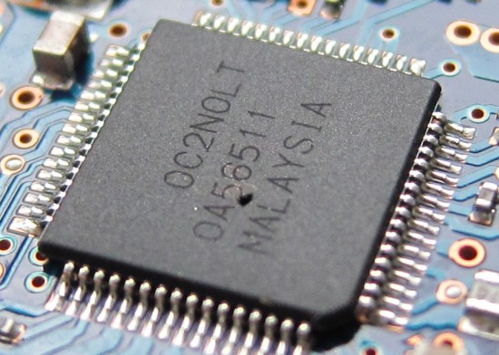

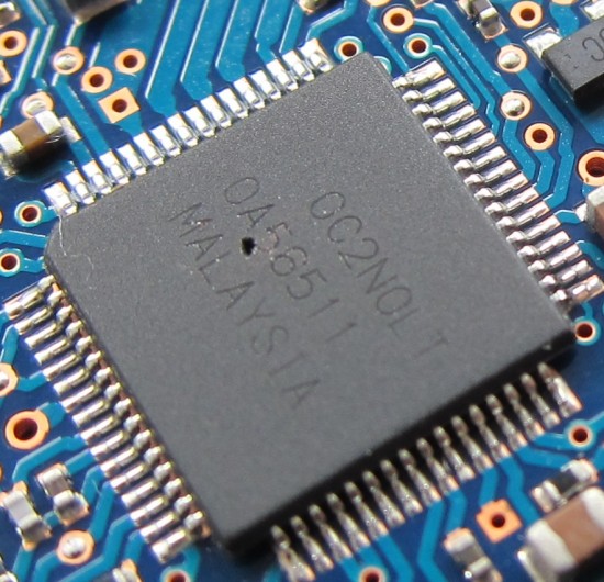

I assumed that the resistors you were referring to were the R050 resistor and the R470 resistor in the regulator circuits. Instead it appears that those two R100 resistors are indeed fusible, and they appear to be fusing the grounded side of each TVS diode. If they're open, then I would have thought that both diodes (Z2 and L14) would have been shorted.
I notice that the motor controller has a black spot under the "5" in "OA5". If so, then that would explain the missing voltages.
Your best bet may be to try moving the 25FU206 chip to a donor PCB.
I would measure the resistance between the "10mV" coil and ground, with the PCB installed on the drive. That will tell us if there is a short circuit within the preamp.

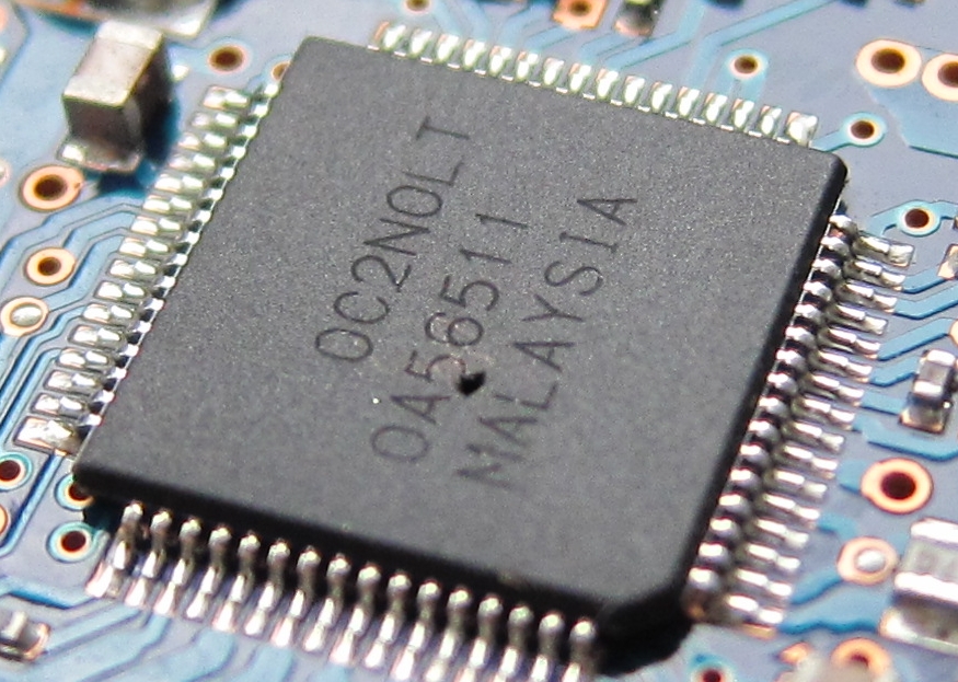

The black spot is actually a hole, I didn't notice that. Can I just change the OA56511 (I saw I can buy that chip online), or change the whole PCB?
If I change the whole PCB, I need to carry the 25FU6 to the new board?
 Post subject: Re: Dead Hitachi 1Tb HDS721010CLA332
PostPosted: August 1st, 2013, 23:26
Joined: May 6th, 2008, 22:53
Posts: 2138
Indeed - that black spot looks to be an actual hole in the chip. :shock:
[Edited to add: I see that yello just confirmed that. Just shows why having photos of the actual PCB can be helpful ;) ]
I totally see your point!
I took two more pix, sorry for the quality, it's the best I can get.
Is my plan realistic:
1. I get a new PCB AND the OA56511 IC
2. I solder the OA56511 to the old PCB (I got hot air and QFP nozzles)
3. If that doesn't work I use the new PCB and move the 25F IC to the new PCB
Can somebody confirm if I MUST move the 25F IC or not please.
PS: Does the PCB need to be the same revision? Mine is 110 OA90233 01

When I measure the R100 against GND (no power cable connected) I get left to right: 0 - 0 & 0 - 1M8
The 2 large TVS are 'open' but the on the small TVS I measure 26K
