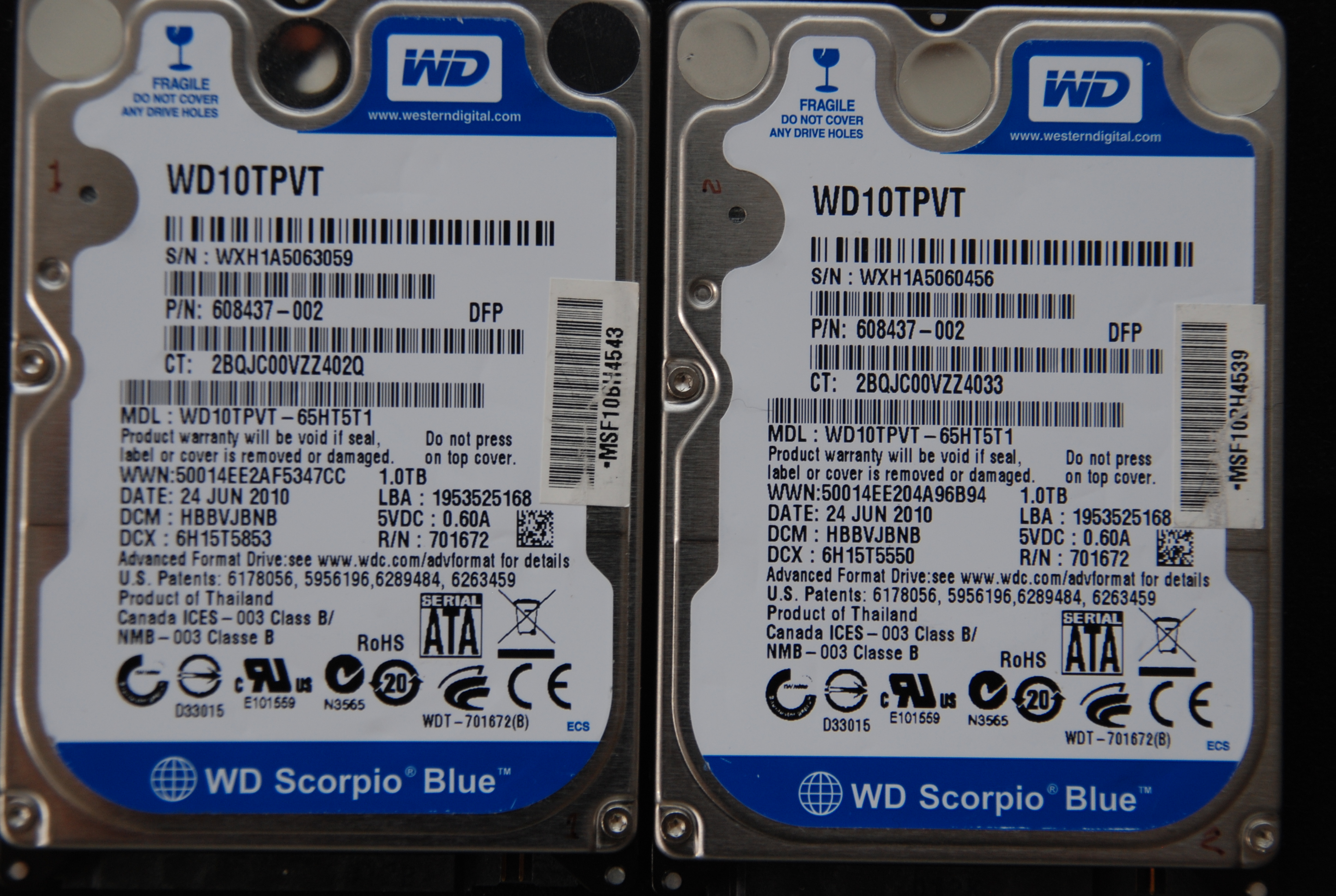

I have a HP Envy 17" 3D Notebook bought 2 years ago, it was custom built with dual WD hard drive, model WD10TPVT, 1TB capacity, they partitioned as separate drives: C, and D under Windows7 Home 64bit, Its the D drive that failed recently, and C drive is working perfectly. When I boot into HP system tools for hardware diagnostics, occasionally the system does detect the 2nd (the D) drive. And full diagnostic testing on this drive found no errors (see attached picture). But most other times system boot it does not see the 2nd drive. And whenever boot into Windows7, the system just don't see the 2nd drive. Since then I ordered from HP spare drive (HP part# 603788-001) but this new spare drive comes in as Samsung drive instead of Western Digital drive.
I was able to make disk copy of first drive (drive C), but I am unable to make copy of 2nd drive, as booting the laptop computer it does not recognize.
This model of HP HP Envy 17" 3D Notebook usually runs hot, so I often put a heatsink on the left side, and one day I decided to add some icecube on top of the heatsink to help dissipate the heat the computer generates, I left computer do download a file, the next day I noticed a warning: "....system detected hard drive imminent failure...". so turned off and check the computer, I noticed melted ice leaked down and some moisture condensation built up in the hard drive bay. Cleaned up and turned back the computer on, it works but the D drive never come back. I am pretty sure its the PC board on the 2nd drive is the problem, switching the PCB board from 1st drive onto 2nd drive, the computer recognize the 2nd drive, but it makes buzzing sound - sounds like motor inside trying to spin then stop - this is my guessing. I realize switching the PCB board is not enough, as the ROM needs to be transferred as well, but I gave it a try anyway.
I am in Texas DFW area, I looking someone to help me to find a place who can transfer the ROM or adaptation so I can restore my data on the 2nd drive, I prefer someone locally so I don't have to to send drive back and forth. I am willing to pay reasonable fee for the service, but not an extortion amount some recovery service companies typically quote.

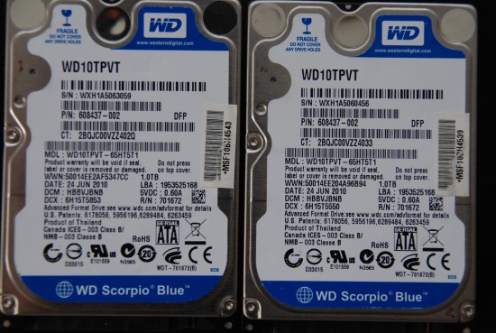

Western Digital Model: WD10TPVT-65HT5T1
DCM: HBBVJBNB
DCX: 1st drive: 6H15T5853, 2nd drive: 6H15T5550
PWB imprinting version: 2060-771672-004 REV A,
File comment: Front Side

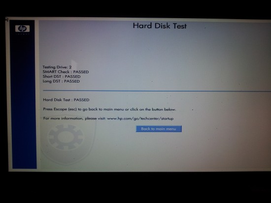

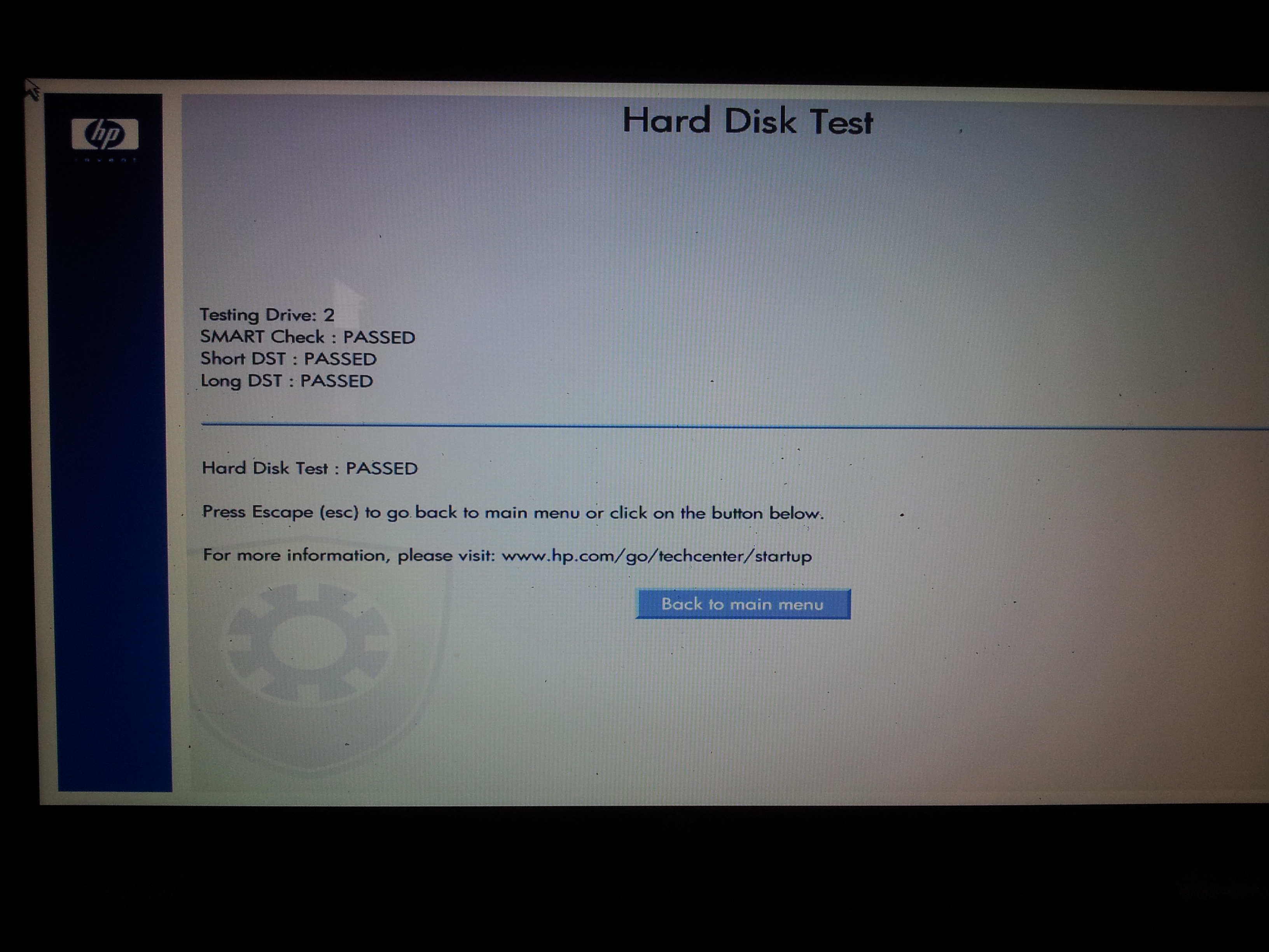

File comment: HP diagnostic tool occasionally sees the 2nd drive and testing was successful. but most time does not see this drive

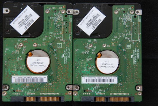

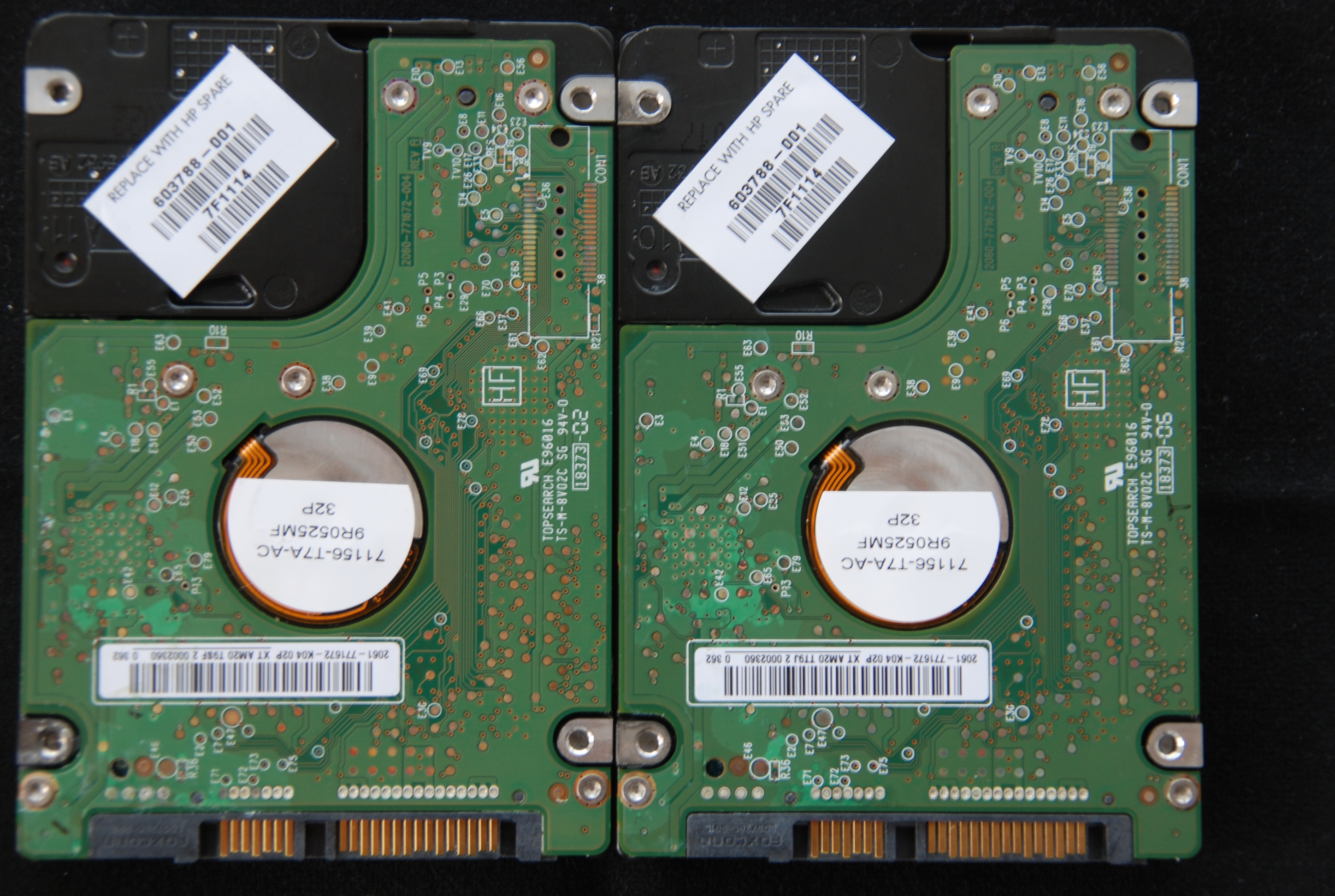

File comment: WD10TPVT-65HT5T1, Backside

The buzzing sound is not a PCB issue, but the failure of the board could of caused it. I have a feeling the board shorted out, and the heads got stuck to the platter since it could not park them correctly before shutdown.
So with almost 99% certainty the pcb/rom swap will not work to fix it 100%. It will only fix the partial issue.
I am in Austin can help you out. But I am not sure what you are expecting for a cost to fix it.
Plus if the heads are stuck to the platter there is a chance they were damaged by the sudden stoppage. So even moving the heads off will not allow the drive to work until new parts are put into the drive.
If it is worst case scenario and the PCB is bad and the heads are bad, be prepared to spend around a grand (give or take a couple hundred depending on who does the work)
If the heads can come off clean without any deep clean room work, maybe 500-700 for a full recovery.
I know there are reputable places in the Dallas area, so just look around. But data recovery places will not do a half job. They will do everything till they have data to show you. Not fix it and then give back to you for the data recovery since problems can arise after the fix.
PS.... Ice is not a good cooling mechanism for electronics..

First, thanks for your response.
You said "..I have a feeling the board shorted out, and the heads got stuck to the platter since it could not park them correctly before shutdown."
I inclined to agree with your first part, but more likely moisture corrosion causing intermittent connection problem rather than shorted, as I can see some visible sign of corrosion on the PBB board then I cleaned it and let it dry for about a day before going further testing
And I doubt the "... heads got stuck to the platter", because the buzzing sound is heard only when I switched PCB board from a good drive (without transferring the ROM, right now I don't have experience or tools to do this, whats why I am trying to find someone to help)
With the original PBC board on the drive, the failed drive appears silent - I don't hear anything at all in computer.
Besides, after 2nd hard drive failure, I booted into HP system diagnostics tools many times, most time the computer cannot detect or see the 2nd drive, however there were 2 or 3 times the computer detects the 2nd drive and I ran test on the 2nd drive in the HP diagnostics tool, when I see 2nd hard drive found no problems for the first 15 or 20 minutes or so, I cancelled the test then boot into windows - but into windows7, then the D drive is always missing. So when next time I got the HP diagnostics tool recognize the 2nd drive, I run a full hard drive test it took about 10 hours, and that test was successful, it did not find problems (see the screen capture showing hard drive test result in my previous post).
then I reboot into Windows7 again, the D drive is still missing, then reboot back to HP diagnostics, the computer does not detect the 2nd drive. Retried many times rebooting into HP diagnostics tool,
the it just doesn't detect the 2nd drive now.

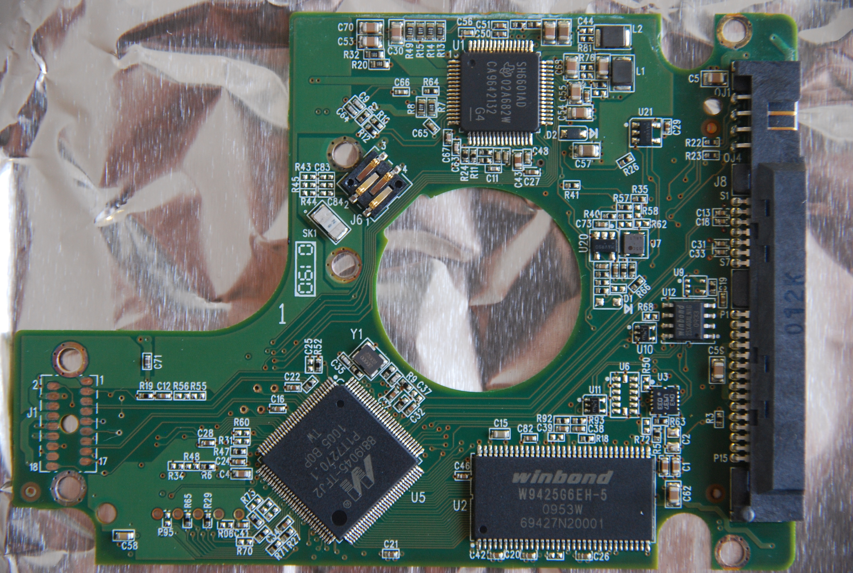

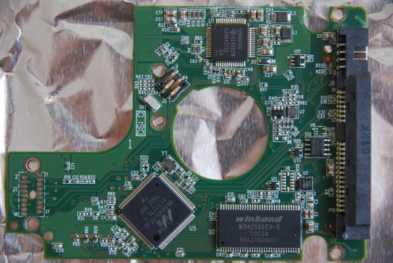

Also can someone please confirm the chip on the PCB board, the Winbond 25X40ALNIG / 0933, marked as U12 is the correct ROM chip to switch?
Appreciated.

File comment: Which is the excact ROM chip to make a donor board?

There are PCB suppliers who will transfer U12 for free. Otherwise, your local TV/AV repair shop should be able to do it for a nominal fee.
There are free tools that will allow you to read your existing U12 chip, so you don't even need to send your original PCB away. In fact, if your other PCB is identical, then you may be able to temporarily reprogram it and restore it afterwards.

The OP has two identical boards, so there is no shortage. ;-)
In any case, not every electronic fault is due to a "shortage".
As for the heads being stuck to the platters, the OP's testing would tend to discount that possibility, would it not?
ISTM that the drive does not have media problems, but it may have some intermittent spinup problem, and possibly a logical problem that prevents Windows from seeing the file system. The original PCB appears to have an intermittent fault. At one time the OP states that "with the original PBC board on the drive, the failed drive appears silent."

I am back now, has been away for a while, and now I got EZP2010, and a X-TRONIC 9020-XTS HOT AIR REWORK SOLDERING IRON STATION
will update the recover process soon.

Switching PCB board and eprom flash chip failed to resolve the problem, I am still getting buzzing sound from the drive upon power on.
Can anyone help from here? I am willing to pay for data recovery. Thanks!!!!
 Post subject: Re: Help needed, with Western Digital model WD10TPVT, 1TB
PostPosted: September 1st, 2013, 11:21
Joined: May 17th, 2013, 1:28
Posts: 12
Cleanroom wrote:
The mismatched ROM will not cause the buzzing noise. It would of still spun up.
The original PCB will not spin the drive due to a shortage, when you put the like board on you get the buzzing and it is sitll not spinning to speed.
I cannot be 100% sure, but I am almost 99% sure that the heads are parked on the platters, or stuck between the head ramp and platter. Both of which would prevent spinning of the platters to speed.
I hope I am wrong so you do not need to open the drive, but be prepared that after you fix the pcb with the right rom, it still will not work.
Hi
It seems you were correct. After switching to a new PCB board and Winbond flash ROM chip W25X40ALNIG, I am getting buzzing noise from the drive, the sound is low and high buzz 5 times (attached sound recording) I suppose this indicates the WD drive in stiction. As fixing hard drive stiction requires clean room operation, its now beyond my capability.
Are you willing to do repair / recovery for me? I am willing to pay for your service - if you have access to clean room environment and have experience in data recovery. Thanks!
