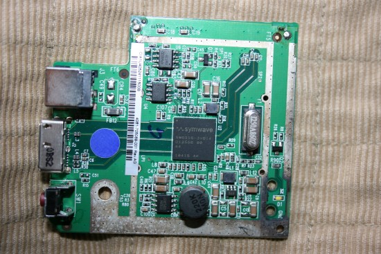

Well, I never seem to know what I can do until I do it. I'm a pretty competent DIY'er, and don't mind trying just about anything.
Picture of the component side of the bridge pcb.
Lower right is blackened around the led where the rubber boot cover wears.
On 200ohm scale the fb12 measures .3 and constant tone from my MM.

FB12 appears to be a ferrite bead that is in series with the +12V input. It measures OK.
I would carefully measure the voltages at each pin of U6 (APM4532). Use a plated screw hole as your ground. You may need to scrape away any oxidisation.
I can't see the markings on U4, but I suspect it may be a Winbond W25X20BLNIG serial flash memory device. If so, then it would store the bridge firmware.

On the 200m V scale of my MM all pins read 0.0 EXCEPT for pin S1 denoted by the dimple in the lower left of the chip- this pin read varying numbers that avg. 1.3
The markings are very hard to see on U4 got out a microscope and found, Pm25LD020, CE1020, SHM7FR8CG.

You should have seen +5V and +12V. The +12V would have come directly from the DC power socket via FB12. Can you measure +12V on both sides of FB12?
BTW, sorry if this is an obvious question, but are you using the DC voltage ranges of your meter?

I am using the DC ranges, and no, I cannot get 12v on both sides of fb12. when I read across it, it always reads 0. Maybe I am reading incorrectly... When reading the U6 I am putting my black lead on the ground screw plate, which is clean, black lead plugged into COM, red into VOA and putting my red lead on each pinout, one at a time and seeing nothing.
On another note, just now while having the board plugged in for V testing for a moment... I saw a bright glow and little fizz and smoke and RT8284 at U5 just burnt up.... It's cooled off now and bubbled up and white in one spot near s1, the pin just to the right of s1 (so, just to the right of the pin under the dimple, lower left of chip) seems to be where all the heat was.

RT8284 is the +5V supply. You now need a replacement bridge board. :-(
BTW, when measuring FB12, I meant for you to measure the voltages between ground and each end of FB12. I'm assuming that it is in series with the +12V supply, not the ground return.
Good luck on finding a compatible bridge PCB. Keep the original, as you might need U4.

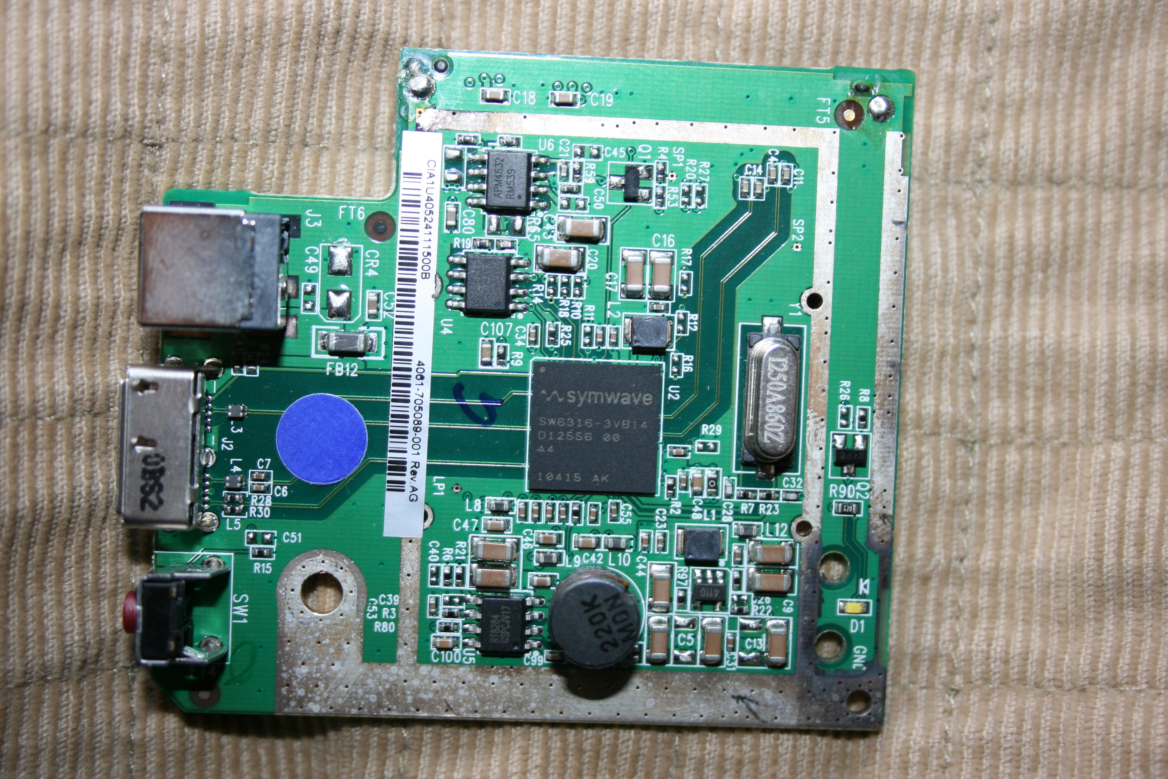

I'm having a weird problem with exactly the same type and board model which i suspect maybe caused by voltage surge.
It has this high pitched buzzing sound when the power supply is connected to the board and it would not power up (LED light on) if the USB cable is connected to the PC.
The board can only be powered up when the USB cable is not connected to the PC (with the power button) and nothing happen if I connect the USB cable to the PC after that. Also the board would not powered off (with the power button) unless if I disconnect the USB cable from the PC.
I've tried different USB cable and power supply but the problem is still the same.
I did not see any fried components when I took out the board, reading at FB12 was consistent at 12V so power input is okay. The readings at the MOSFETT are as below:
S1= 4.97v, G1=11.94v, S2=12.09V, G2= 28.6mV, both D1 = 4.97 V and both D2 = 12.09V
Could it be that the MOSFETT is faulty coz I was able to get connection once when I pressing on that part of the board?
Please advice guys, many thanks!

The "soft" power button is connected to an I/O pin of the bridge IC. When the bridge senses a button press, it toggles the on/off state of the drive. It does this by controlling the gate pins (G1 and G2) of the MOSFET pair. Each MOSFET acts as a switch. One switches the +5V supply, the other switches the +12V. The Drain and Source pins are the inputs and outputs of the switch. From your measurements it is clear that both MOSFETs are working properly. Therefore the drive should be receiving power, assuming that the SATA power connector is OK. That said, I don't understand why you say that you were "able to get connection once when I pressing on that part of the board". ISTM that you are describing a connection problem of some kind. FWIW, many WD users are complaining of physical connection problems with the micro-USB connector.
As for the serial flash memory IC, it stores the bridge firmware. AISI, if your replacement board is unable to decrypt your data, then transferring this IC should account for any incompatibility, assuming the boards are otherwise identical.
BTW, you didn't say whether your drive is spinning up? If not, then the "buzzing" you are hearing may be due to stiction (heads stuck to platters).

@MetalMic, U4 is indeed a serial flash memory IC.
The buzzing sound is probably coming from the 220uH coil (L20) in the +5V regulator. Its windings are probably a little loose, so they rattle. If it bothers you, then spray the windings with some PCB lacquer. There are two other coils (L1 and L2) near the symwave bridge chip that could also be responsible for the noise. If you press on them, the noise quality should change.
As for your drive's original symptoms, these are consistent with a bad contact at the micro-USB connector.
When you say that the "Symwave just fried", what exactly do you mean?

Personally the buzzing sound did not really bothers me except that I notice when I did manage to get that 2 times short period of connection with the HDD, the buzzing sound dissappears so I thought it could be one of the symptoms or sign of a defective component on the board that might be causing the connection problem.
Haha, that what exactly I was doing, pressing on different parts on the board trying to find the defective parts...kinda crude way of troubleshooting since i'm not an E&E professional. You are right, the buzzing noise did differ slightly when i was pressing on certain parts of the board.
I was also looking at the possibilities of bad USB connectors as what was reported by majority of the users but what are the physical signs of a defective micro USB connector cause I can't seems to find anything physically wrong with my mine such as wobbling connector or loose pin contacts with the board.
I accidentally fried the MC chip when i was doing the V testing just like bigd003, shaky hand coz the test probe to make contact betweed two pins of different volts on one of the mosfett and then small glow and fizzing from the MC chip...sigh, so bye bye to board troubleshooting.
