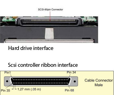

I have an 80 pin SCSI HD that I am trying to put on my 68 pin SCSI cable by using an adapter. I set the jumpers on the adapter and when I connect it to the 68 pin cable, none of the drives on the SCSI chain will be recognized...I'm pretty sure there is a terminator on the end of the cable...
 Post subject: Re: SCSI Adapters
PostPosted: September 5th, 2013, 7:32
Posts: 1752
Can you post a picture of your connections ?

These are the hard drive interface and the cable interface

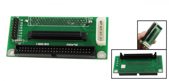

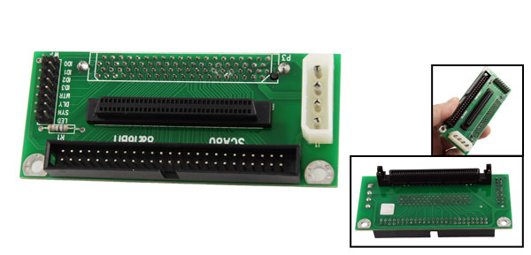

Here's the adapter
PostPosted: September 11th, 2013, 3:09
Posts: 1752
The adapter seems fine, so it's something else.
