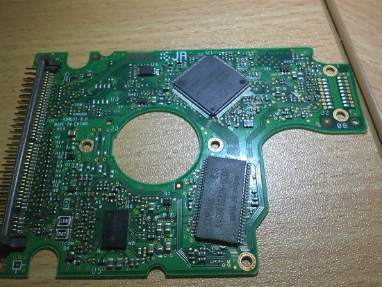

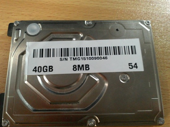

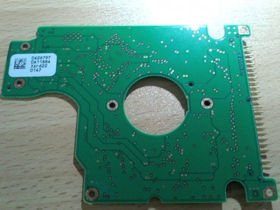

Hi Folks,
I've got a 40GB 2.5" PATA Drive without any identification marks.
I attached pictures, any help identifying which brand and model will be appreciated.
Cheers,
Oded

Hi
Should be an HTS541040G9AT00
Rgds

I take it you don't work on many Hitachi drives? What are it's symptoms? Probably a HTS541040G9AT00.

Thanks Guys.
No i don't see many Hitachi's around here specially not the old ones.
The symptoms:
Clicking.
I opened it up and didn't see any obvious damage to platters or heads.
Is there a know issue with these models?
Cheers,
Oded
 Post subject: Re: Unidentified drive - PATA 4OGB
PostPosted: September 5th, 2013, 7:21
Joined: March 24th, 2011, 0:18
Posts: 182
OK got it how to identify these ones, based on the white sticker on the PCB it was easy to find on Google the model and part number, thanks guys.
