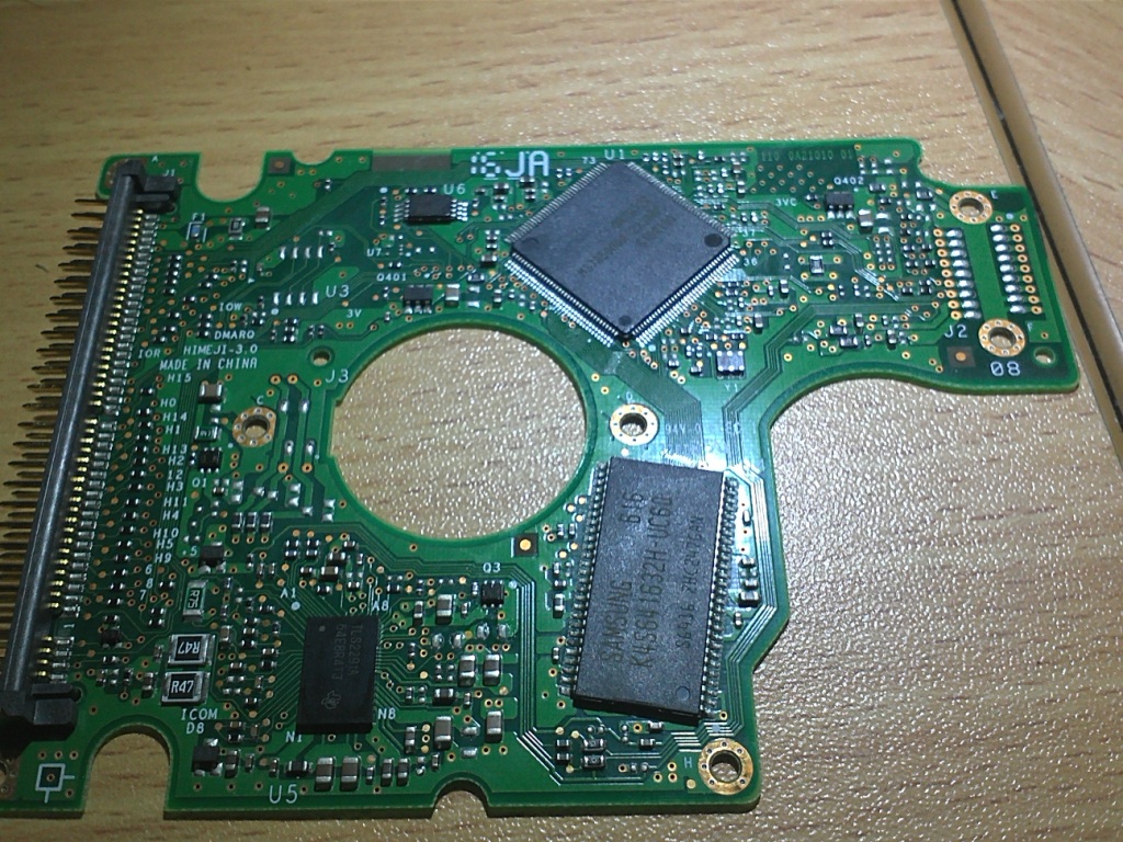

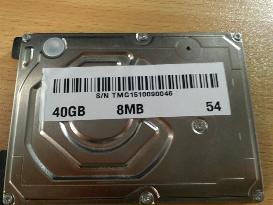

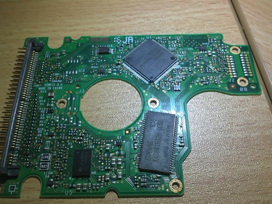

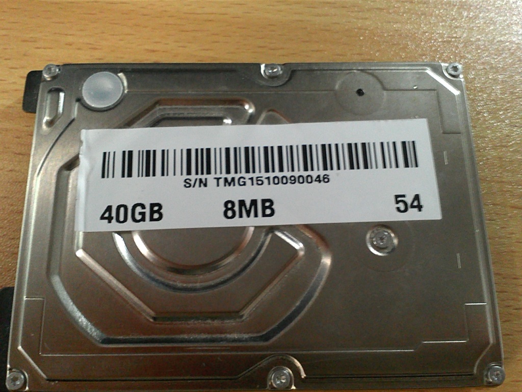

Hi Folks,
I've got a 40GB 2.5" PATA Drive without any identification marks.
I attached pictures, any help identifying which brand and model will be appreciated.
Cheers,
Oded

Hi
Should be an HTS541040G9AT00
Rgds
www.datasave.ro
 Post subject: Re: Unidentified drive - PATA 4OGB
PostPosted: September 5th, 2013, 5:09
Posts: 1898
Location: In your hard drive.
I take it you don't work on many Hitachi drives? What are it's symptoms? Probably a HTS541040G9AT00.

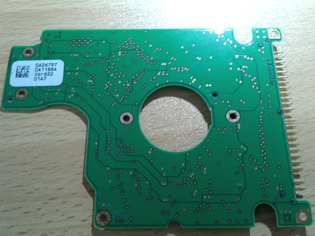

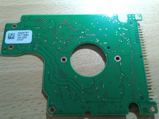

OK got it how to identify these ones, based on the white sticker on the PCB it was easy to find on Google the model and part number, thanks guys.
