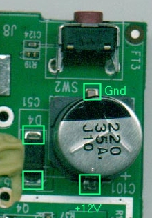

Hi m8:s
anyone who can be kind and show me where the fuse/diode on this dead pcb from this WD My Studio 2TB.
I have couple of same PCB but from 1TB Studio i can use spare parts needed for repair.
Pic attached of the board.
Board is totally dead.
Allt the best!
Thx

If I were approaching this problem, I would check the onboard power supplies.
AFAICT, capacitor C101 (220uF, 35V) is the main filter capacitor. It should have 12V across it. I'm not sure how diode D1 is connected, but I would measure the voltages between ground and each of its pins.

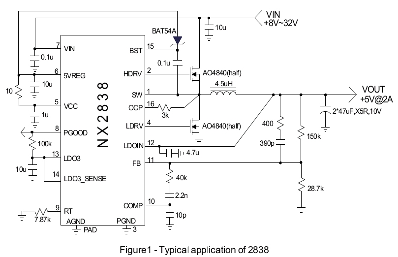

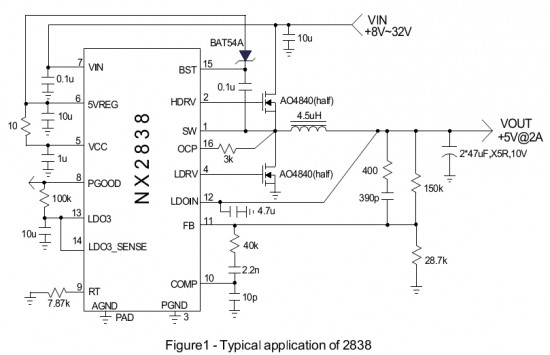

Next I would check for the presence of +5V at the 150K coil, or across the output capacitors. I have attached a typical application circuit for the NX2838 IC.

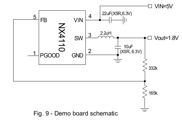

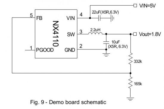

Then I would measure the voltages at L4 and L2, and across their associated capacitors. I suspect that these may be the Vcore and Vio supplies for the Oxford Semi bridge IC. The FW843 chip requires an external 3.3V supply which may also be provided by one of these regulators.

I don't understand why the "150K" coil is measuring 12V. I must be misinterpreting that section of the circuit. There has to be a large 5V DC-DC converter somewhere.
It appears that the NX4110 / L4 regulator is producing a nominal +3.3V supply. The NX4110 / L2 regulator appears to be producing the same voltage on your good board, so I'm wondering whether one supplies the FW843 chip and the other supplies the OXUF943SE.
Your 1.44V voltage measurement is strange. It appears to be suggesting that there is 3.7V on one side of L2 and 1.44V on the other side. That can't be right.
