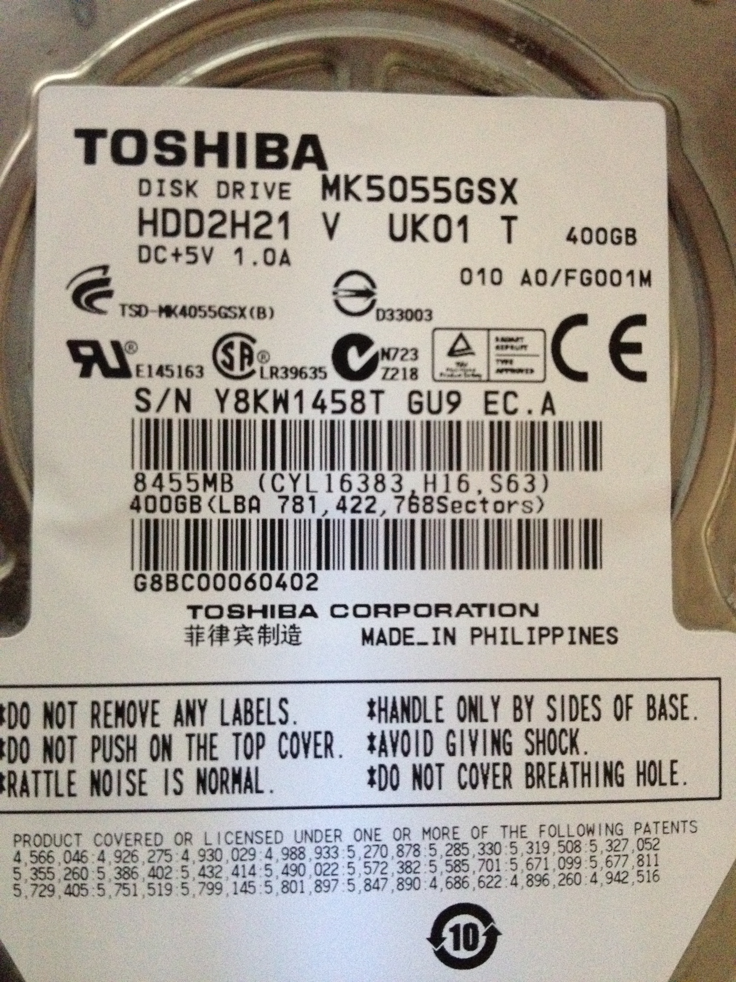

This drive doesn't match any data sheets for being a 400gb hard drive. I think its been mislabelled for a MK4055GSX.
http://storage.toshiba.com/docs/product ... x55gsx.pdf
http://storage.toshiba.eu/export/sites/ ... asheet.pdf
Zero Alpha: zeroalpha.com.au
 Post subject: Re: Incorrectly labelled toshiba?
PostPosted: June 13th, 2012, 0:52
Posts: 1898
Location: In your hard drive.
When you input the serial number into the "View Warranty Coverage" webpage it says "Invalid Serial Number".
PostPosted: June 13th, 2012, 4:31
Posts: 3550
heh, another fake...

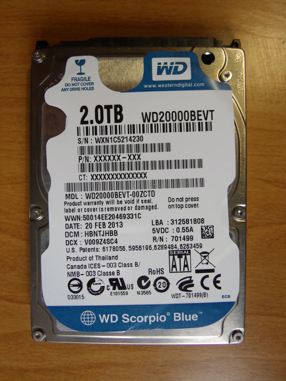

On the topic of fakes, what do we think about this one :)
Data Recovery Cape Town
PostPosted: June 13th, 2012, 6:17
Posts: 1898
A 2TB laptop hard drive from 2006...Sweet!!!

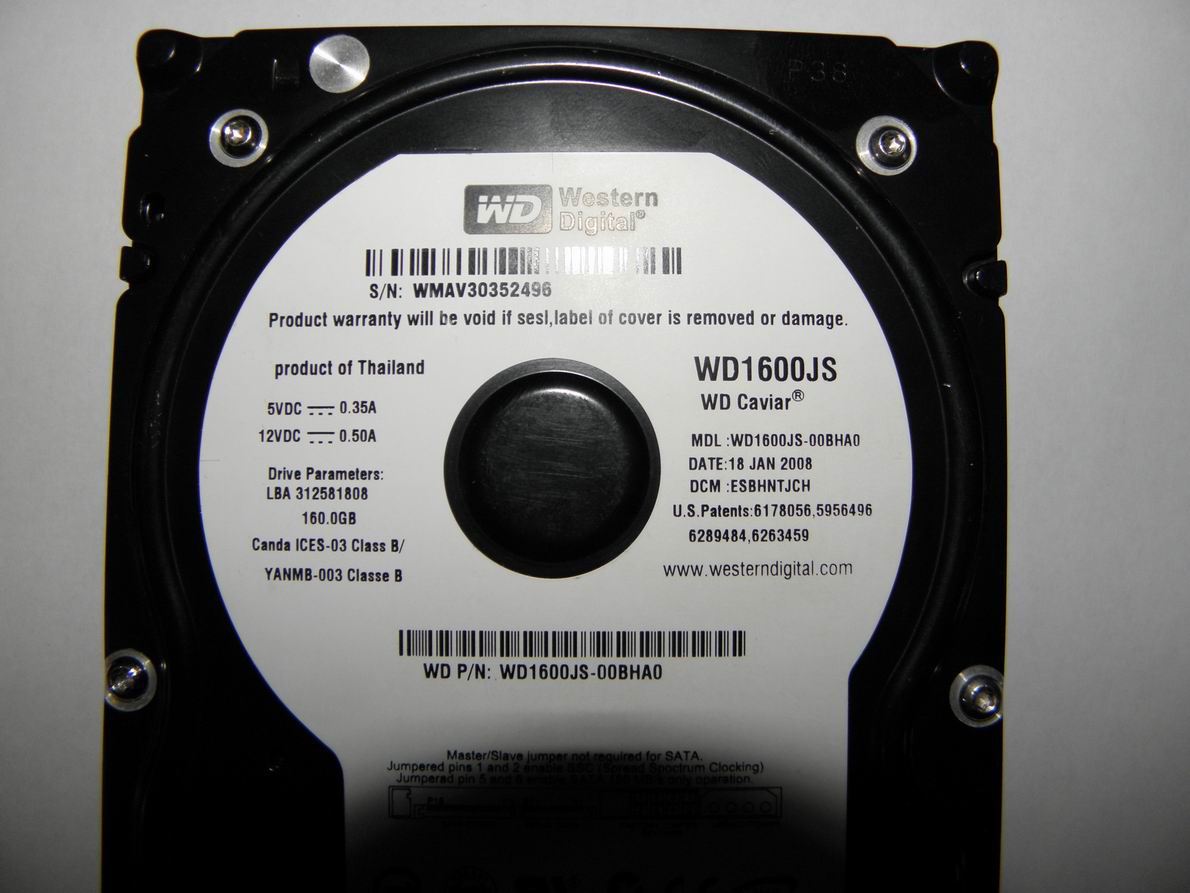

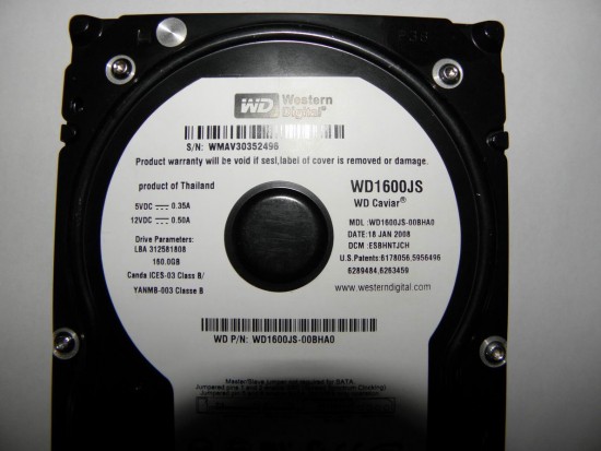

Hehe... At least s/n is valid (of course from an L7)...
Serial Number
WMAV30352498
Model Number
WD1600AAJS-00L7A0
Warranty Status
OUT OF WARRANTY
Warranty Exp Date
11/25/2011

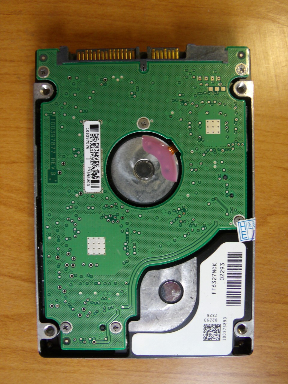

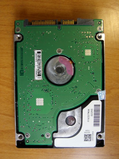

Seagate Denali 2 TB :)
PostPosted: September 10th, 2013, 16:10
Posts: 1038
Location: South Africa
If you're going to label a Seagate as a WD, at least put the WD label on the correct way up! :oops:
