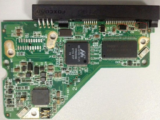

Hi i am trying to fix a WD hdd, if i plug the power, the drive doesn't do jack, so first place to look TVS CHIP.
1) If i have faulty TVs chips, and i try to test the voltage of both chips, and i get a voltage reading that means the chips are working? Do i still need to remove them?
2) If i remove the 2 chips and still the hdd doesn't turn on, what else could be the problem?
3) I know i can use another PCB to test hdd to see if it turns on, what can i do if the hdd that i have the connection of the spindle doesn't match the hdd i am trying to fix anyway around this.
Any tips would be great just learning a couple of things here, Data is not important i am just curious to see how this works.
... and http://www.users.on.net/~fzabkar/HDD/bi ... diodes.jpg
Why would you remove something that is working?
You would need to make some additional measurements.
The 88i6745 MCU contains embedded data that would need to be transferred to your donor. Alternatively, you would need to retrieve these data from the System Area in a reserved section on the platters.

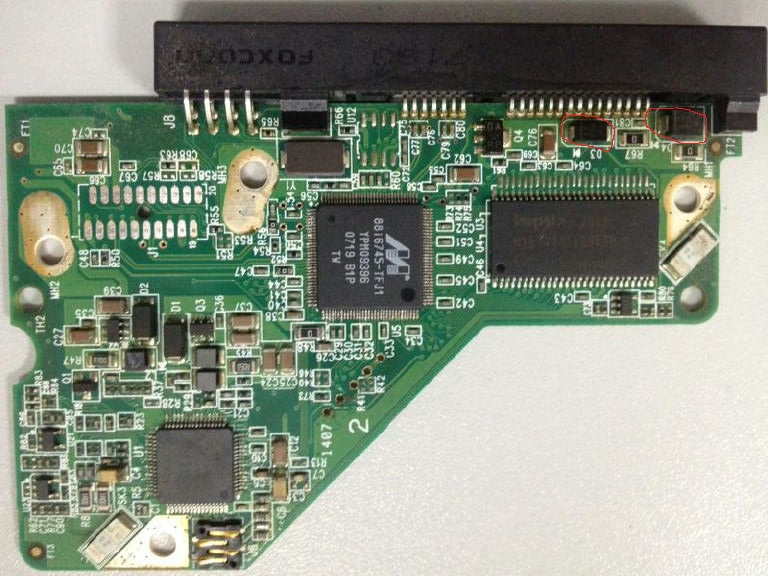

Hi, OK i have found another triangle PCB, i have test the bad hdd with the good PCB to see if i get power, and i did the bad hdd turn on, and then turn off i know that is whats going to happen cause of the FW. Now my main goal is trying to fix the Bad PCB, to see why is not giving power to my hdd.

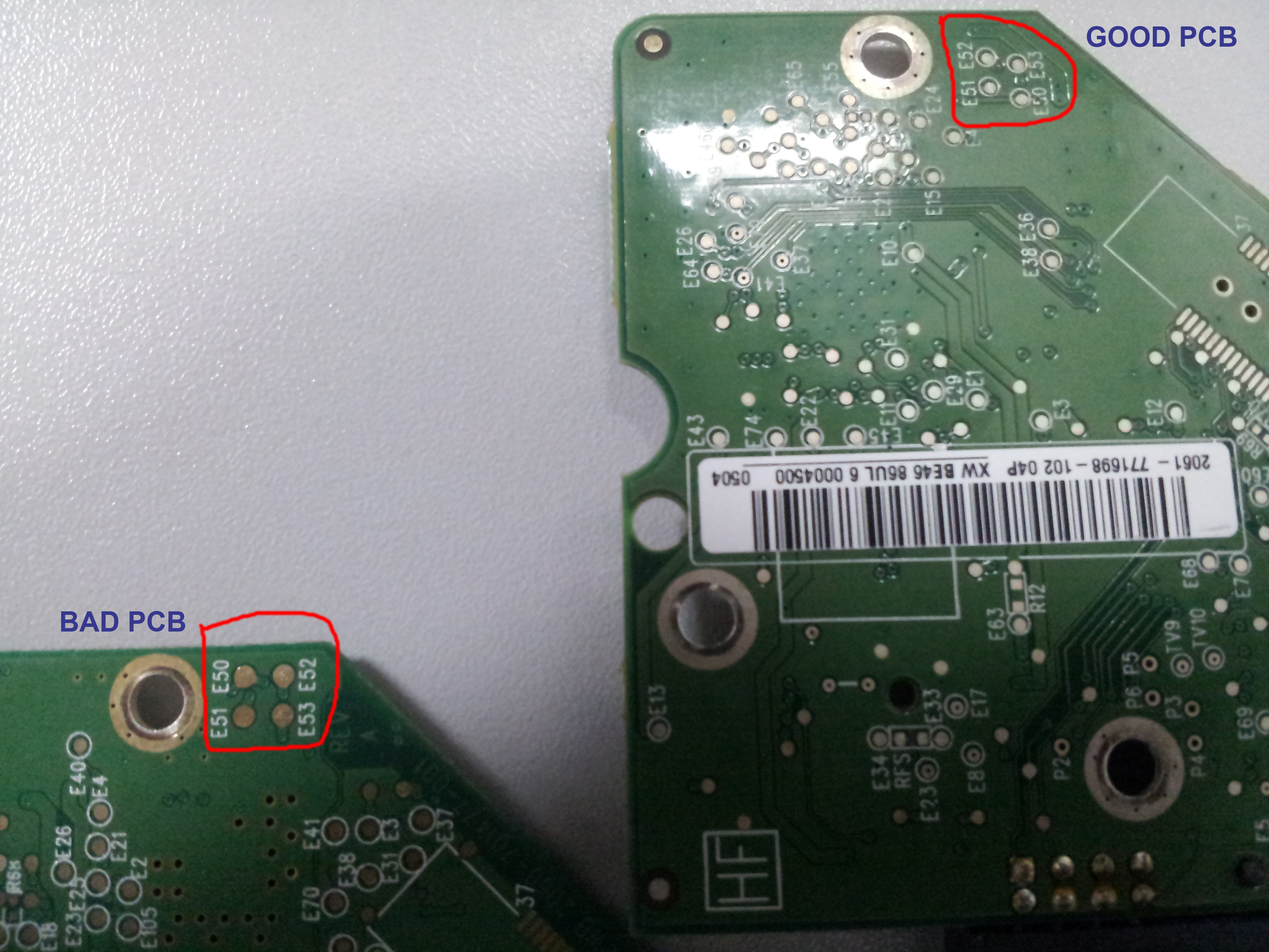

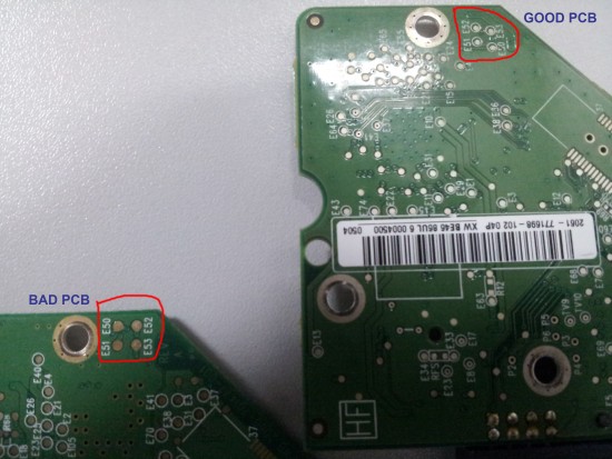

Hi i am testing with the multimeter, and found something odd, i am testing the connector that gives power to the spindle and for some reason in the Good PCB it beeps and on the Bad PCB it doesn't, maybe this is my problem?
The bad PCB Is not receiving power there?

OK now i am confused i took another hdd Samsung and i was checking the same connection i check in the last pic i posted, it didn't beep, but it turned ON the Samsung drive. Hmmm

Did you measure those test points with the PCB mounted on the drive?
What measurements did you get in step #1?

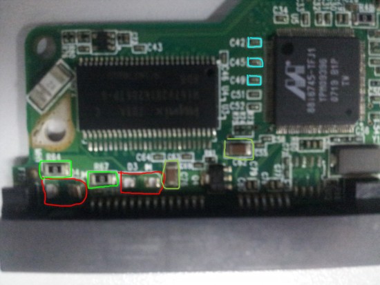

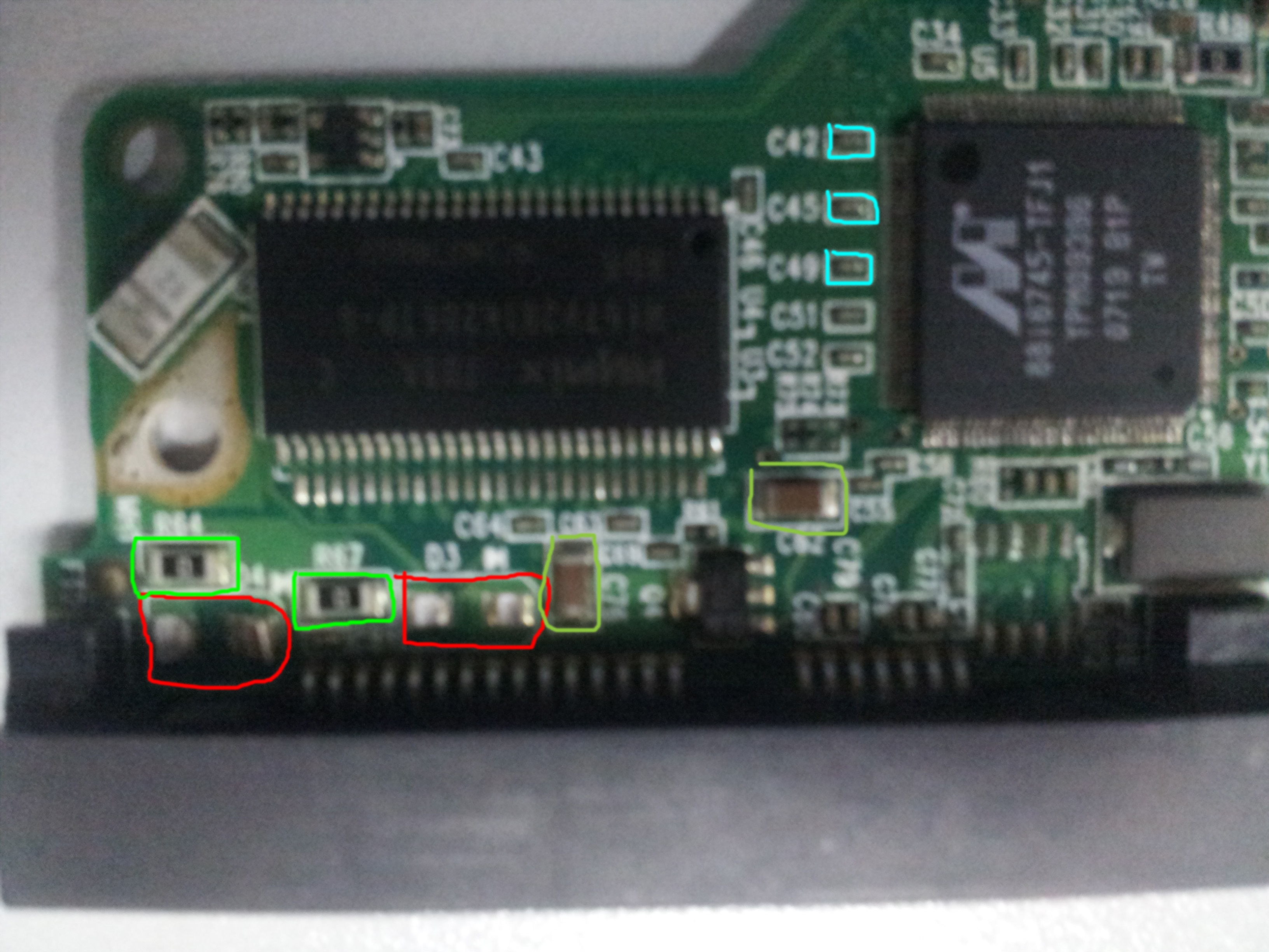

Hi again and thank you for trying to help me, OK the test i have been doing are without the PCB mounted on the hdd, i just took the PCB from the hdd and starting testing the points on the PCB. I have been reading the FAQ about diodes and none went to 0.0, so i guess they are OK one thing tho the TVS Chips are diodes right? what about the other small electronic pieces ex:R67 or R64 are those diodes too?

OK i have posted a pic of the bad PCB with the TVS Chips "Diodes" removed, still same problem no power one thing are those mark electronic little chips are diodes too?.
