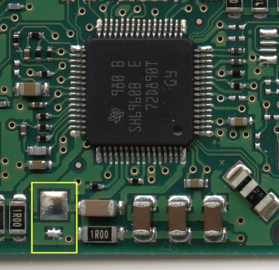

I figured I would bump this thread since it isn't too old. I have the exact same drive as OP does (although it has a slightly different revision PCB), both TVS IC's seem to be fried as well as another one that I'm not sure what it goes to. I already have a new PCB and the drive does start fine with only power plugged in.
In red are the items that are clearly blown, blue should be the ROM chip which is what I wanted to verify. I've identified it as an Atmel 25F512AN EEPROM, so it seems to be the right guy. If I swap this to the new PCB will the data on the drive be accessible? I will be taking it to work tomorrow where I have a reflow station to get it swapped out, just making sure this isn't in vain.
Here is a pic:

@Protocol, you have correctly identified the "ROM".

Protocol wrote:
The power board that belonged in the external enclosure took the brunt of the damage, it looks BAD. I'm wondering what kind of power brick he hooked it up to in order to get that much damage.
Could we see the damage?

Sorry for the cell phone pic but it will do in a pinch. This one was definitely on fire.
 Post subject: Re: st3320620a - 2 diodes burnt out
PostPosted: October 14th, 2013, 22:37
Posts: 17385
The large chip is an AP1506 switchmode DC-DC converter. It steps down the incoming 12V supply to produce the +5V supply for the HDD. It is specified to operate up at up to 22V, so provided that the rogue adapter was of the correct polarity, then this chip should probably have survived.
AP1506-50, Anachip, 150kHz, 3A, fixed 5V, PWM Buck DC-DC converter, TO263-5L, 22V input:
http://web.archive.org/web/200502080902 ... AP1506.pdf
The smaller 8-pin chip could be a dual MOSFET that switches +5V and +12V to the HDD. Can you discern any markings on the package?
You stated that both TVS diodes were damaged. Did you actually measure their resistances? Based on the visual damage to the bridge board, I would have expected that the HDD's 12V diode would have been shorted, but the 5V diode may have survived.
As for the component adjacent to the motor controller chip, my own PCB doesn't have anything at this location.

The 12V is destroyed totally, the 5V blew out the bottom of the package. The small one on the bottom has the marking MLE on it, but it is quite burnt as well around the edges.

The small component is a 12V TVS diode.
1PMT12AT3, ON Semiconductor, Zener Transient Voltage Suppressor POWERMITE, 12V, 175W, marking MLE:
http://datasheet.octopart.com/1PMT12AT1 ... -30310.pdf
If the 5V diode measures open circuit, then the overvoltage may have destroyed the preamp inside the HDA, but that's something for the professionals to determine.

Thanks very much for the help, I moved the chip over this morning and the HDD runs up like a champ. Got all the files copied to a brand new drive just to be safe, but it seems to run like new.
