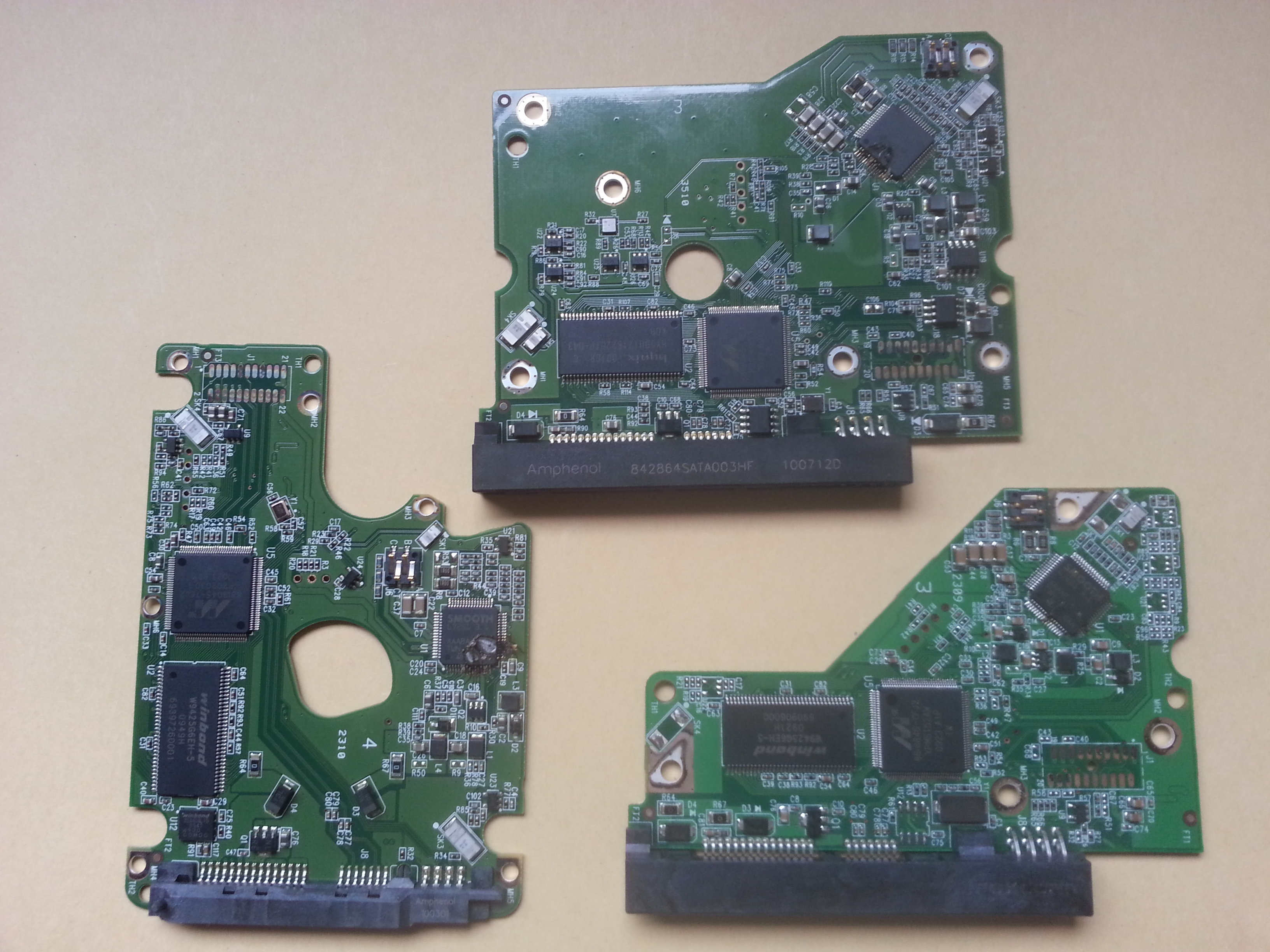

I recently replaced my power supply, and apparently I did something wrong when connecting my HDDs.
I ended up with four fried disks. Hooray for poorly tagged modular power supplies.
I have three years worth of work on those disks and don't have any external backups, as I made the stupid mistake of backing up between the internal disks. I mean, what are the odds of four disks failing at once, right? Right...
Anyway, after removing the PCB boards, it seems to be the same chip that's been destroyed on all of them; the L7251 3.1. Should I simply try to replace these, and hope for the best? Any kind of help is appreciated.
All disks are WDs, by the way.

Bloody hell, I wonder what caused that... The only recommendation is to find a replacement PCB board and swap over the ROM chips. But what gets me is why the TS Diodes did not protect the boards in the first place and all of the Smooth chips are dead too.
The only sound advice is get the drive with the most data on it, then take it to a good DR company who then could do the work for you. If its just the PCB board friend, it should not cost much, but if the preamp and other internal stuff died, then it might cost more. Since the drives can't be powered, damage should be minimal inside the drive and easy to recover.

The problem is the contacts look all burned, but what concerns me is how did a high current pass through all the protection devices and fry the chip. Chances are that if an over current fried the smooth chips, then the larger controller and other components would have unseeable damage too. A new PCB board would be a safe option.

Hi, you can't simply just switch the Smooth chip...as you probably have damage in more circuits on the board.
And more worrying is that, if the short-circuit was that powerful you most likely have bad preamps inside the drive as well.
I can see you live in Norway, if you want you can send them over to Sweden and I'll take a look at them.

I see also a lot of oxidation on pcb on the bottom right, this could caused also malfunction on head that could caused bad sectors appearing.
If you will be able to fix drives after finding donator pcb and doing the rom transfer, you also need to check if there are bad sectors, i bet there are at least some pending sectors on the drive where it was mounted the pcb in the bottom right of the pic, very likely also on the drive of pcb on the top pic.

Measure the resistance of TVS diodes D3 and D4, and zero-ohm resistors R67 and R64.
I expect that D3 will be shorted and R67 open circuit. If so, then this would point to an overvoltage (or reverse voltage) on the +5V supply. The damge to the SMOOTH chips is consistent with damage to the Vcore and Vneg supplies. The latter powers the preamp, as does the +5V supply. Therefore I would expect that all 3 preamps may be dead. :-(
As for why the TVS diodes didn't protect the drive, it appears to be due to some stupid design decision. WD's zero-ohm resistors appear to protect the external PSU from a shorted TVS diode rather than protecting the drive from a faulty PSU. :shock:
