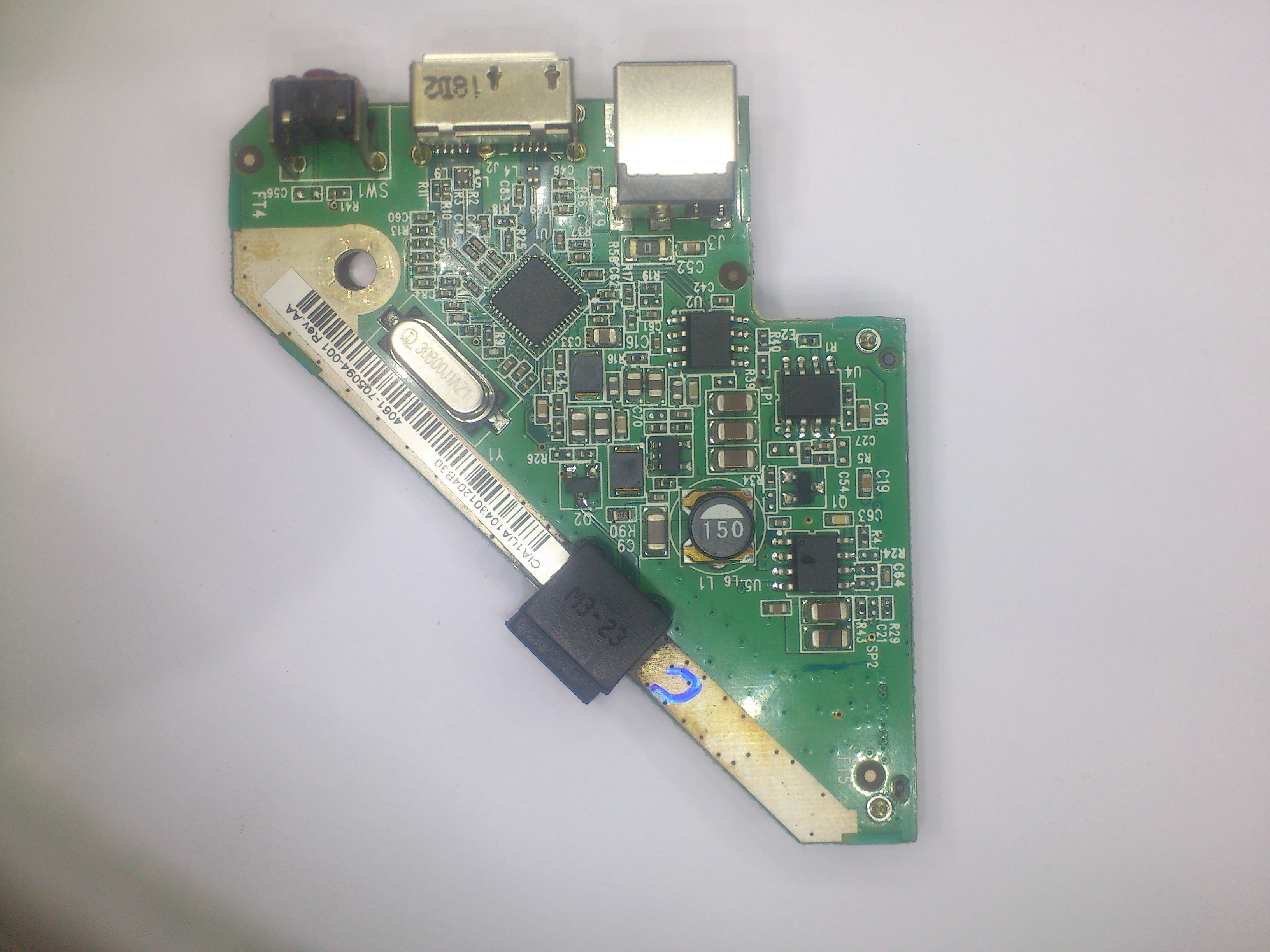

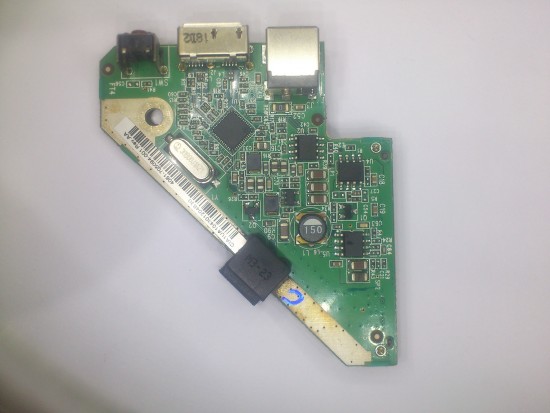

Here is the controller pic - is there anything I can check with a multimeter to localize the issue?

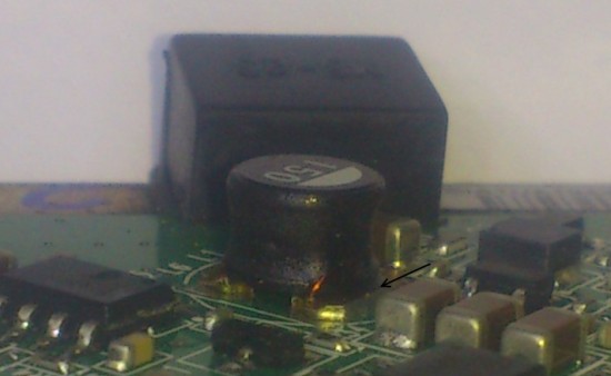

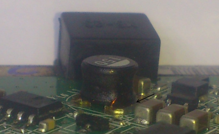

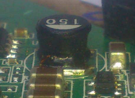

more info : I went through the control board with a magnifier. Only place I could see any sort of heat effect is on the component L6. The base of that component looks melted - the melting looks to be only on one side and there is no charring of the board below. Could that be the reason for controller failure? (pics attached - not great quality, will try for better ones in day light tomorrow).
Rajesh

The chip on the bottom right loots like it has a burn mark on the top, so it might be damaged. Not sure what it is. Someone else might have to offer advice.

U2 stores the bridge firmware.
U4 appears to be a dual MOSFET that switches +5V and +12V power to the HDD's SATA power connector.
The chip at U5, adjacent to the 150 coil, appears to be a PWM controller for a +5V regulator. Measure the voltage at the coil.
If U5 is damaged, but the remainder of the PCB is OK, then it may be possible to hack the board using an external +5V supply (from your PC's PSU), but you would need some electronics skill.

This bridge board has slightly different labelling.
U5 is RT8284 DC-DC step down converter.
( http://en.richtek.com/product_detail.jsp?s=566 )
U5 is appears to be blown - the input reads correct 12V but no output. There is no voltage drop across the adjacent "150" coil either. Moreover there is some physical damage to U5 on the top, not sure whether it is part of the design or melted from inside.
U2 is 4619 MOSFET - not sure how to them in circuit.
http://pdf1.alldatasheet.com/datasheet- ... O4619.html
U4 is W25X20BLNIG winbond 2M bit serial flash memory.
any suggestions to rule out or check U2 and U5? thanks.

There shouldn't be a DC voltage drop across the coil, but there should be +5V between the coil and ground.
Assuming that the coil is OK, and that there is no short circuit between the coil and ground, then you might like to try replacing the RT8284.
It costs US$0.68 in single quantities:
http://www.digikey.com/product-detail/e ... ND/3078258

Is it my eyes, or is there no sata connector in the board ? I can only see a USB port and something else.
http://parts.com.hk/1/images/1wd_contro ... 001_01.JPG
http://parts.com.hk/1/images/1wd_contro ... 001_02.JPG
http://parts.com.hk/1/images/1wd_contro ... 001_03.JPG
http://parts.com.hk/1/images/1wd_contro ... 001_04.JPG
