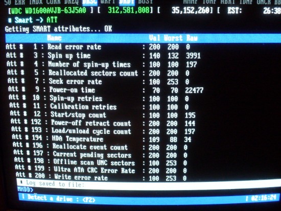

Probably there are bad sectors.
Do not continue to insist with all these programs or things may go worse, you should make a clone of these hdd on new drives and only then use programs like R-studio on clones for data recovery.
Did you check SMART status?
I think you will see a lot of reallocated sectors or pending sectors in smart status, you can use MHDD to check it (F8 button in mhdd) and do a pic of the screen to post here.

Thanks for the reply and the advice. I checked SMART and everything appeared to be fine. I'll check the status again, just to be on the safe side. I will run MHDD and post the results for evaluation. Thanks again.

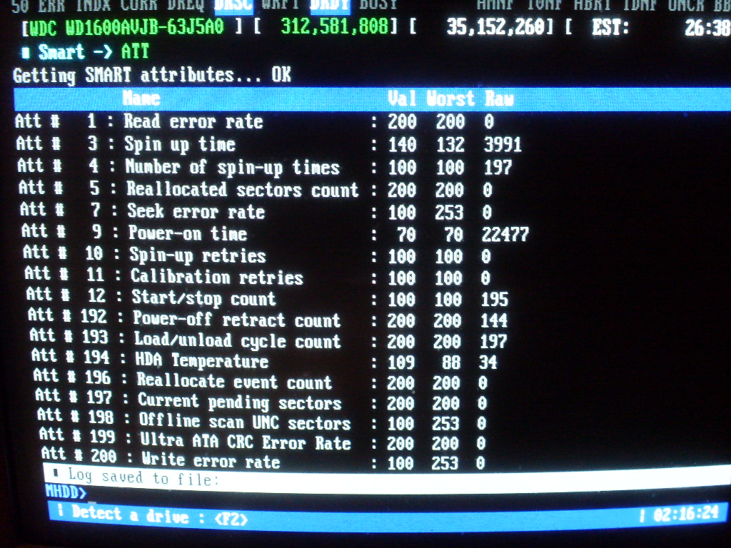

Here's a screen shot from MHDD.

Smart status seems good to me.

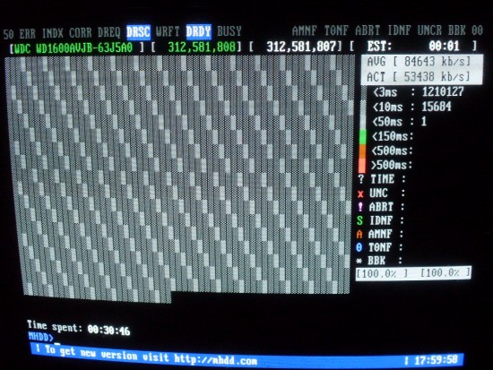

I pressed F4 twice and performed a surface scan. I couldn't see any warnings but here's a screen shot of the results, just in case I've missed something.

Any encryption of any kind used?

Whatever software you ran, R-Studio and such, did the scanning process complete? And there were no issues during the scanning process?
