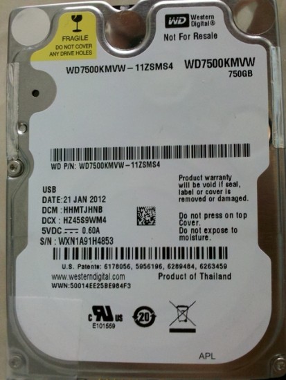

Hello all,
Does anybody know, how the Westen digital marked their old USB external 2.5" hard drives.
I need buy this exact model WD7500KMVW-11ZSMS4 (USB 750GB portable Western digital 2.5" hard drive) and can not find optional name for it. I do not have plastic cover from it and do not know if it was called somehow else...
Can someone help me please.
Thank you in advanced.

I will try to ask otherwise. I need change heads on mentioned USB portable hard drive(screenshot attached). From what portable HDD, Could I use heads to mine? Could I use heads from any kind of HDD? Or has to be used only from the same drive model? Please advise me....

By the looks of it, theres no different optional numbers. Just need to find the same drive online (try and get the date near each other, eg. JAN 2012

I found couple on eBAY, but every of them is from Sept 2012. Could I use it?
 Post subject: Re: optional names for Western digital portable HDD
PostPosted: October 1st, 2013, 9:27
Posts: 3598
Location: Chicago
Sounds like you don't have enough experience for the job.
You could use the same model drive as a donor but would it work? That's the question that can be answered only by a person with experience. And that's the job that should be paid for.
In short - the best thing you can do is to send it to a pro

It is in "pro" hands, but they don't have heads for my model. I have to deliver the same drive model, so I am trying to find out information if I can use only the same model...
Also On ebay is little bit expensive, I don not understand why. The cost of the drive was about 80 euros when I bought it last year.

1. doesn't sound like a pro to me
2. There is generally no way to tell what's inside the USB box unless you have the drive in your hands.
ebay is expensive because people there blindly buy a bunch of external drives, crack them open and provide all information about the drive inside and wait for a right buyer
