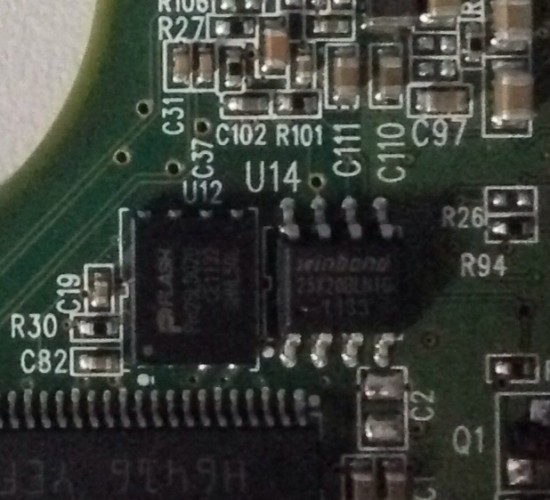

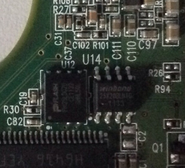

Hi guys.
I bought the exact same model number PCB for my hard drive (2060-771761-001
P1)
and the U12 chip is bigger on the new PCB. Before you ask, I have had it professionally diagnosed my hard drive and the old PCB is confirmed to be dead.
Upon closer inspection, I can see that theres a small sticker on the pcb's and the new pcb doesn't exactly match it although the the PCB's look 100% identical to each other
Old PCB sticker: 771761-301 AB
New PCB sticker: 771761-101 ABD3
Take note the printed model number on the PCB's are exactly the same
Old: 2060-771761-001 REV P1
New: 2060-771761-001 REV P1
So the seller didn't mention anything about the PCB sticker having to match too, but I didn't know myself
Anyway, the REAL question is this. Have a look at the two pictures. Do you think i could still solder on the old U12 chip onto the new PCB? Maybe if my friend can line the legs into the socket and it works?
EDIT: OR AM I JUST STUPID BECAUSE NOW THAT I LOOK AT IT, THE U12 ON NEW PCB IS JUST SIDEWAYS??!!!!
File comment: New pcb
File comment: Old PCB

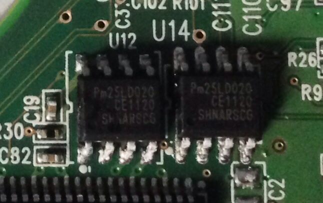

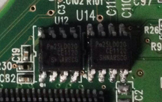

Well, first of all both chips on old PCB were already unsoldered before.
Second, I've never seen that PCB would have both chips of the same manufacturer. That could mean one of the chips (U12 or U14) is not original. They also can be both not original. That would mean that even if you swap the chip - drive still might not work if the chip is not original.
Third, the bigger U12 chip on new PCB is just different form-factor. It can be soldered perfectly well on any compatible WD PCB from a 2.5" drive(as well as smaller chip). WD is know to use different form-factor chips for U12, that is normal.

Trust me, all chips are original and yes the old
Pcb chips have been desoldered before because i sent to data recovery company for diagnostic only. They said its pcb failure and even sent me a file list of whats on the drive
They asked for £280, but obviously i only sent it to them to confirm if pcb is at fault

The U12 and U14 on old PCB are original chips, they've never been changed (except for data recovery diagnostic)

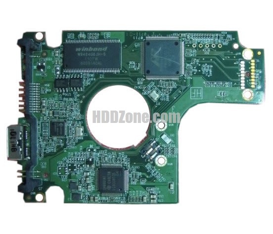

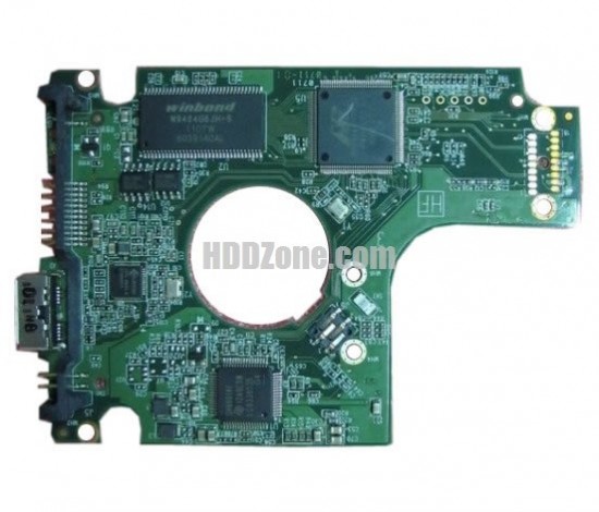

Ok to let you know they're original:
-Bought brand new so its not been used before the hdd
-When I opened the external hard drive enclosure, the chips looked like that.
Nothing has changed
So there is no way these chips have been replaced, I've had this HDD from new
Also, you can see the same chips on a stock photo here
File comment: Photo from pcb supplier
U12 and U14 are same

Then swapping U12 should be enough to replicate original PCB
That is the perfect answer. Thank you so much for clarifying.
