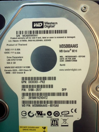

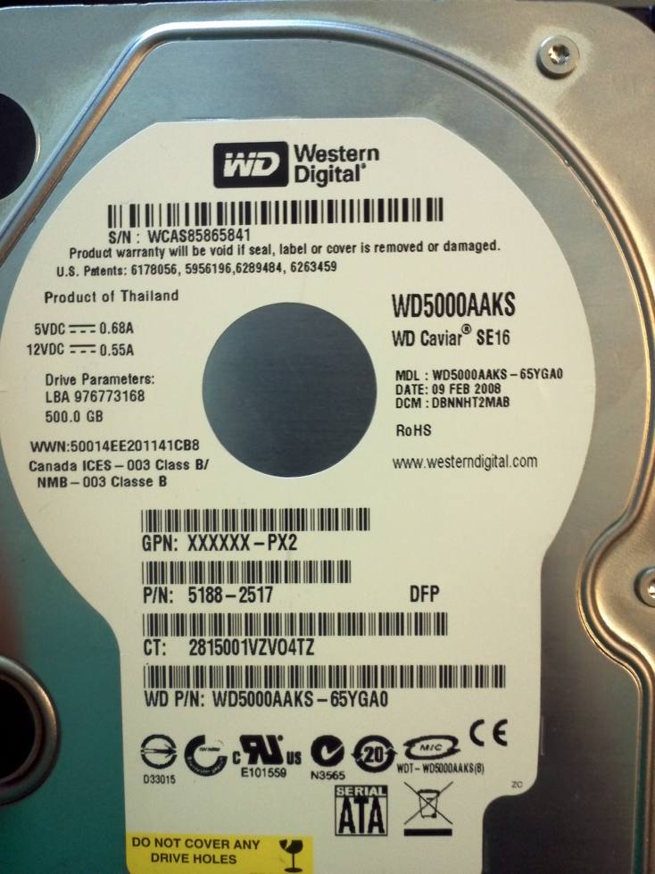

BTW the full model number is WD5000AAKS-55YGA0 2060-701444-004

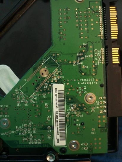

Thanks i will post the picture now. one thing though. The PC came with two HDD. Exact same one in fact. When i put the good one in the USB i hear exactly the same noise. However the good one gets recognized after few short seconds and the spinning sound stops.

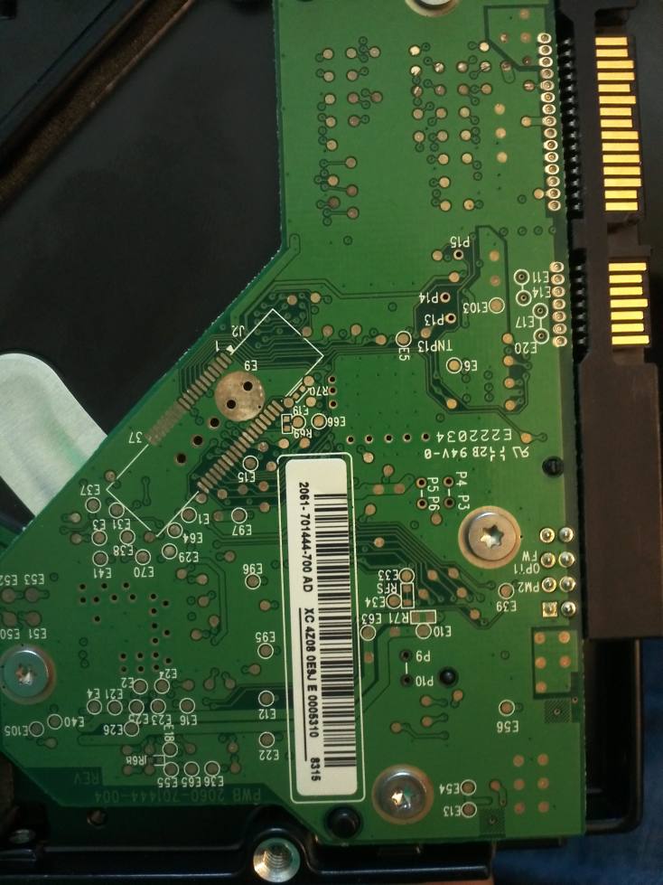

[img]IMG_20131003_170819.jpg[/img]
[img]IMG_20131003_170845.jpg[/img]

Yeah, I am not too sure if a WD PCB board is supposed to get hot when in operation. The only thing I can suggest is wait one hour, then connect the drive to the enclosure and see if it reconised for a short time. If not, it might be a problem internally. If that is the case it will have to be outsourced to professionals who have the tools and experience to get your data back.

@arvand007, your board has a Marvell 88i6745 MCU which is afflicted with "head mimic" faults:
http://pcb-hdd.com/images/WD5000AAVS-00 ... %20PCB.jpg
The first thing I would try is cleaning the HDA contacts (J1) with a soft white pencil eraser. If that fails, then try to find someone who will perform a "PCB adaptation service" for you. That will eliminate the PCB as a potential culprit.
thanks, where is HDA contacts (J1) exactly? I have no idea!

Posts: 17330
arvand007 wrote:
sorry, what is exactly the HDA contacts (J1)?
There are 20 pads at the lower right corner of the photo, between the two screw holes. These mate with the connector on the body of the HDD.
The following article should help you:
http://hddscan.com/doc/HDD_from_inside.html
See the item labelled "Heads Contacts".
