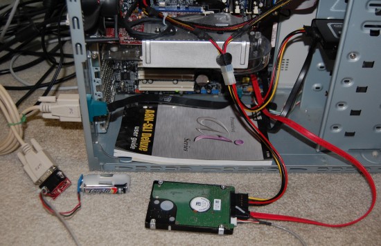

I have a Samsung Spinpoint MT2 (model HM100UI/Z4) 1TB 2.5" SATA drive that I'm trying to recover the data from. This drive came from an Iomega external USB powered box.
I've included the beginning terminal output after powering the drive. I can feel the drive spindle vibration, as well as see the SPOK message. These S_0AP message continue to count up. I'm trying to determine the root failure cause. I'm not in the DR business, I just help others from time to time. I'm reasonably familiar with drives and am a Unix/Linux kernel file system specialist.
Thanks in advance for anyone who can help interpret this output. BTW, is there any documentation for this Samsung terminal interface?

(continues counting up like this)

Head gone (dropped maybe?) or severe media damage. Or both.

Thanks BlackST for replying. Since I can't afford DR service, I was considering opening the drive to inspect connections and look for any physical damage. Do you ever clean heads?
Can you point me to a guide that describes how to interpret this output? I can't tell which H parameter is the head number, 0 or 5 here.

The terminal output does indeed, as others have mentioned, point to head trouble (damage/fault with head or damage/fault with media), which could be due to one or more things. The details, though, don't really make a difference in this case. Opening the drive to 'inspect' is just asking for disaster unfortunately and won't fix anything.
If the data is important to you then you should take it to a data recovery company. It's not what you want to hear, but you won't really get any better advice that will change things :(

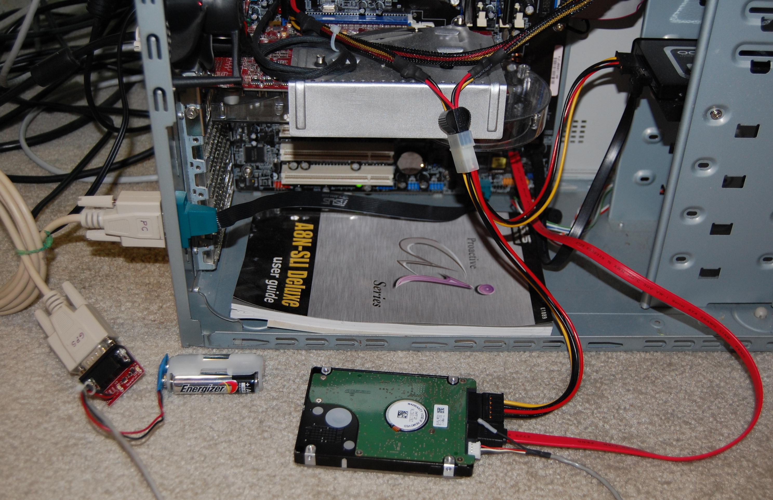

Hi Franc,
Here's a picture of my test setup. The little red circuit board is a RS232 to TTL level shifter circuit, which outputs 3V TTL since I've powered it with two AA batteries. I purchased this level shifter from Sparkfun for $13.95 (http://www.sparkfun.com/products/449). The white connector plugs into the 4 pin diagnostic port just beyond the SATA data port. I used a short cable taken from a scrapped VCR since it's four linear pin connector matched the drive. I used 3 of these 4 pins: the closest to the SATA connector is Tx (red), the middle is Rx (white), and the furthest away (black shield) is Ground. Since I was testing from Linux I used the minicom terminal emulator at 57600 baud mode with 8 data bits, no parity or flow control. (Had to experimentally determine the baud rate.) Hopefully this will be enough for you to interface to the terminal port.
It's a shame to come all this way and fall short by not finding any info on the Samsung terminal interface!

as u were told, your problem is not wether H0 or H5 is damaged. In either case this job is beyond DIY scope. If u want to experiment with your data, just go on, u have some chance though it is very slim without knowledge and technology.
Please do understand that pros will not help in such situation, because of 2 reasons (at least):
1. They would assist in killing data, not recovering,
2. It would be against their or other's business, like it or not.
Briefly: it's up to you what u will do in this case (of course), but condemning anybody or even the forum is not appropriate in this case.
Personal oppinion: BlackST was pretty much on the point, gave the right answer in short. Please do appreciate it.

I don't see an SpinUpOk anywhere. Also, your head 3 is shot. UF = 3 1stGrayErr.
edit: Oh nevermind, there's the 'SPOK'. Definitely lab bound.

BTW, it seems that at this point there is a chance of a partial recovery on a lower rate.
At least I usually offer...
