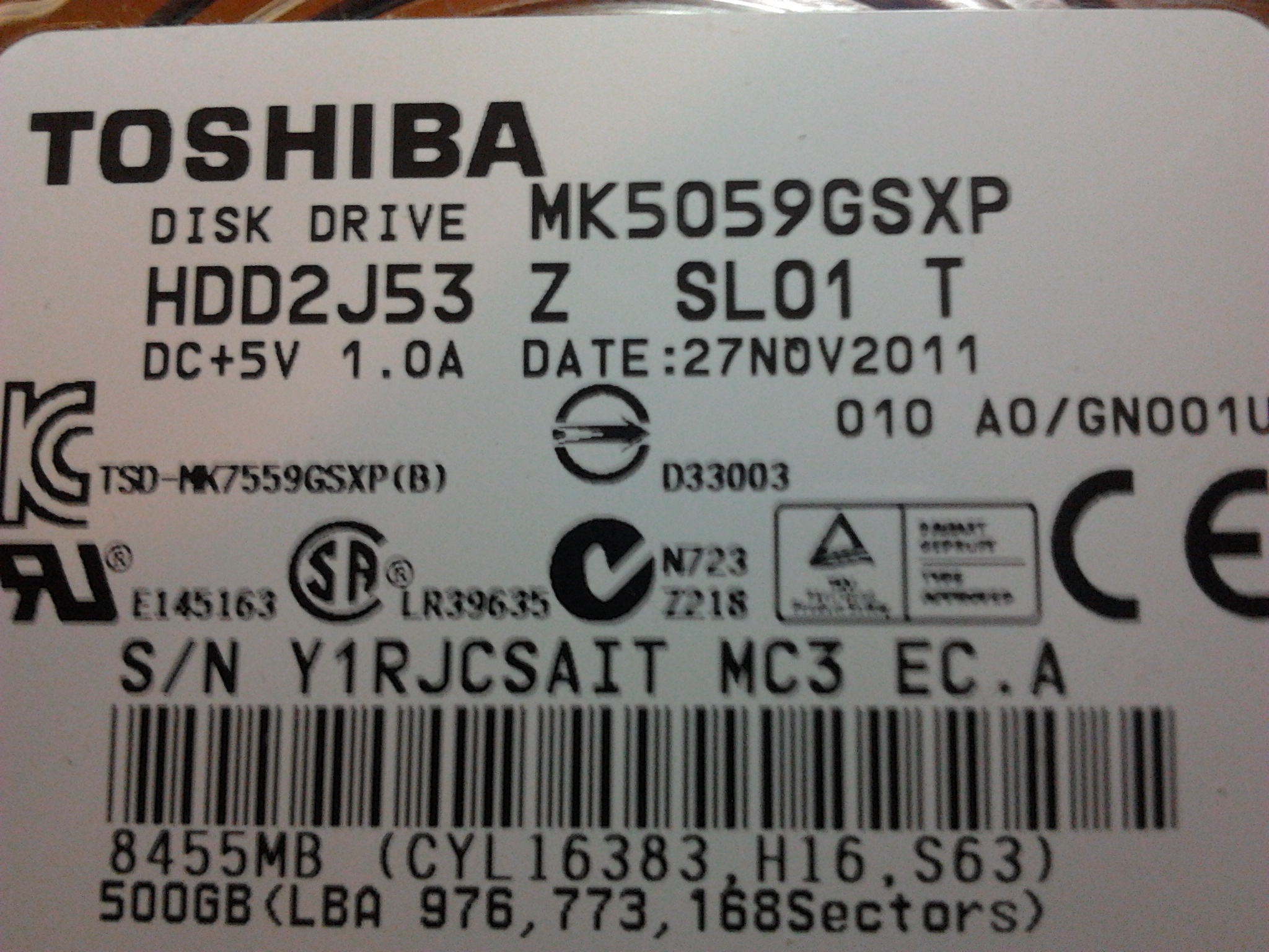

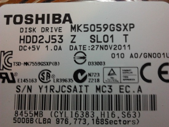

I have a toshiba MK5059GSXP HDD2J53 Z SL01 B with FW 010 A0/GN001U, i can't find the exactly board, but i could find the same model of PCB with same controller chip 88i9117-TLA2 of a different model (but same capacity, 500GB) with no FW in... what should i do about? :(

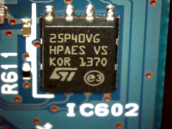

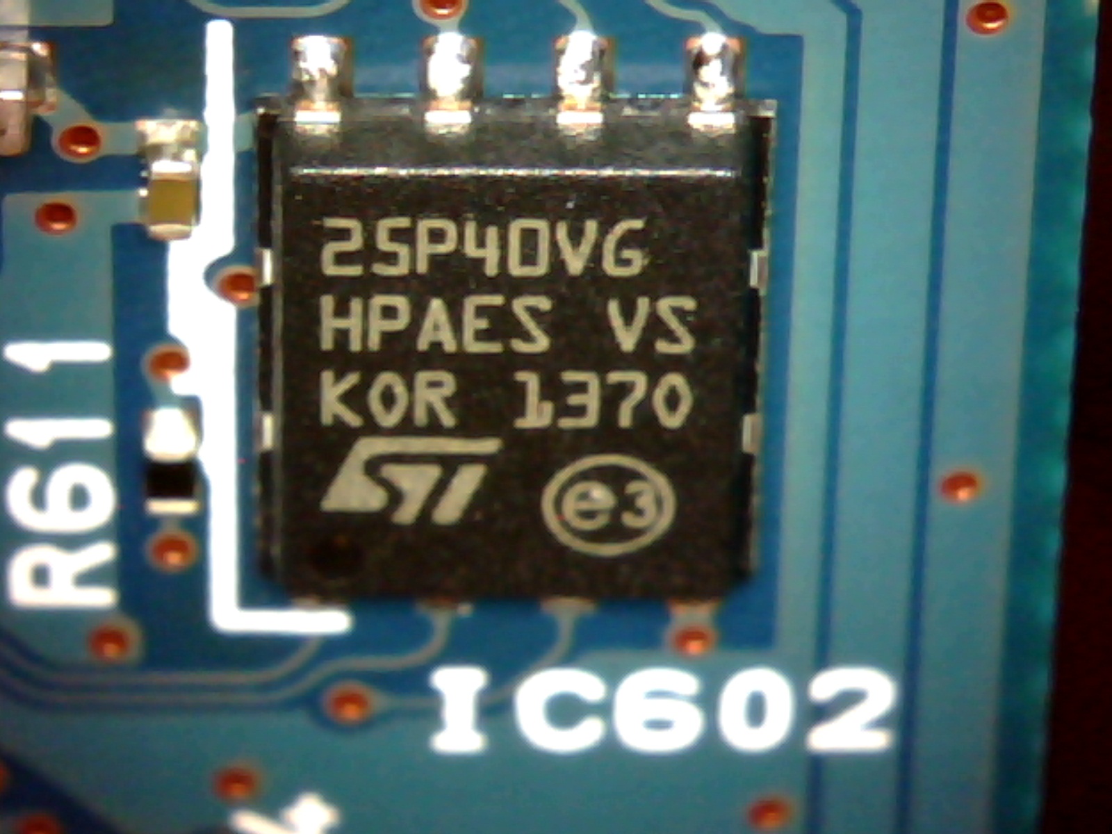

Much of the info on the board is generic, its the on-board adaptives that are important. there should be an external ROM at 'IC602'. Assuming the geometry of the both boards look the same, and are from same series of drive, swapping this adaptive chip should be ok.
You should be very careful though. Damage the ROM chip, and its unlikely you can reach your data. also, there are various faults which can be easily mistaken for faulty PCB, you should really write more information here and it might help identify the real problem, or confirm a PCB related one.

Yesterday a customer brought me exactly the same drive with exactly the same symptoms!
As hddguy said, IC602 is the ROM chip:
From your experience and your knowledge, could be a product line faulty heads or a specific component failed at PCB?
Two same cases with same symptoms aren't too rare for heads or media problem?
