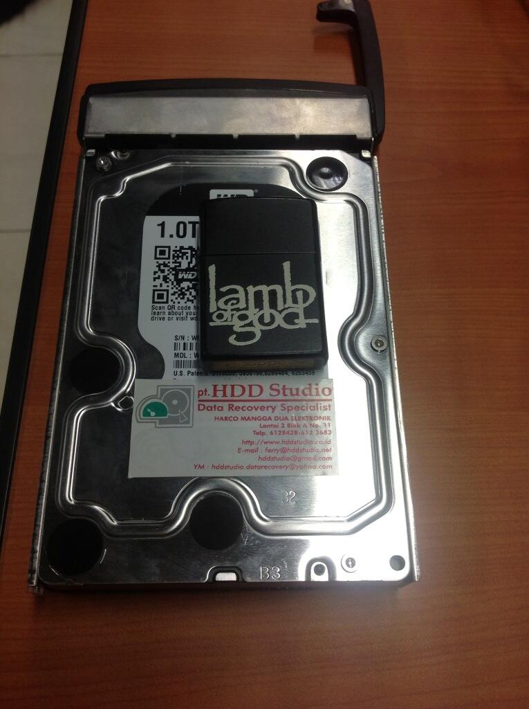

Yesterday, I've bought a harddrive labelled as WDC DIablo 3D. Is it an enterprise level harddrive? Or its just upgraded firmware? I see that the harddrive label says that the harddrive are Desktop Drive. Here is my info from hdparm :

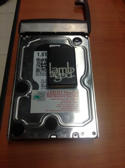

Could we see a photo of the label?
I checked your serial number's warranty status here:
http://support.wdc.com/warranty/index_end.asp?lang=en
S/N - WCAW36378979
Model number - WD1002FAEX-00Y9A0
Product Name - 1TB WD Black Hard Drive
Exp Date (MM/DD/YYYY) - 10/12/2018
ISTM that your drive is a fake. AIUI, a working drive should not report its family code (Diablo 3D). Moreover, it looks as if you have a Caviar Green, not a Black. A WD1002FAEX belongs to the Tahoe 2D family.
http://files.hddguru.com/download/PC-30 ... ahoe%202D/
http://files.hddguru.com/download/PC-30 ... ablo%203D/

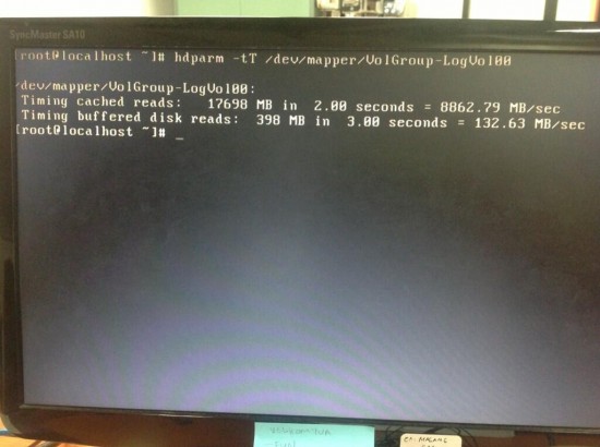

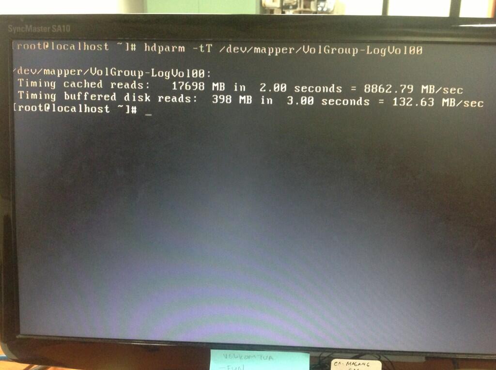

Can you show us a HD Tune read benchmark graph? The spindle speed and maximum transfer rate will help us determine what drive you actually bought.

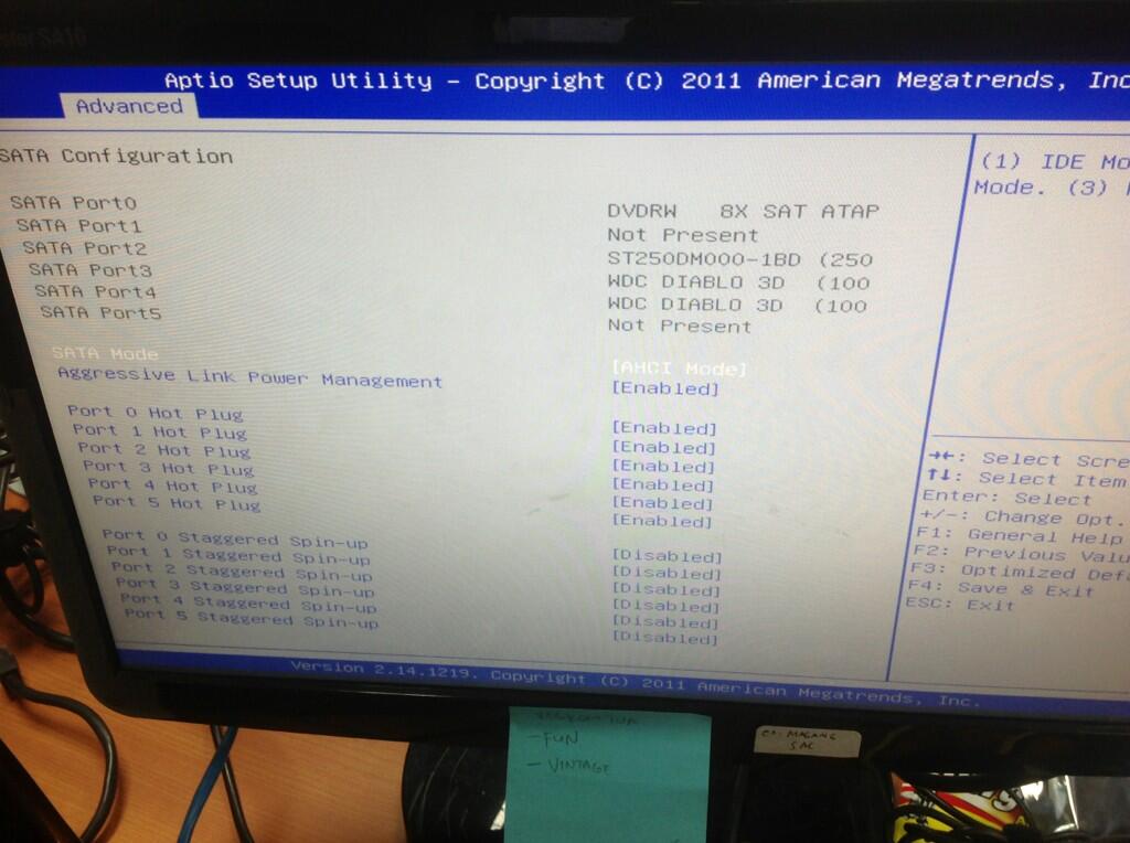

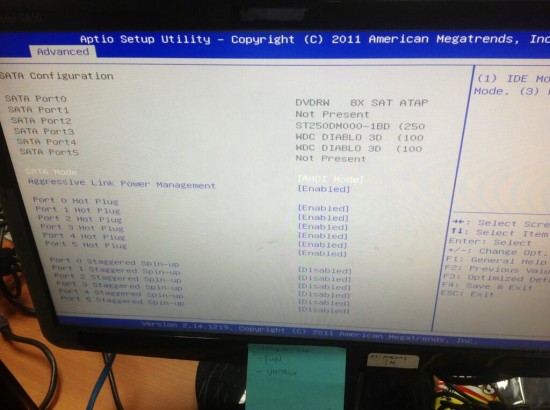

Here is my capture from BIOS and tested using HDParm.
Currently the drive installed with RAID-1 Array., and running as production environment. Is it safe to do some torture test again? Is HDTune can run on Linux OS ?

The difference is that your drive is a Green that has been relabelled as a Black. It may be hard for you to accept, but you appear to have paid twice as much money for a fake.
If you would just take the time to upload a HD Tune read benchmark graph, I will prove it to you.

einstein9, why do you not understand that the OP's drive is a fake?

Diablo 3D is an internal name it was never meant to be in drive's ID information
That means someone played with this drive's system area for unknown reason maybe even refurbished it.
Diablo 3D is a family that can be found in Green and Red series. It is not an enterprise drive.

The OP stated that "I've bought a harddrive labelled as WDC DIablo 3D."
Someone did more than just play with it or refurbish it.

By "more" you mean put a couple stickers on it? Well, yes, someone put stickers on it too

I've try using smartmontools, here is the test result
Short test report :
[root@controller ~]# smartctl -l selftest /dev/sdb
smartctl 5.43 2012-06-30 r3573 [x86_64-linux-2.6.32-358.118.1.openstack.el6.x86_64] (local build)
Copyright (C) 2002-12 by Bruce Allen, http://smartmontools.sourceforge.net
=== START OF READ SMART DATA SECTION ===
SMART Self-test log structure revision number 1
Num  Test_Description    Status                  Remaining  LifeTime(hours)  LBA_of_first_error
# 1  Short offline       Completed without error       00%       927         -
Long test report :
On going
