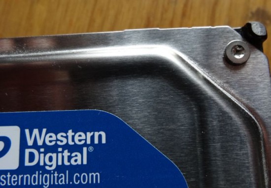

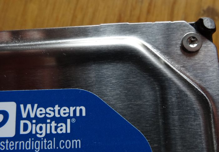

Might as well go gung-ho on that drive, but I can't tell: Are the screws tiny torxes?

yep, should be 7 of them, one is hiding under the cover. Make note of the torque settings and try and open it in the cleanest environment you can...
WHAT EVER YOU DO, DON'T TOUCH THE PLATTERS WITH YOUR HANDS.
