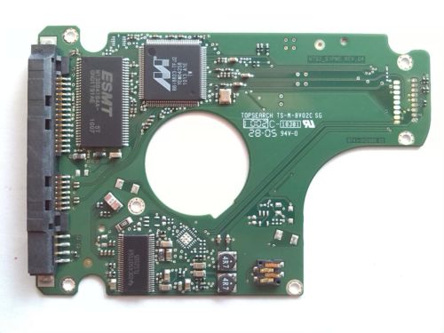

Could you upload a photo?
BTW, the ESMT chip sounds like an SDRAM, in which case there would be no need to swap it.

Thanks for the reply, here is a photo of the board (not my one) showing the ESMT chip, I'm thinking if I find another PCB with the correct chip I may be ok to retrieve the data.
Or am I way off the mark ? :-)

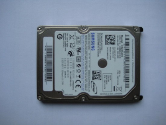

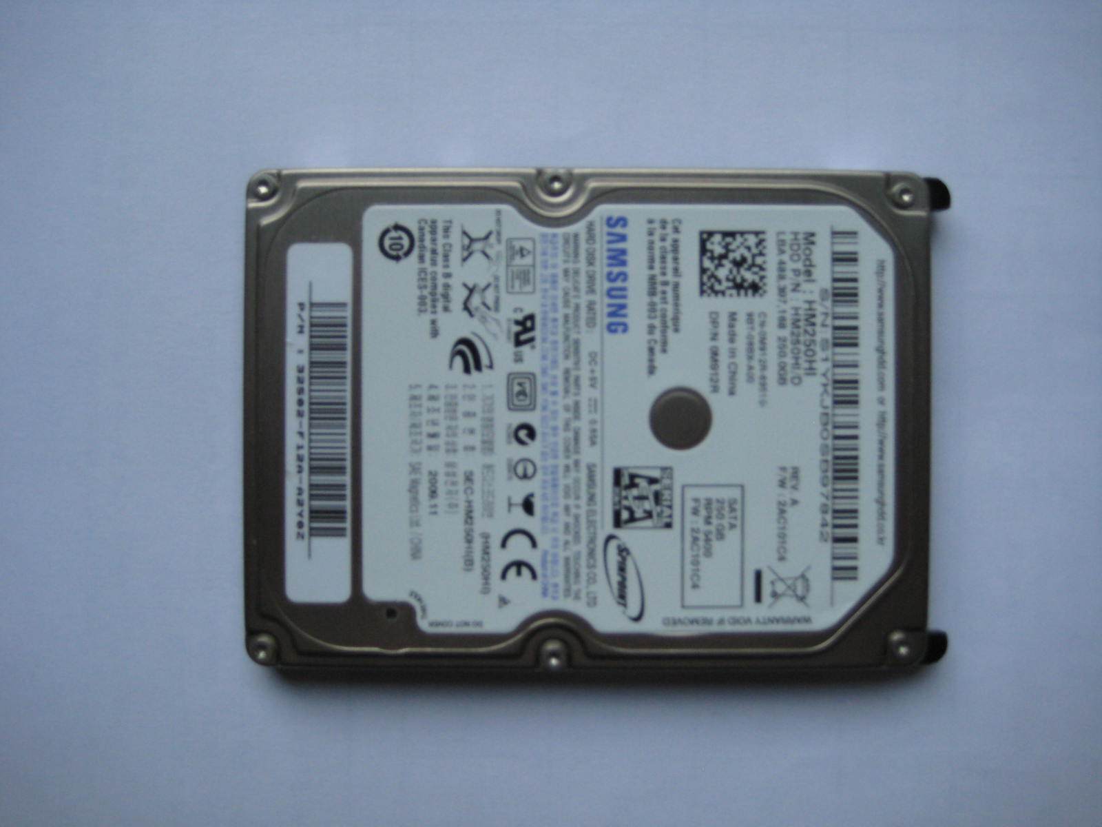

Can you post a photo of the top label of the failed disk?
Also, depending on what caused the failure, there could be additional problems that need to be recognized and dealt with.

hddguy - I'm afraid its not a brilliant photo , let me know if you want me to have another go :-)

fzabkar - I've tried to get a good photo but it's pretty bad tbh ..
Its basically identical to the first photo but with damaged components around one of the chips, I'll have another go and see if I can improve it ..

PostPosted: October 24th, 2013, 14:17
That's correct.
Also this PCB does not have an external ROM chip, the adaptive data is inside the Marvel MCU chip, so you'll have to either find a PCB from a drive with the same Firmware version (and head map, as from memory these usually 3 head drives so they can differ from drive to drive) or seek pro assistance.

PostPosted: October 24th, 2013, 14:20
You may be lucky, the FW version appears to be on the drive label (they usually aren't labelled with this info), although the photo is pretty blurry. So if you really wanna try DIY then you can try and find a suitable donor and try your luck!
