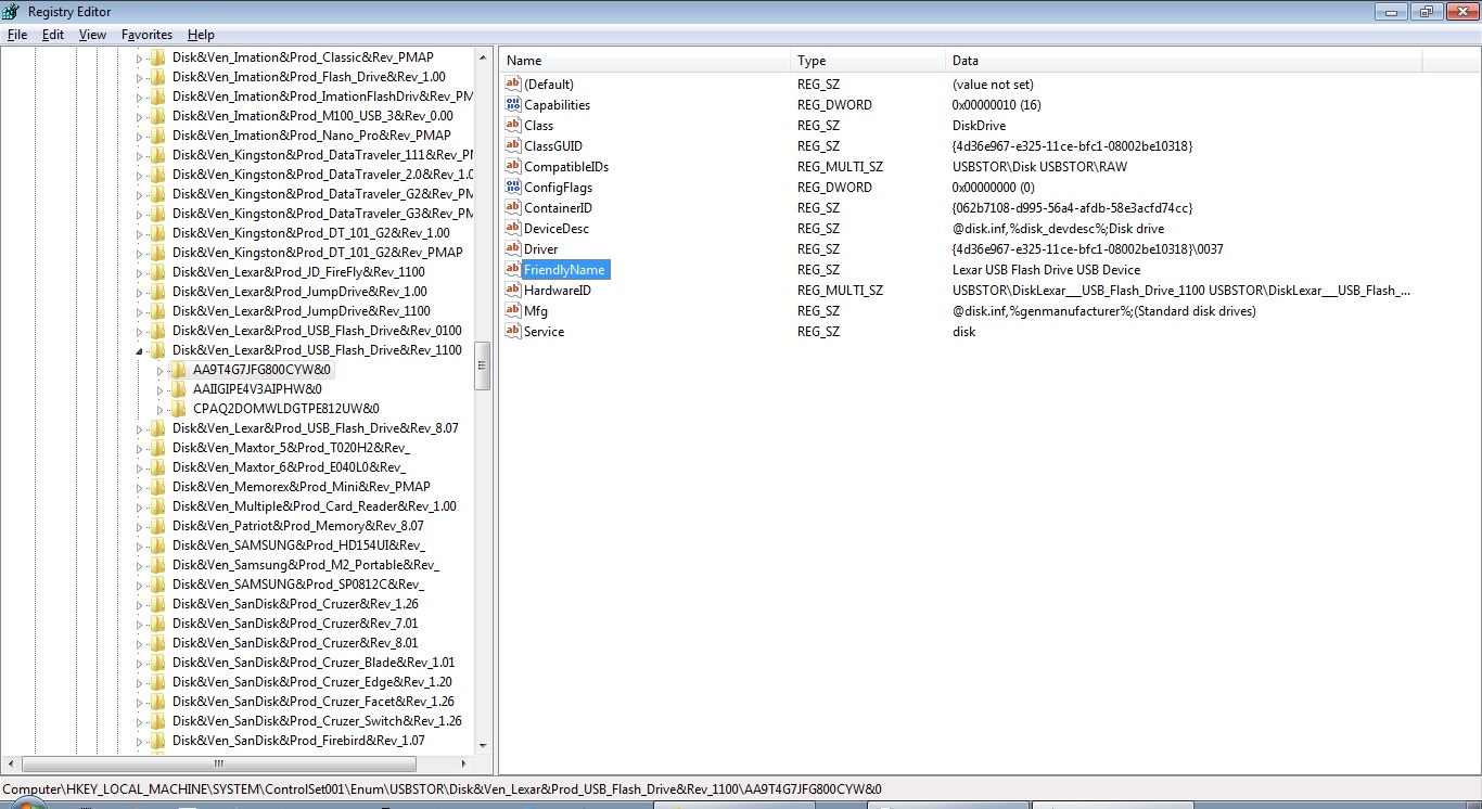

What you could do is possibly find the USB device info string in the windows registry, on a PC that this HDD was connected to when it was in the enclosure. At least you might be able to find out what the enclosure was.
Try keys like
HKEY_LOCAL_MACHINE\SYSTEM\ControlSet001\Enum\USBSTOR

The easiest way to check what external model the drive came from is to check with the warranty site.
