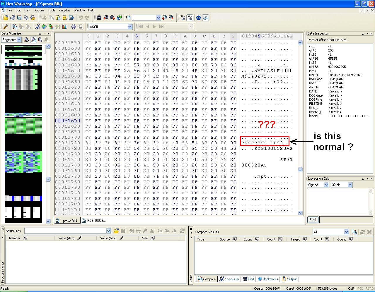

i've this Barracuda 7200.12
Model: ST31000528AS
S/N (3 digits): 5VP.....
FW: CC34
DATE: 09357
PCB: 100536501
The initial issue of this drive was "bad sectors"
I was cloning it in DE, when i was close to finish cloning, suddenly the drive began to cllick, i turned off and powered on again but the drive keeps doing head clicking sounds after good calibration sound.
I'm not sure is a head problem this time, because a bad head drive should do click-click-click and the spin down, but my drive does first calibration sound then double click sounds (cli/click- cli/click-cli/click) and doesn't spin down.
I think is a SA problem, or ROM got corrupt, please can you help me to understanf if the ROM got corrupt?
ROM ST31000528AS.rar [439.42 KiB]
Downloaded 681 times
My firmware database:

Is this rom corrupted as i think?

Black ST can you tell me if the rom is ok or not?
I think it's strange where it says CUT2 (look the picture in the 1st post), what do u think?

I would be very surprised if the MCU code didn't first check the ROM for consistency before transferring control to it. In fact I would expect that the ROM would be checksummed.
You could test for this in two ways. One way would be to modify the model number or serial number text strings. Then observe the terminal for a checksum error.
A second, more elegant way, would be to get hold of a working drive and use a tool such as HDAT2 to enable Power Up In Standby (PUIS). Dump the ROM before and after doing this. The difference between the two dumps should be in the PUIS flag and in the checksum byte(s). You would then modify the checksum byte(s) without touching the code. If the terminal now reports a checksum error, then you can be certain that a bad ROM will not go undetected.

I have just started to analyse a Seagate ROM. It appears that it consists of several modules, each with its own checksum. I can show you the locations of the checksum bytes, if you wish to experiment.
