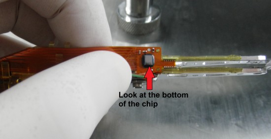

Hi all,
Does this little circule mark mean that the preamp chip is burnt?
Please notice at the bottom of the chip.
Best Regards,
 Post subject: Re: Does this mark mean that the pream is burnt? + picture
PostPosted: November 16th, 2013, 18:44
Unclear picture : can be the FC seal but can be something else.
If you have a DDA you can CLEARLY understand if there is output (and the quality of it) from the preamp, otherwise you can always try a headswap , given that the stack has already removed....
Actually this is very clear picture. This is what I see with a naked eye.
I tried heads swap and currently the drive is looking for building the NV-RAM since the drive kept being on BSY state.
I suspect that the pc technician who brought in the drive tried to replace the original PCB with some donor and forgot to put it back.

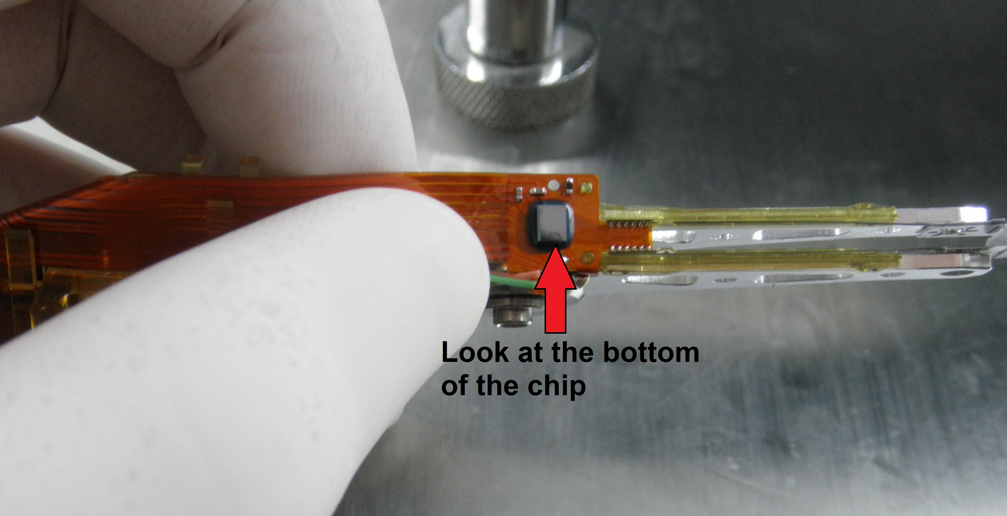

Did you click the image then click it again? Here's part of what I see when I do that...
PostPosted: November 17th, 2013, 9:41
Joined: August 6th, 2010, 12:56
Posts: 214
Yes, This is what I am talking about.

For the first question, is the mark on the preamp means that it was burnt?
PostPosted: November 17th, 2013, 10:18
Not sure, but you have not told us; 1) the actual initial symptoms or 2) whether you've tried the heads in the donor
In my experience a bad preamp would cause the drive to spin up and come DRDY, but close listening to the drive would reveal that the heads do not move out from the ramp.
Hope it helps?

Case solved.
Only the picture is the issue now. Is this mark means that the preamp is burnt?
PostPosted: November 17th, 2013, 17:12
Posts: 17386
What I would do to answer that question is to measure the DC voltages at the HDA contacts of a working PCB when attached to your donor headstack, and then compare them against your patient headstack. It won't give you a complete picture, but it should find any obvious faults.
PostPosted: November 17th, 2013, 20:00
Posts: 214
Solved too.
This mark doesn't say that the preamp is burnt.
The heads are fully working on another drive..
Thanks for your comments.
