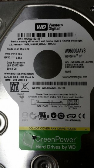

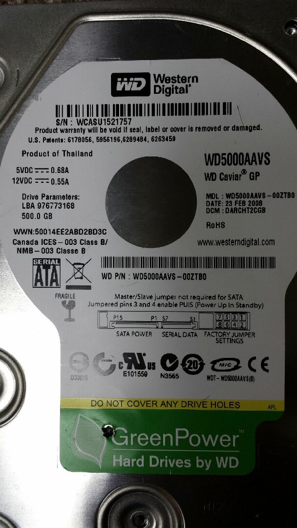

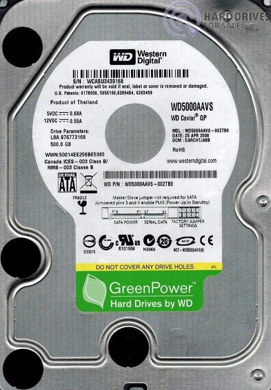

Hey everybody I had to create a new forum account...
Failed drive: wd5000aavs-00ztb0 DARCHT2CGB Thailand 02/28/2008
Donor drive: wd5000aavs-00ztb0 DARCHTJABB Thailand 04/25/2008
The failed drive was new in late 2009 and used about 10 hours. It was shutdown clean and heads parked on loading ramp when dropped four feet onto asphalt. Sliders/heads were loose inside case when opened in lab.
I have performed about 90 mechanical/open recoveries resulting in about 80 complete recoveries plus a few partials.
Drive DCM seems rare and it returns zero results in search engines. This donor is the closest we have found in a year. If there is a more suitable donor, please advise.
Thank you!

 Post subject: Re: WD head stack replacement compatibility
PostPosted: November 19th, 2013, 11:34
Posts: 2984
DCM has little relevance here, you cannot determine head compatibility on ROYL based on DCM
PostPosted: November 19th, 2013, 11:40
Agree, that donor should be fine.
There will be underlying issues no doubt though :-(

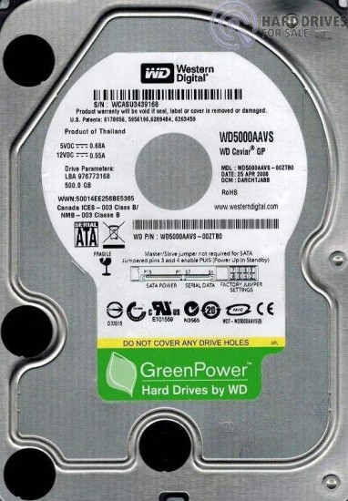

Choice of donor drives:
Failed drive--: wd5000aavs-00ztb0 DARCHT2CGB Thailand 02/28/2008 WCASU1521757
Donor drive 1: wd5000aavs-00ztb0 DARCHTJABB Thailand 04/25/2008 WCASU3439168
Donor drive 2: wd5000aavs-00ztb0 HARNHT2CHB Thailand 01/24/2008 WCASU0953137
Donor drive 3: wd5000aavs-00ztb0 HHNCHTJMHB Thailand 04/25/2008 WCASU3486478

Dear Friend DefinityComm
My Opnion Is Closet One For Head Stack Is Donor drive 2: wd5000aavs-00ztb0 HARNHT2CHB Thailand 01/24/2008 WCASU0953137
Your Friend
Jignesh Pankhania
PostPosted: November 20th, 2013, 14:57
@DefinityComm
DCM is the least of issues with regard to challenges in the next recovery steps, if you will, because there are high chances the swap will not work. Matter of fact, it is possible that any other of those donors could be more compatible. One can't precisely say for sure as there are other factors involved. But, like Jignesh said, maybe d2 is the one to try first, I guess..
