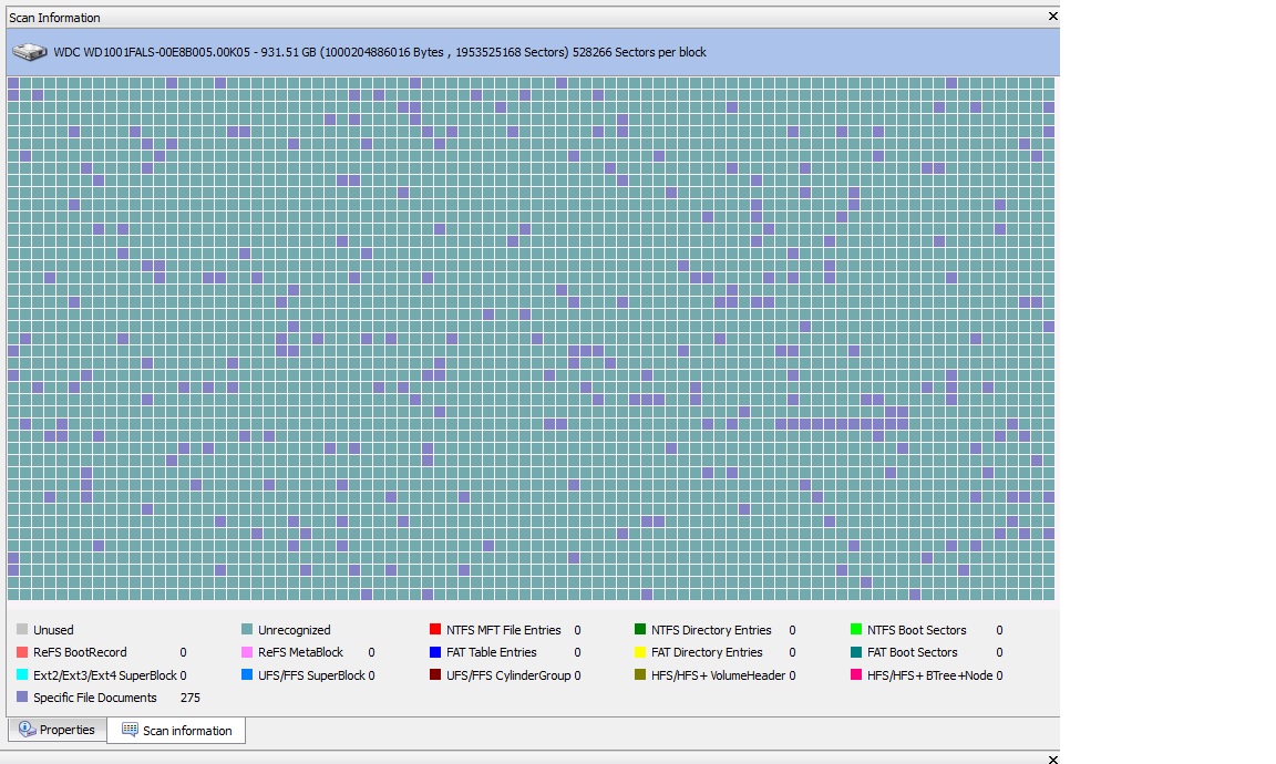

I have a 1tb harddrive which was divided into 2 partitions, 50/50. One for movies and stuff and one with the system itself.
Decided to decrypt the harddrive - which was encrypted with truecrypt - via a rescue disk created afterwards (done this before, no probs). Took a day+ but completed with success "The disk have now been fully decrypted." or so. So I pressed ESC to go back and then finally shut it down.
I had another computer running at the same time so I decided to connect the now decrypted harddrive while the computer was on (done that before.. if i remember it correctly. not sure if I had a sata hot swap driver/program installed tho).
The harddrive didn't pop up, not even that the "device has been found".
Restarted the computer and now drivers for the device was automatically detected as it should. But it wouldn't show as partitions under "My Computer". Went to the disc management and there it is.. Showing all gb's as "unallocated"??
Now: What should I do from here?
I tried TestDisk to do a deep search for partitions tables but it didn't find anything.
If I right click on the disc under management there is no option available, everything is greyed out.
When I start with rescue disk again it will show "Incorrect password" which of course is not true. But I guess this shows up cause it really is 100% decrypted.
Thinking of buying 2 x 1TBs disc in order to do a full clone etc. But that isn't free :p.
Thanks in advance!!

I would try to scan the drive with R-STUDIO and do file carving if needed.
If you don't clone the drive make sure that you DON'T WRITE anything to the damaged drive. Don't recover files to that drive either.
At any rate if my guess is correct and the decryption proccess was wrongly done because of the change/hot swap of the drive, at this point i would say that you would have a drive with random patterns like "noise" that is not a "correct encryption" neither your original data. If you have a blob of gibberish that can't be decripted it would be like having an encrypted volume without knowning the key ..... pray that it's not the case.
Best regards and good luck.

Alrighty. So from that clone, I can do exactly the same as with the real harddrive. I.e recover files from it aswell? Thinking of doing it then.. But, free is always the best ;-).
Yes, the harddrive is only a couple of months old. No problems with it really.
Had a scan going already with R-Studio. See attached file for the poor results it gave me.
Gahh so annoying.
 Post subject: Re: Decrypted harddrive, now shows as unallocated? [truecryp
PostPosted: October 29th, 2013, 19:34
Based on the R-Studio snapshot, it looks like encrypted data.

Oh my god... So "If you have a blob of gibberish that can't be decrypted it would be like having an encrypted volume without knowning the key" = the case for me now?
Will it be impossible to rescue the content? :'( can't believe this is happening.... :(
The files r studio finds is big chunks of swf files etc. I.e probably encrypted shit.
How can it be wrongly decrypted/how did this happen?

Downloaded WinHex and as you said it would be, just gibbberish @ the faulty disc. Even tho the other harddrives I opened with WinHex had some wierd characters/text aswell, there is still some "real letters"/readable text somewhere in there at the beginning. Some standard Windows error messsage etc, which the faulty don't have - all I could see was "gibberish". So, I guess it's badly decrypted then. Don't know how that happened.. Hmmmmm...
