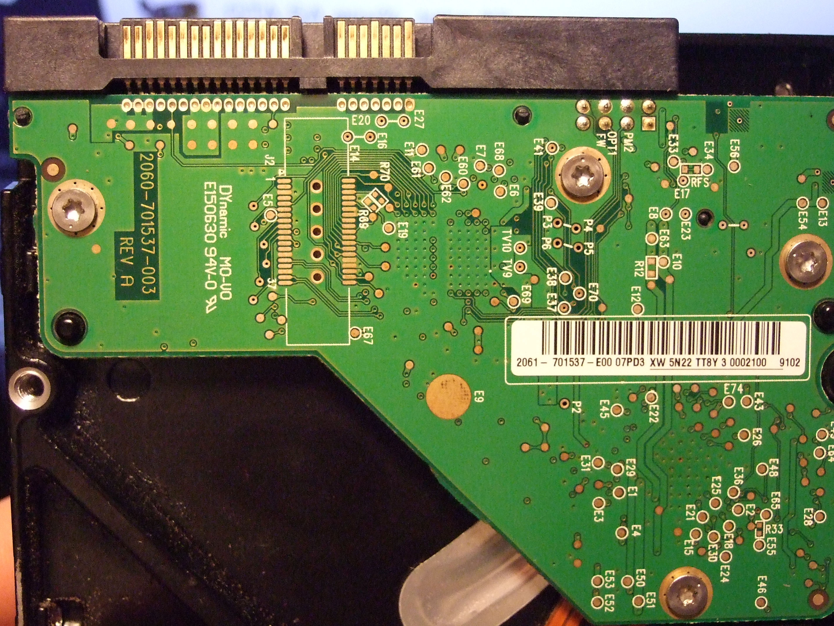

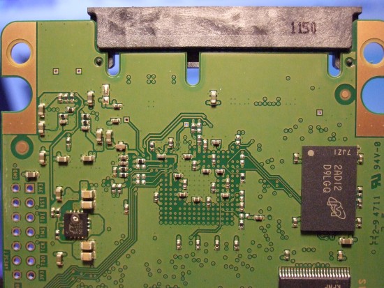

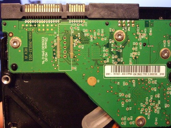

Hi, I've had this 500GB HDD for about eight years and after trying to diagnoise an assumed motherboard / PSU problem, this drive suddenly ceased to be recognised by any computer in the BIOS, Windows and piece of software on CD. When connected I think I can feel it spinning up and it gets pretty hot after ten minutes or so, I'm just wondering if there's any software I can use to possibly get it regonised again. I've read up on MHDD but never used it. I backed it up a while ago so I can't think of anything vital I've lost, but it would be helpful to know if there's something I could do to revive it briefly.

Could we see detailed photos of both sides of the PCB? Are there any heat marks on the foam pad?
The failure mode of the SSD may gives us a clue as to how each item failed.

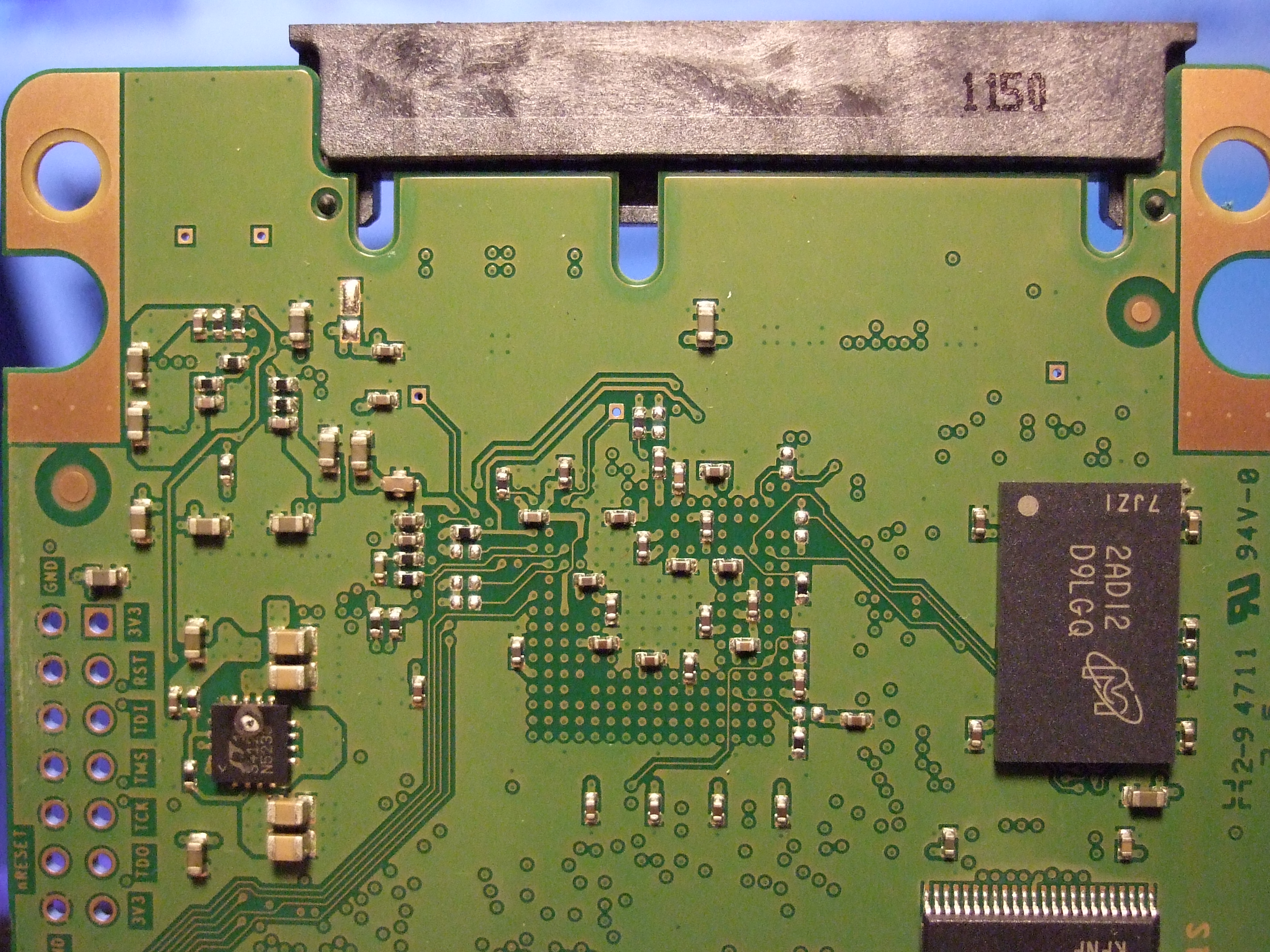

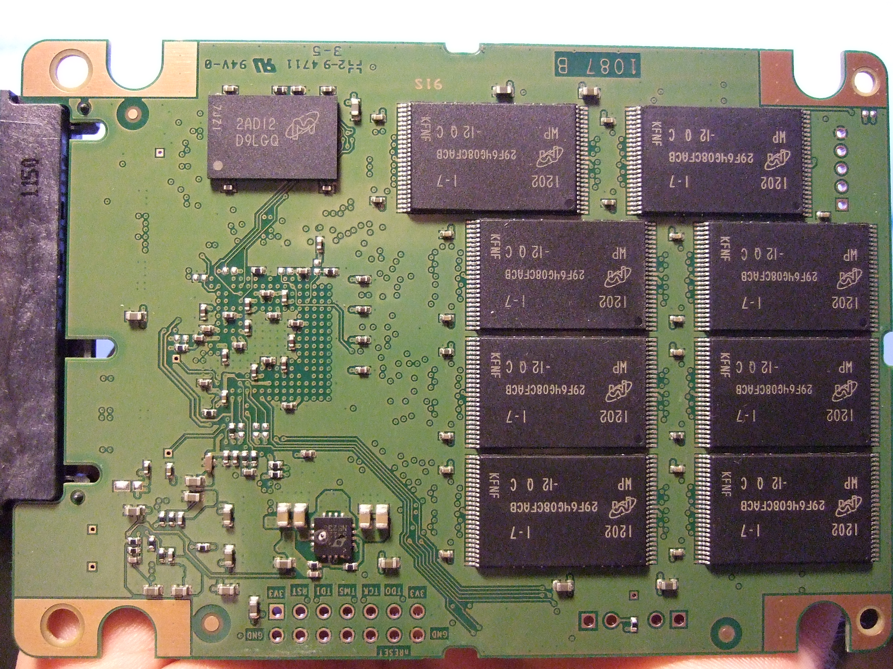

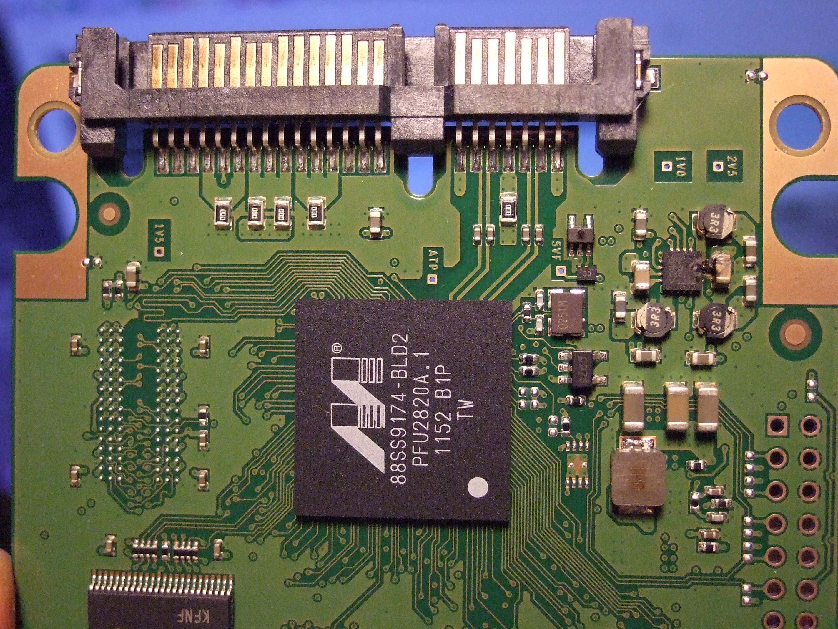

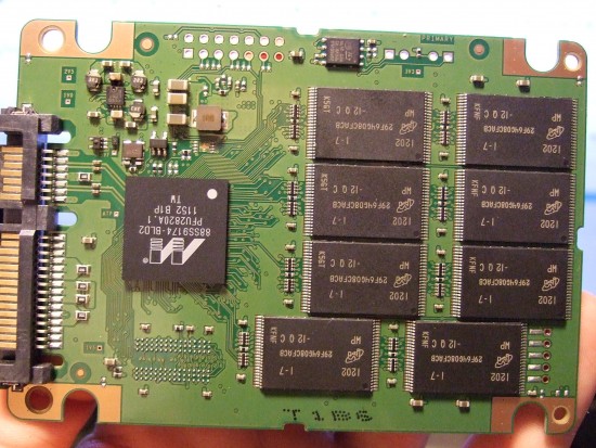

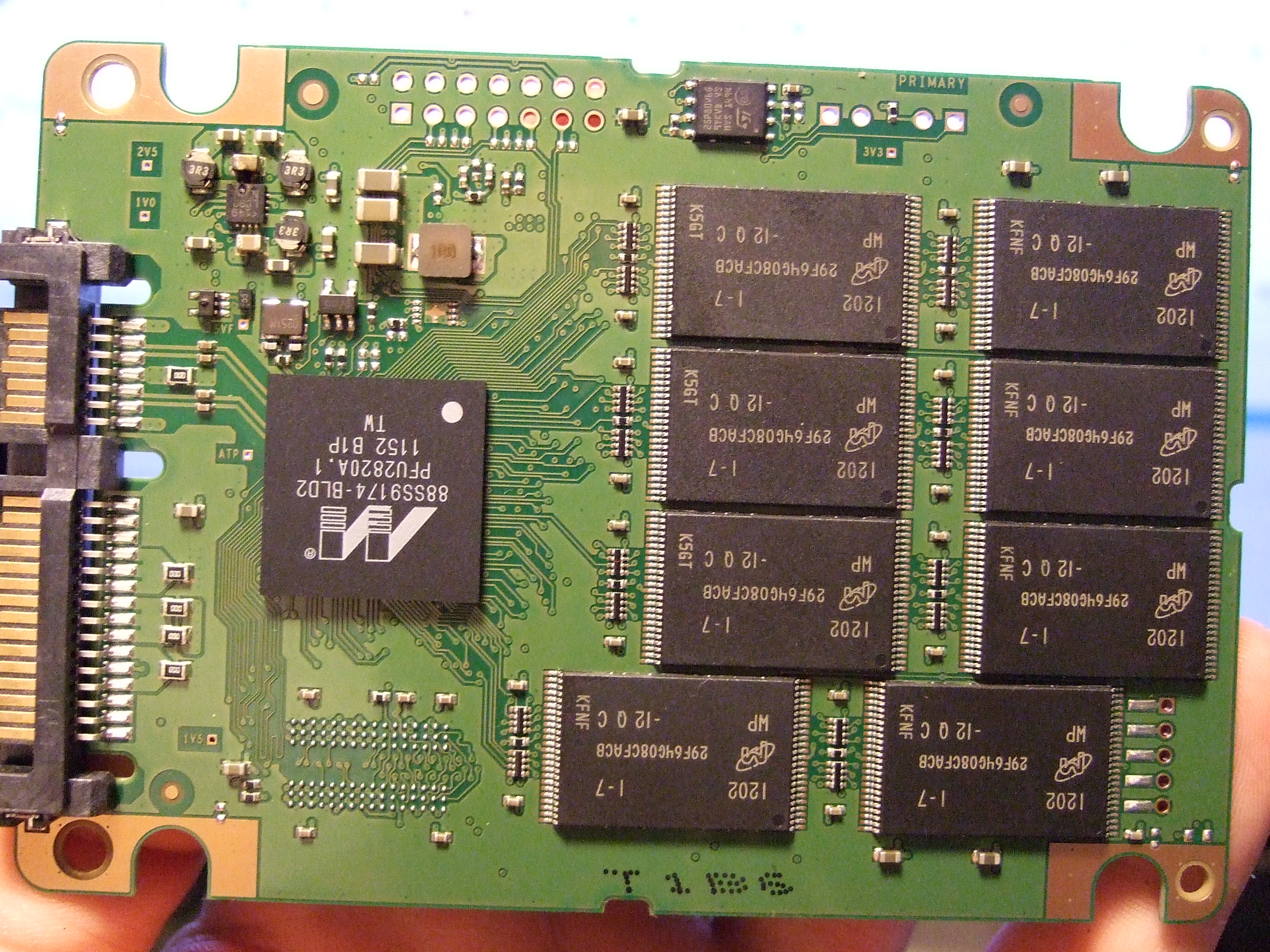

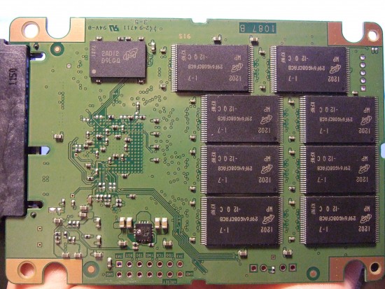

Here's the photos I could get. I don't have the right tools to unscrew the hdd pcb so can only offer one side sorry.
There's four photos of the ssd.
File comment: hdd
File comment: ssd back
File comment: ssd front
File comment: Back of ssd, close up
File comment: Front of ssd, close up

Every chip that was powered from the +5V supply has been destroyed. This is consistent with an overvoltage event on this rail.
Be aware that swapping modular PSU cables between different PSUs often causes these problems. This is because the pinouts are not standardised. It is quite possible for +12V to be impressed on the +5V pins in such cases.
This is what I expect you will find on the component side of your WD PCB:
Catastrophic failures in Western Digital PCBs:
http://www.hddoracle.com/viewtopic.php? ... 119&p=5033

I remember when the system suddenly refused to boot, during trying to diagnose previous errors, with the fans spinning up and then shutting down. I narrowed it down to the ssd, the system booted with a spare sata power cable (from the original box) but the ssd was dead. The system booted with the hdd attached but it was only after that I realised it was dead as well.

The SSD appears to have a short circuit on the +5V supply. This is what is causing the PSU to shut down. Typically there will be a short kick from the fans prior to shutdown.
BTW, if your HDD is spinning, then it will have some other problem.

So it may be worth running MHDD on the hard drive to see if it can pick it up?
