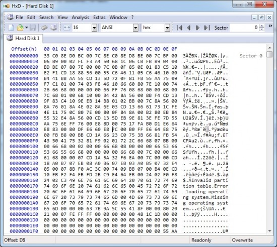

I have a drive here that I want to take an initial look at.
Using a USB-SATA adapter, drive is detected correct model in win, but says "needs to be formatted"
Terminal Output is:
Rst 0x20M
(P) SATA Reset
can cntrl+Z and get F3 T> prompt.
The drive sounds fairly normal, no beeping, no scratching/screeching, and fairly normal bootup seeking sounds.
What commands can I use to get an idea of possible problems?

Are you certain that the problem isn't logical rather than physical?
Can you read the contents of sector 0 with a disc editor?

Hi, Very good point. Should know better than to assume.. in fact:
-Disk management doesn't see it
-I can use HxD to open the disk and view sectors
-Device manager detects it with correct model, though populating the Volumes tab gives a capacity of 238473MB. I dont know how it is partitioned(if the partitions are intact)

That's a regular MBR and a partition table with a single NTFS partition.
80 20 21 00 07 FE FF FF 00 08 00 00 00 48 1C 1D
The NTFS volume begins at sector 2048 and has a size of 0x1D1C4800 sectors.
0x1D1C4800 x 512 = 250 057 064 448
0x1D1C4800 x 4096 = 2 000 456 515 584
What has happened is that you have removed a 2TB drive from an enclosure whose bridge firmware was configured with 4096 bytes per sector. By installing it inside a PC, or attaching it to a 512-bytes-per-sector bridge, you have exposed the drive's 512e sectors. This means that sector 0 will still be in the same place, so the partition table will still be accessible. However every other sector is now displaced by a factor of 8. This means that Windows cannot find the boot sector (2048) and therefore complains that the partition is not formatted.
In short, reinstall the drive inside its original enclosure and you should have access to your data. At the moment you have a 4KB file system attached to a 512B bridge. When the drive is inside the original enclosure, the OS will see a 4KB file system attached to a 4KB bridge.

I expect that your present configuration will have an NTFS boot sector at LBA 16384 (= 2048 x 8).
