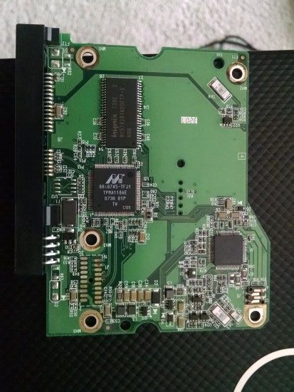

Can you take the PCB off the hard drive and take a few images to post online. It might be a faulty component on the PCB thats overheating and cutting the power quickly.
Images would be helpful...

Can you provide some images of the PCB board, more than likely some component is getting too hot. If you provide some images of the PCB board we can go on from there.

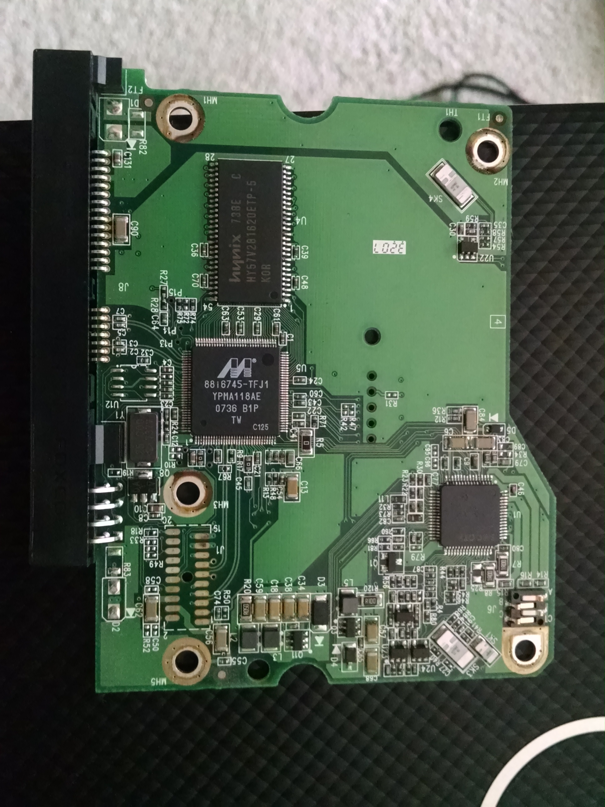

So yea it's been a while but I finally got a picture of the underside. It's attached to this post.
I also had another thought and wanted to run it by you- I have two of these hard drives and the other is still working fine. Is it worth the effort to back that one up, then swap these boards to see if the bad one will fire up to get the data off of it as well?
Appreciate any insight and thank you for what's already been shared.
