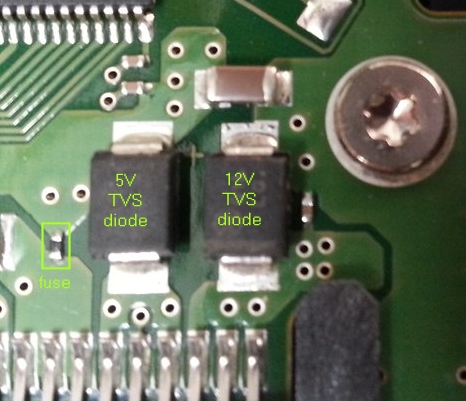

hello,
I had a faulty drive tray, that shorted out 3 drives. The problem has been fixed, but I would like to try to salvage my stuff on the drives. I understand I may make the data irretrievable, and I am ok with that. I figure I have nothing to lose, and an education to gain.
I read through the forum and performed what tests I could. I tested the TVS and they appear faulty. They are not "open" in any direction,. I read resistance in both directions. I cannot locate the "fuse" or 0 ohm resistor. The one I did find, may be OK (measured .3ohms)
I have not continued (cutting the TVS) as I am not sure I have done enough to ensure the drive will turn on (eg I did not find the fuse)

Remove the 5V TVS diode and flow a blob of solder over the fuse. Then measure the resistance between the +5V and Ground pins at the SATA power connector. If there is no short circuit, then power up the board on its own. If OK, then try it on the drive.
Alternatively, you could test the HDD by bridging the fuse with sharp pointed tweezers (after removing the 5V TVS diode).

Sorry, I am unsure which part is the fuse. Can you help?
is it this:
 Post subject: Re: HD154UI - Will not spin.
PostPosted: December 3rd, 2013, 17:16
Posts: 17341
I forgot to upload a photo. Sorry.

Thank you for the help.
If I short my leads my meter reads 000, across those the sata pin pairs (10-12 & 7-9) I read .447 ohms or 1.97 ohms, depending on the pair tested.
There is continuity, but some small resistance measuring between the 5v and gnd at the sata connector with the resistor fuse jumped.
The board is still attached to the drive.
How should I proceed?
This is what it looks like now: http://imgur.com/QcvebVb
