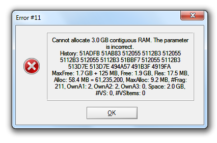

The matter of fact is that It's non-brand (CHINESE) 32 Channel DVR.
While opening the Disk on WinHex, following message appears...
Also attached first few sectors data here.

shahij wrote:
By the way, do you know Which & how many sectors gets changed after initialization under Windows 8?
I checked the binary dump
The drive has been initialized with GPT partition schema
That means first and last 16KB of data on the drive is modified
If some partitions were formatted than it's even more altered/modified/erased data
