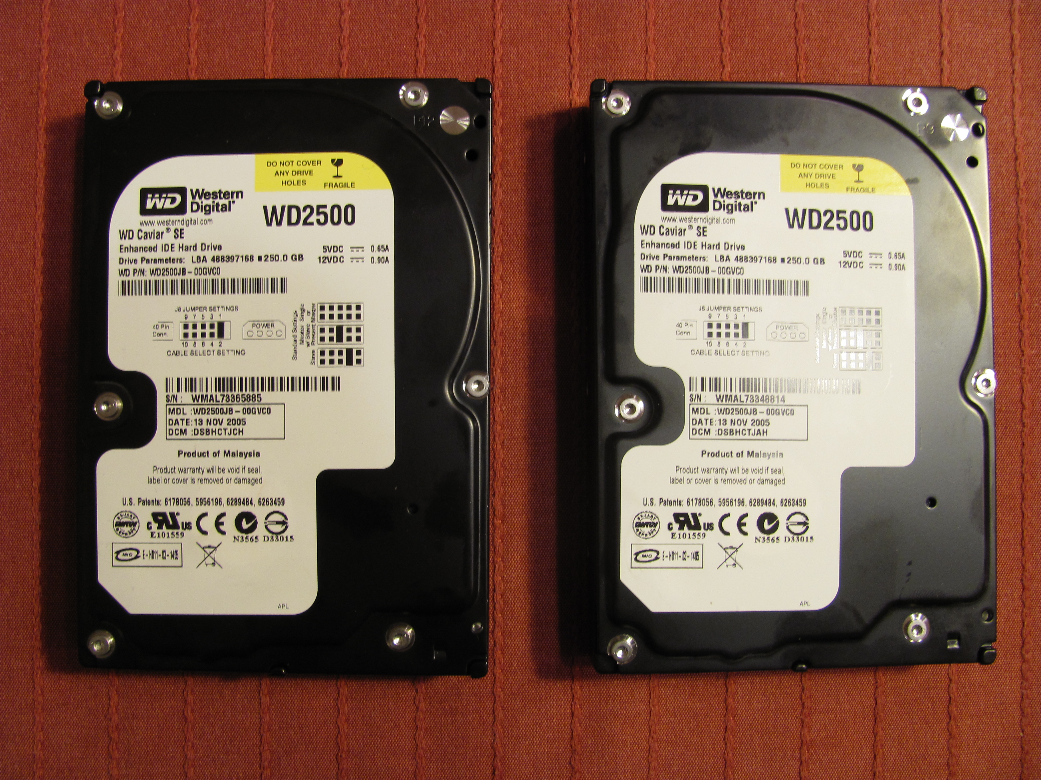

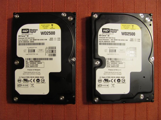

I pulled out the two disks from the enclosure, 2x250GB WD2500JB.
I removed the jumper and powered then separately with an IDE to USB device, none of the two disks seems to spin, neither is seen by the PC, and if I go to disk management, I can see the disk(s) but once I try to initialize them, I get 'device is not ready'.
Strange thing is that when I start them in their LaCie enclosure, they seem to spin (both) but cannot be seen, not even in disk management.
One important thing here: I do not care about the content, I had a backup so I just want to find out if I can recover those two disks or not.

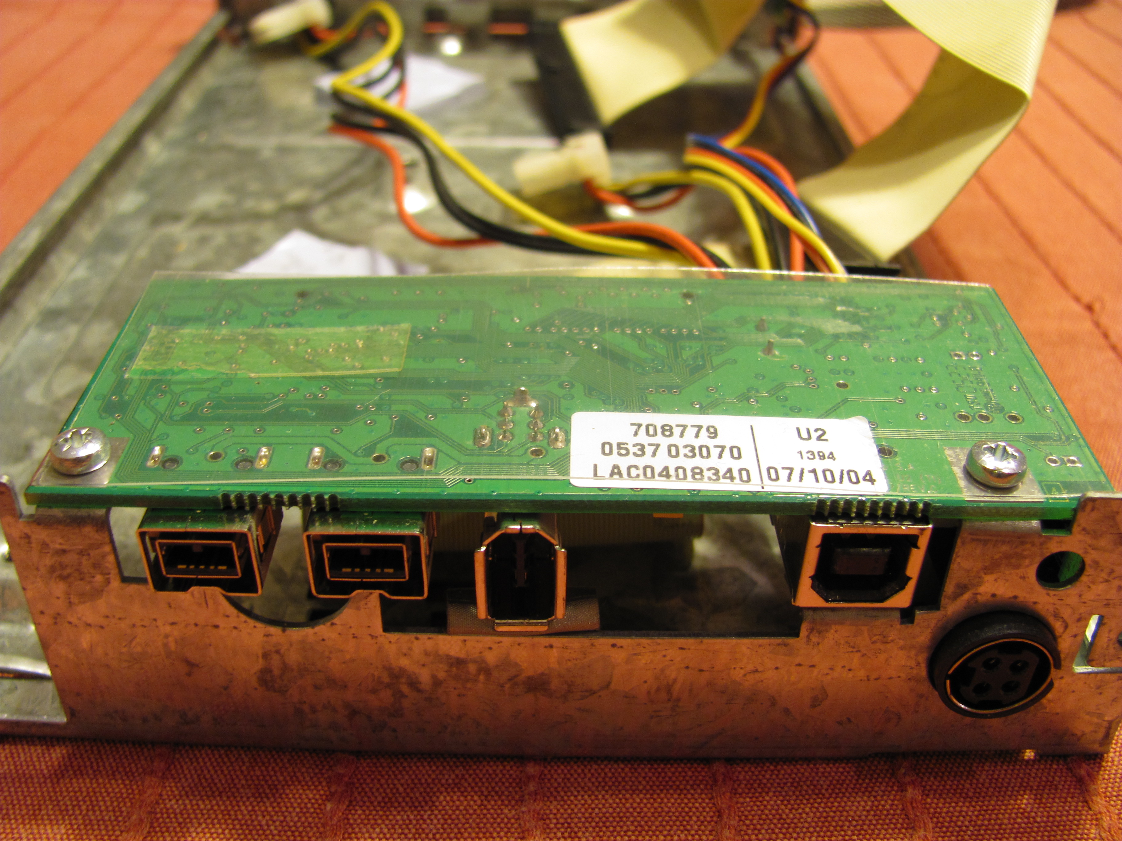

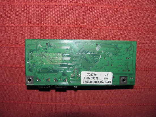

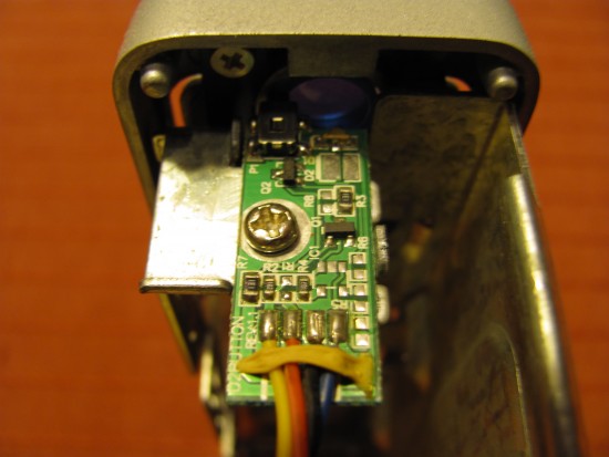

 Post subject: Re: LaCie Big Disk 500GB - FW800 & FW400 & USB2.0 - Is it de
PostPosted: December 14th, 2013, 19:22
Joined: December 10th, 2013, 21:03
Posts: 13
Location: Canada

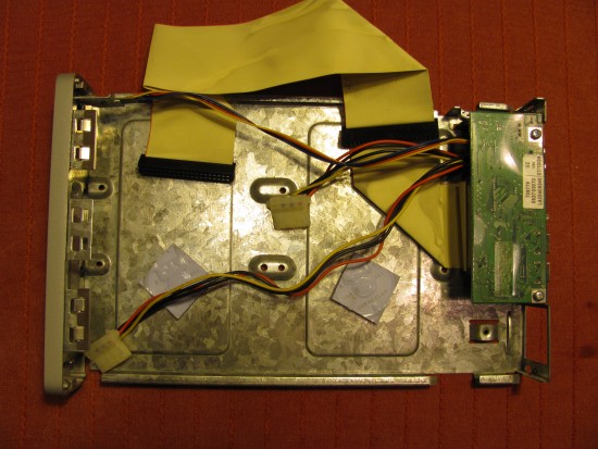

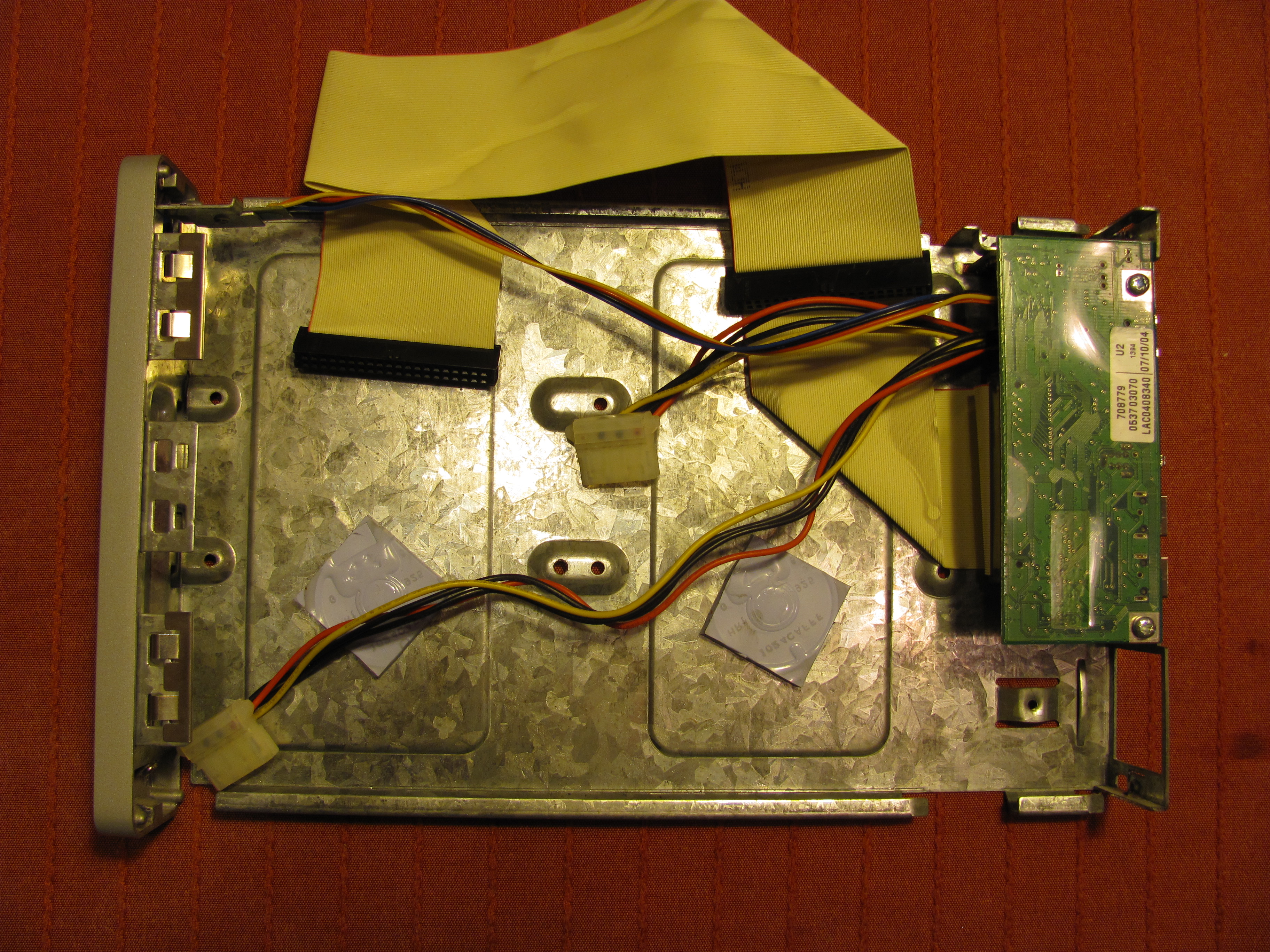

Both drives spin up without the 80-way ribbon cable and without being connected to the USB port.

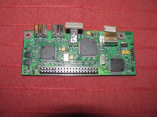

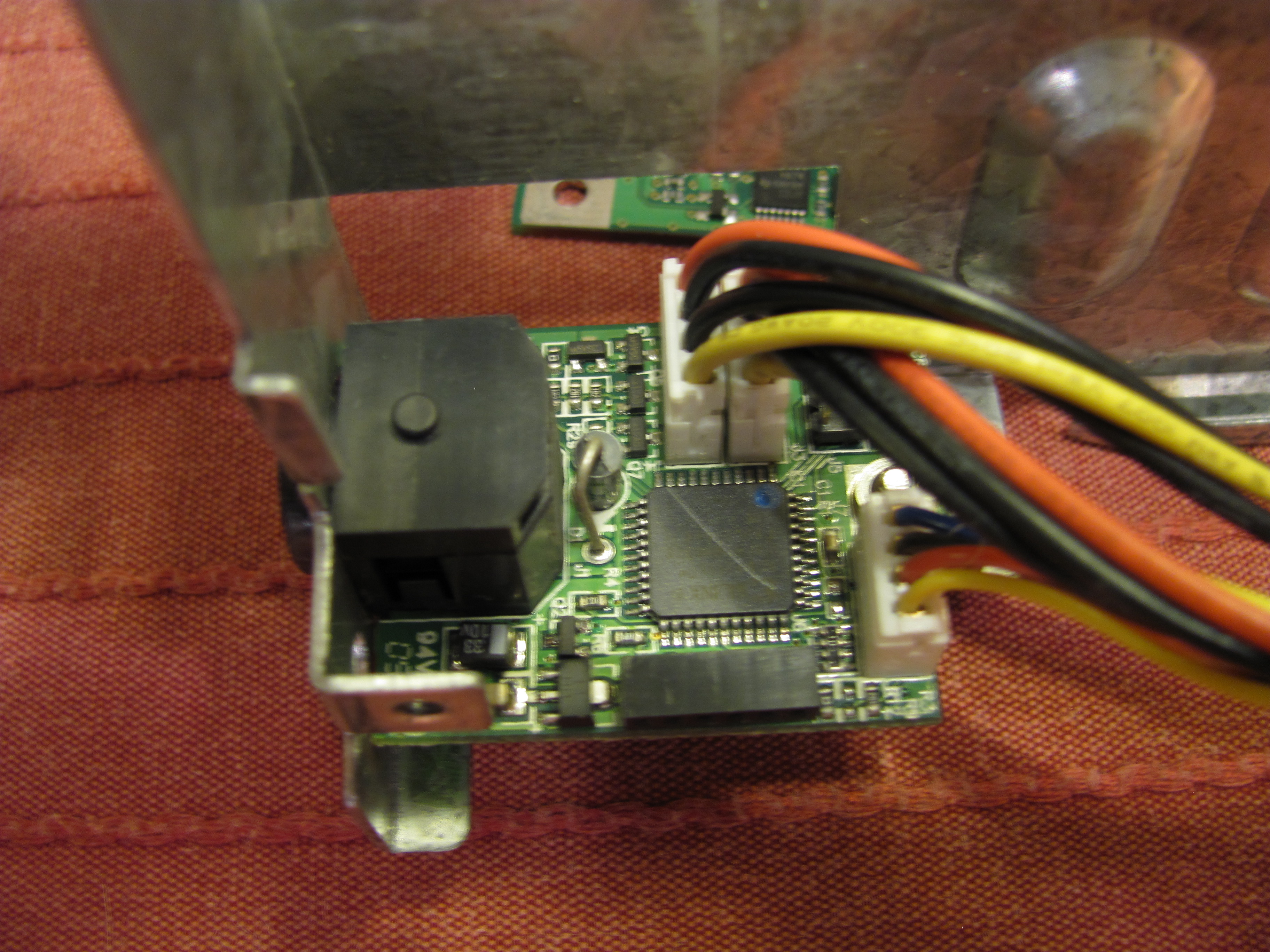

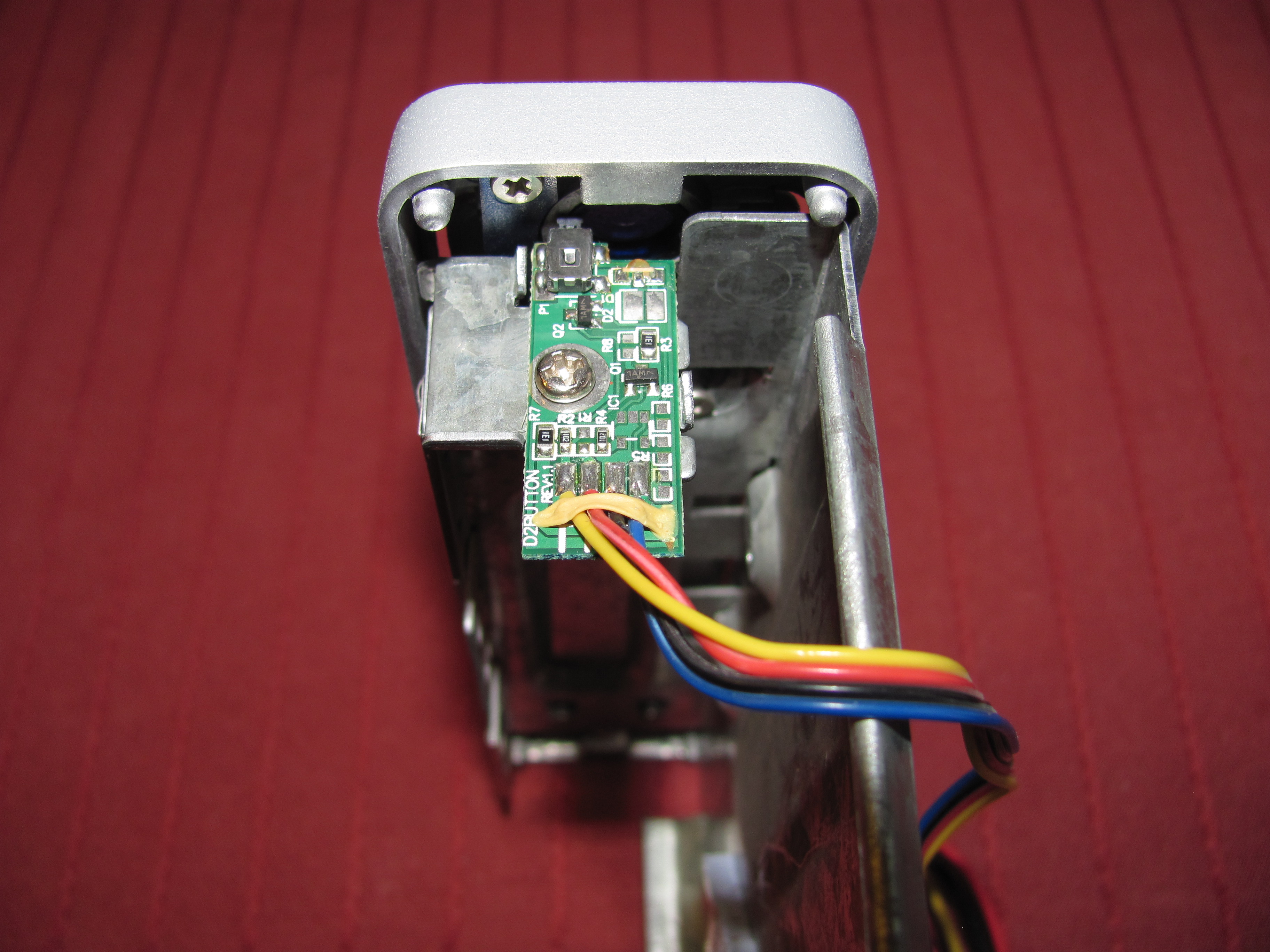

I took some pictures so that will be easier to see what's inside. :)
Alex
PostPosted: December 14th, 2013, 23:02
Posts: 17336

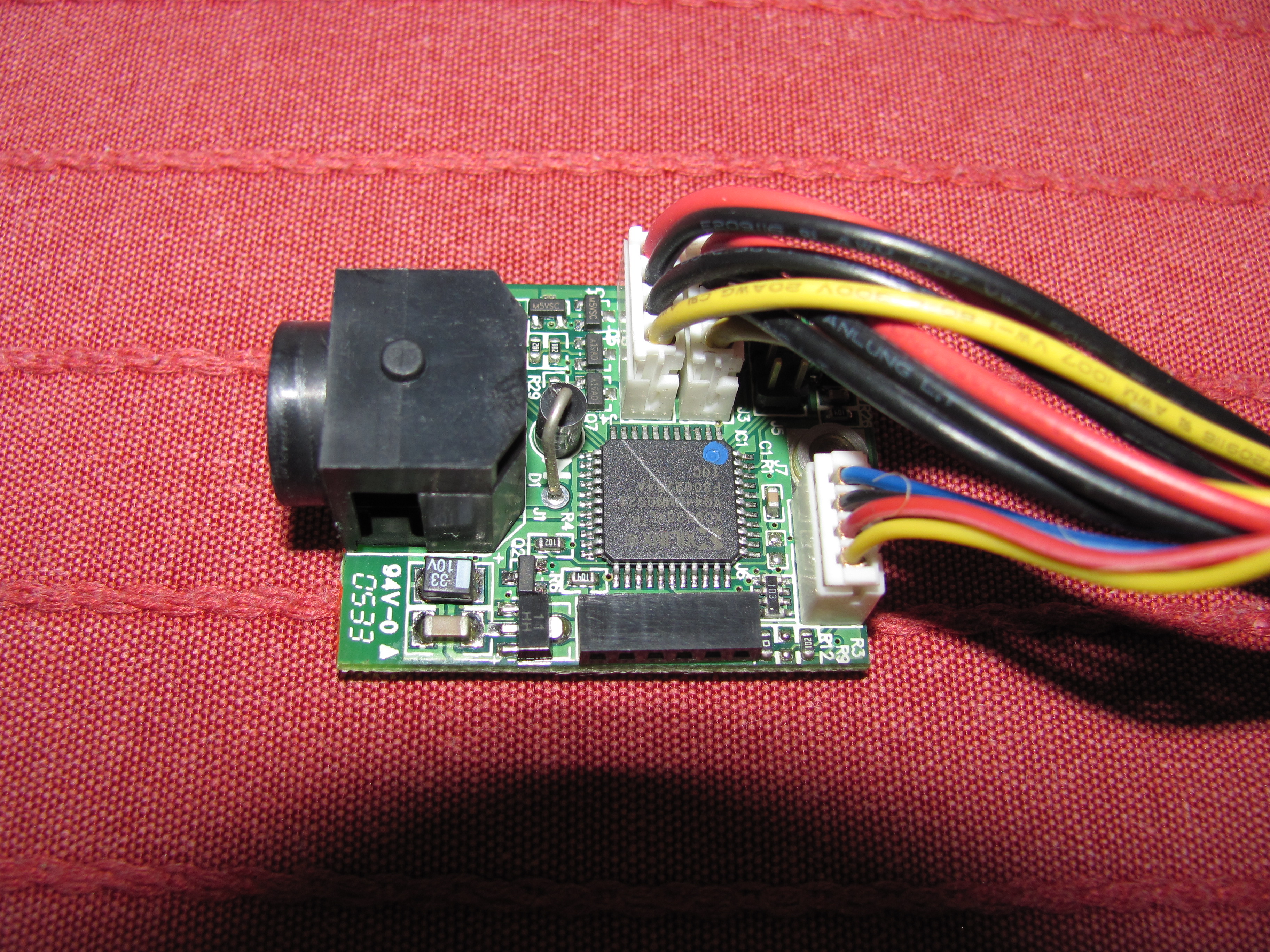

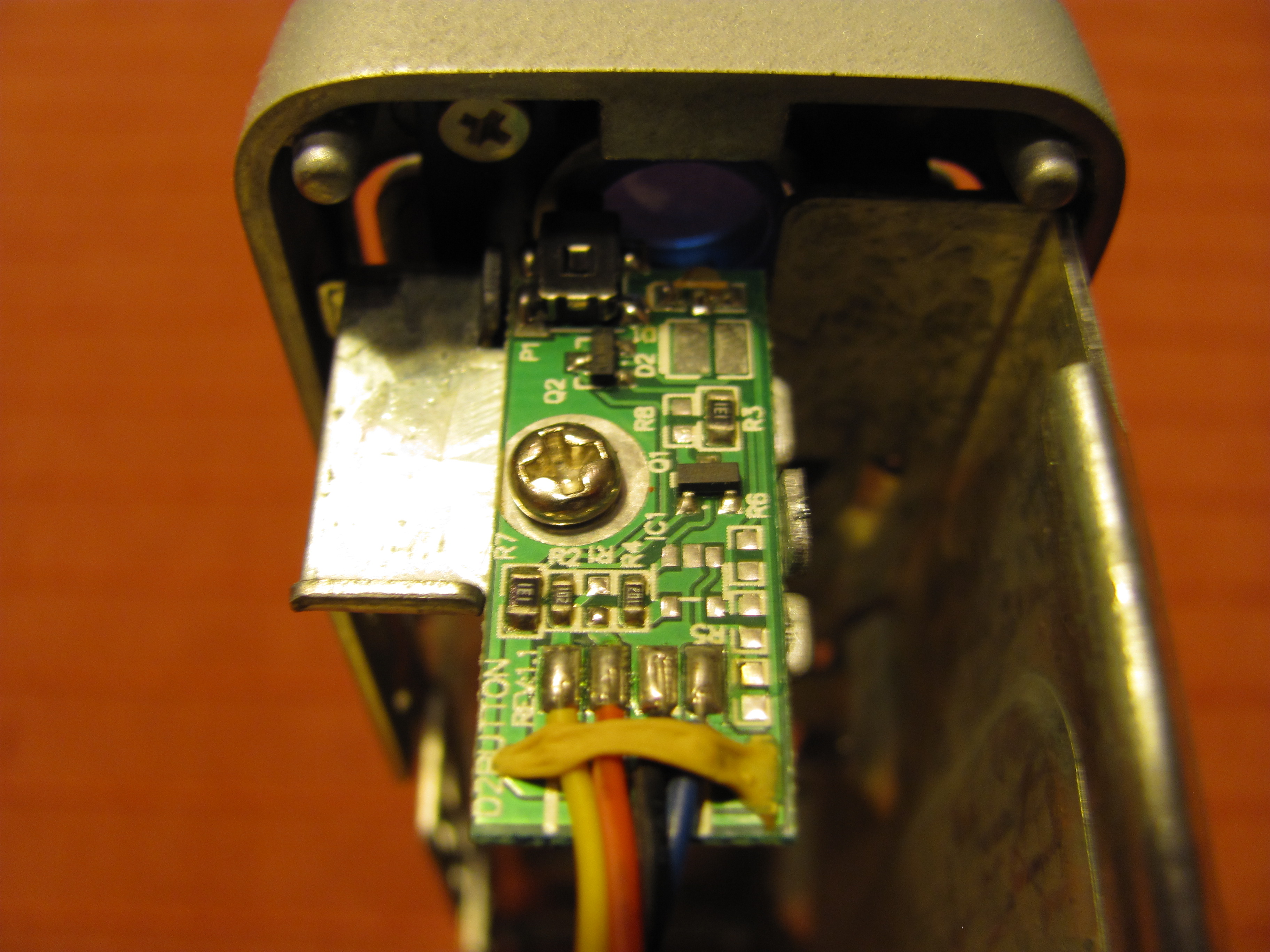

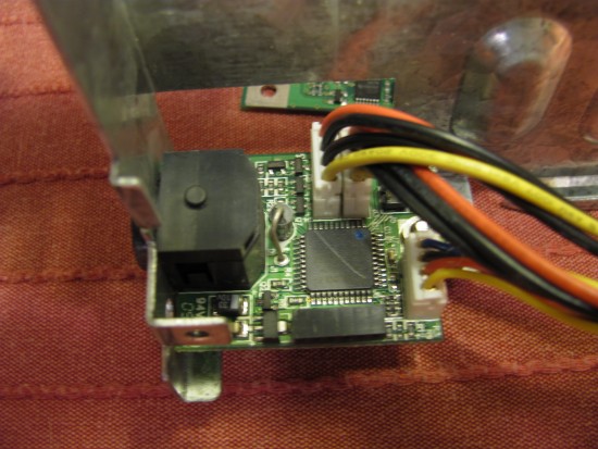

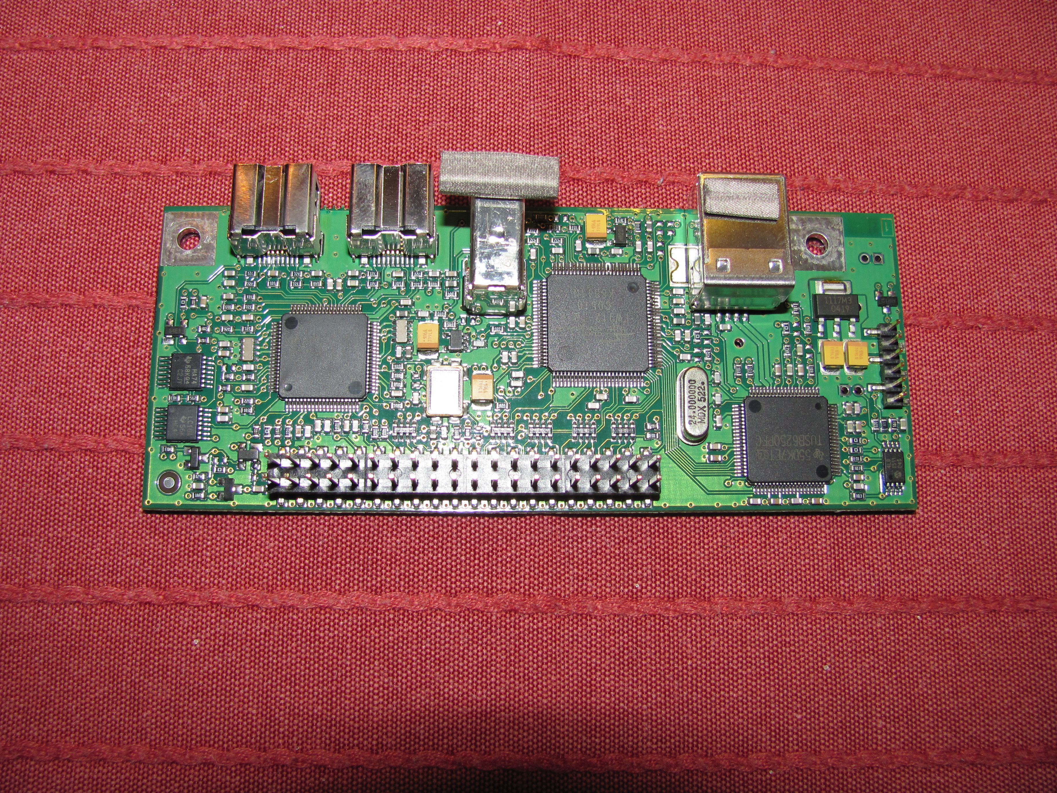

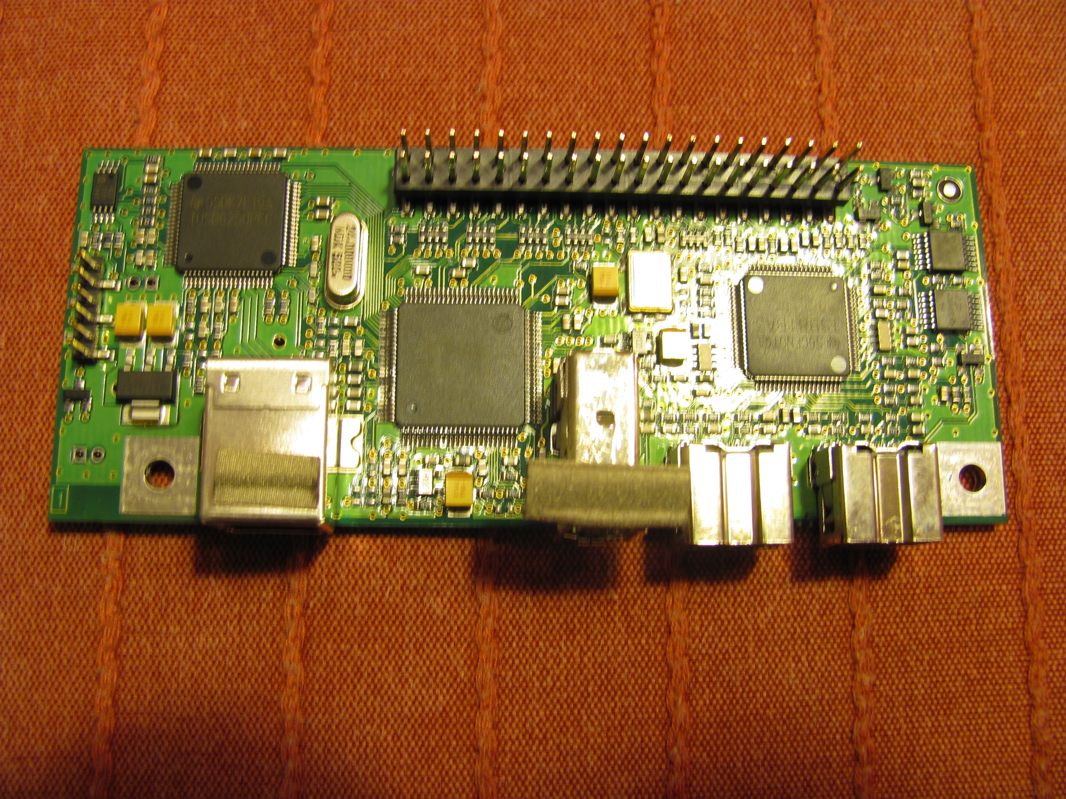

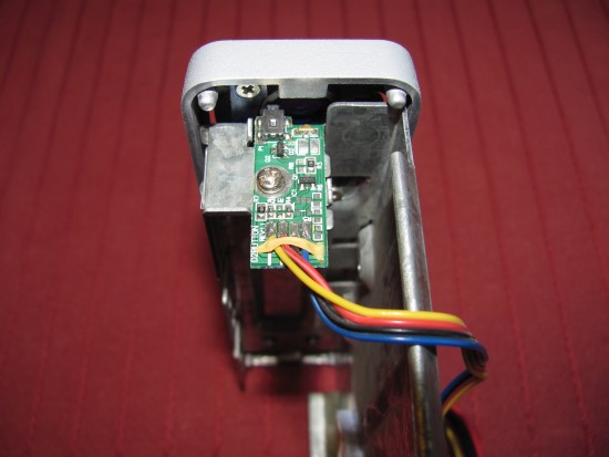

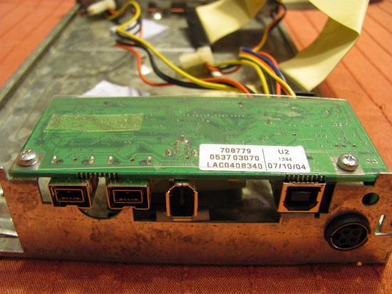

Thanks for the photos. They're a bit blurry, but ISTM that the functions of the 3 boards may be as follows.
PCB #1 - power switch and LED indicator (IMG_4194)
PCB #2 - power controller (IMG_4198)
PCB #3 - bridge PCB (IMG_4199)
PCB #1 appears to have a "soft" on/off switch and an indicator LED.
PCB #2 has a large 44-pin controller IC whose markings I can't discern. I suspect it controls the power to each of the drives via the 4 switching transistors (?) to the left of the Molex connector pair. The remainder of the circuitry is obscured by the cabling. The 6-way connector links this board with PCB #3.
PCB #3 contains an ATA Host Controller (whose markings I can't make out, so I'm not certain of this), TSB81BA3 3-port IEEE1394b transceiver, and a TUSB6250PFCR USB 2.0 ATA/ATAPI Bridge. This board communicates with the drive and with the PC host.
ISTM that the bridge board may be dead. One way to test this idea may be to disconnect PCB #3 from PCB #2 and then try to power up the drives with PCB #2 and PCB #1 on their own. Verify that the on/off switch is still able to control the drives, and that the LED still works.
If your testing confirms that PCBs #1 and #2 are OK, then hook up PCB #3 to the others. You can leave both drives disconnected. Now carefully measure the voltages at each pin of the "1117M" device adjacent to the USB port. This device is a 3-terminal LDO regulator (eg LM1117M-3.3). I suspect that it reduces the incoming +5V supply to +3.3V. Do not slip with your probes, as catastrophic damage will probably result. Use a screw hole as your ground reference.

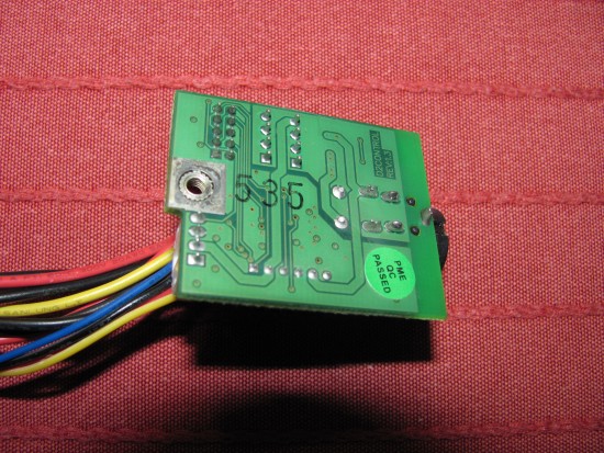

PostPosted: December 15th, 2013, 16:31
Posts: 13
Location: Canada

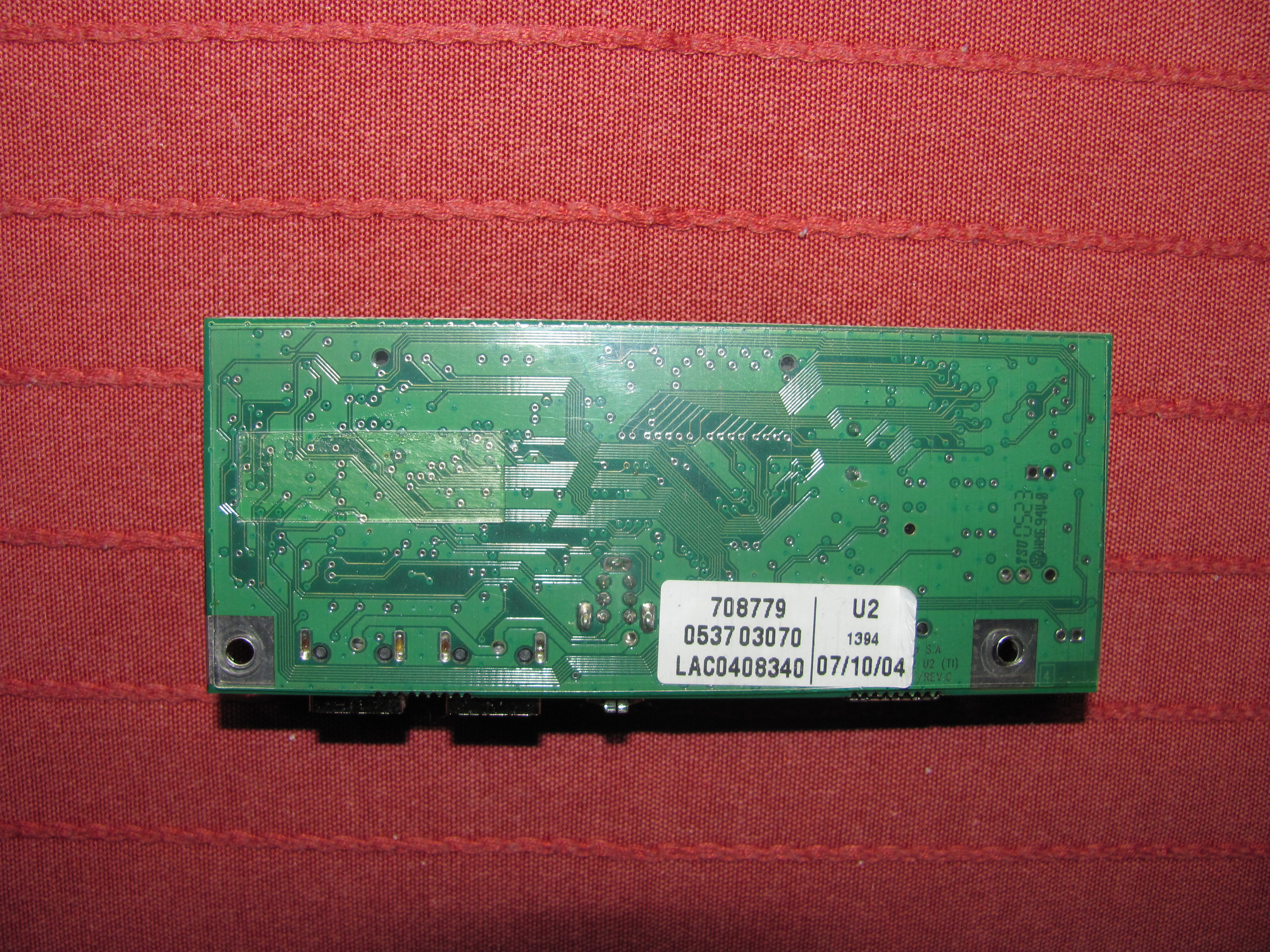

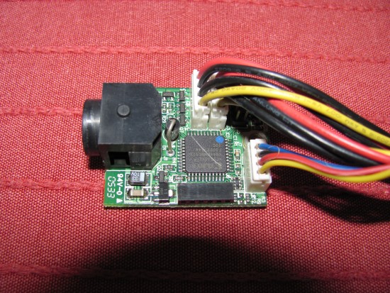

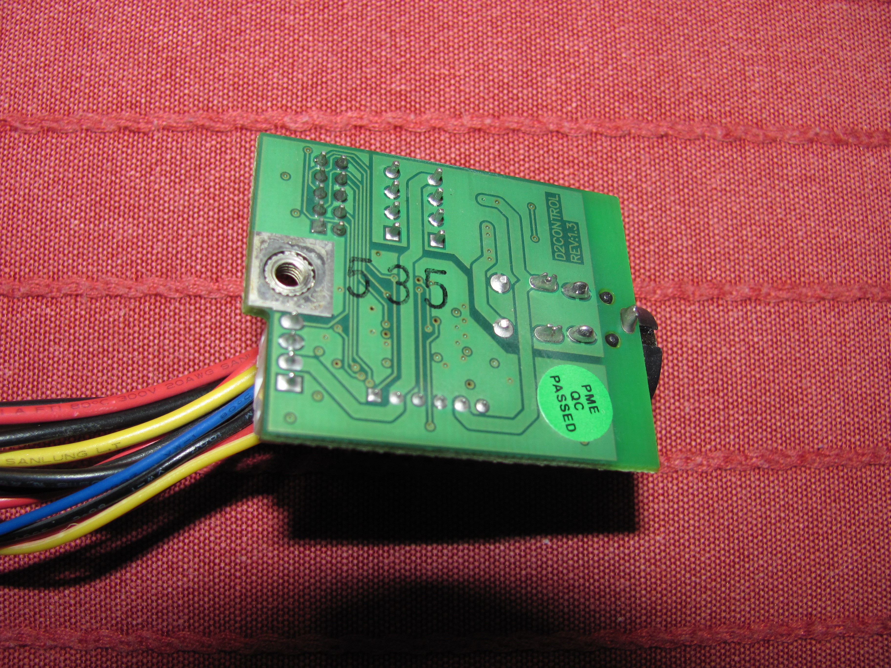

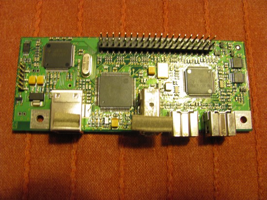

Hi there,
Your analysis is correct:
PCB #3 - bridge PCB
...disconnect PCB #3 from PCB #2 and then try to power up the drives with PCB #2 and PCB #1 on their own. Verify that the on/off switch is still able to control the drives, and that the LED still works.
Both drives spin up and the LED is stable blue from the beginning, whatever drive I plug to the longer molex has a delay (few secs) to start comparing to the one plugged in the shorter molex.
The first thing I noticed when measuring the LDO regulator 1117M is that regardless whether the switch is ON or OFF, the voltage does not change.
I had to do this with both PCBs outside of the case, I mean none of the two was screwed to the enclosure, but obviously in contact with the switch through the wires.
I put the black probe in a screw hole of the enclosure.
If you look at the 3 legs from the top:
1117M3
2V 3.2V 5.2V
2V is the leg closer to the USB port, while 5.2V is the leg next to the 6-way connector.
What do you think?
Now, better photos...
Thank you!
Alex
PostPosted: December 15th, 2013, 18:13
Posts: 17336
The 1117M3 is an adjustable LDO regulator that is set for 3.3V. It is working correctly. After looking at the datasheets of the components on the bridge PCB, ISTM that all are probably powered from that same regulator.
There are two signal traces connecting the control PCB to the bridge PCB, but I confess that I don't understand their purpose. Unless the bridge PCB is missing some requisite information from the control PCB, IMHO the bridge PCB is most likely dead. Moreover, since neither the USB nor the FireWire ports are working, then it would appear that the OXFW912 bridge IC is the most likely culprit. If I'm correct, then I can't see any solution that would be both expedient and economical.

http://ww1.microchip.com/downloads/en/d ... 21203p.pdf
OXFW912, Oxford Semiconductor, marking FW912, 1394B-to- ATA7/ATAPI Bridge. Firewire800. Firewire400. USB 2.0:
http://www.semiconductorstore.com/pdf/n ... 912_PB.pdf
http://datasheet.eeworld.com.cn/pdf/OXF ... XFW912.pdf

I did not try the FW port because I do not have one on my laptop, but I have a FW PCI card that I can mount on an old desktop PC so that I can test it.
Given that both discs spin up, would you exclude any issues with the 80 ribbon cable?
I guess I cannot find the bridge PCB as a spare part, right?
How about if I buy two enclosures for the two discs just to get two separate storages? That should not be an issue, at least I can use the discs.
Alex
PostPosted: December 15th, 2013, 19:26
Posts: 17336
If you're looking for a spare bridge PCB, I would search for the numbers on the sticker on the bottom of the PCB, or preferably for any numbers under the sticker on the PCB itself. Be aware that some numbers will be YYWW (Year / Week) date codes.
As for your question regarding the ribbon cable, all I can say is that some bridge firmware is configured to identify the enclosure only if the drive(s) come ready, while other bridge firmware will enumerate the enclosure to the host PC even if no drives are present.
One other thing I've noticed is that one of the 6 interconnection pins is a "switched +5V pin", probably from the second drive. Therefore ISTM that the bridge probably has a way to detect if the last drive is receiving power.
The +5V supply and Ground pins, however, are wired directly to the power input and are not switched.
