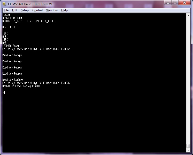

I try to recover files from ST3250820. I receive following error in terminal. On level 2 drive spin down and up

Dear Friend Jerovsek
Ur Problem Is Not Resolved By Just Terminal.
u need minimum Salvationdata,DFL, Tool To Handle This Case.
Your Friend
Jignesh Pankhania

' $ ' and AMR...
I am afraid It takes something else more than ......that tools.
Even with UDMA alone.

BlackST wrote:
' $ ' and AMR...
Dear Friend BlackST
I Have done many many cases with SD no problem with it sometime this issue is related to head but mostly resolved with head swap.
so why i tell them this case is not for terminal only need basic setup and good knoledge.
your friend
jignesh pankhania
With the right tools and knowledge its possible for all heads to read in such situation without changing them

hddguy wrote:
*THUMBS UP*
If there's servo there's hope .
