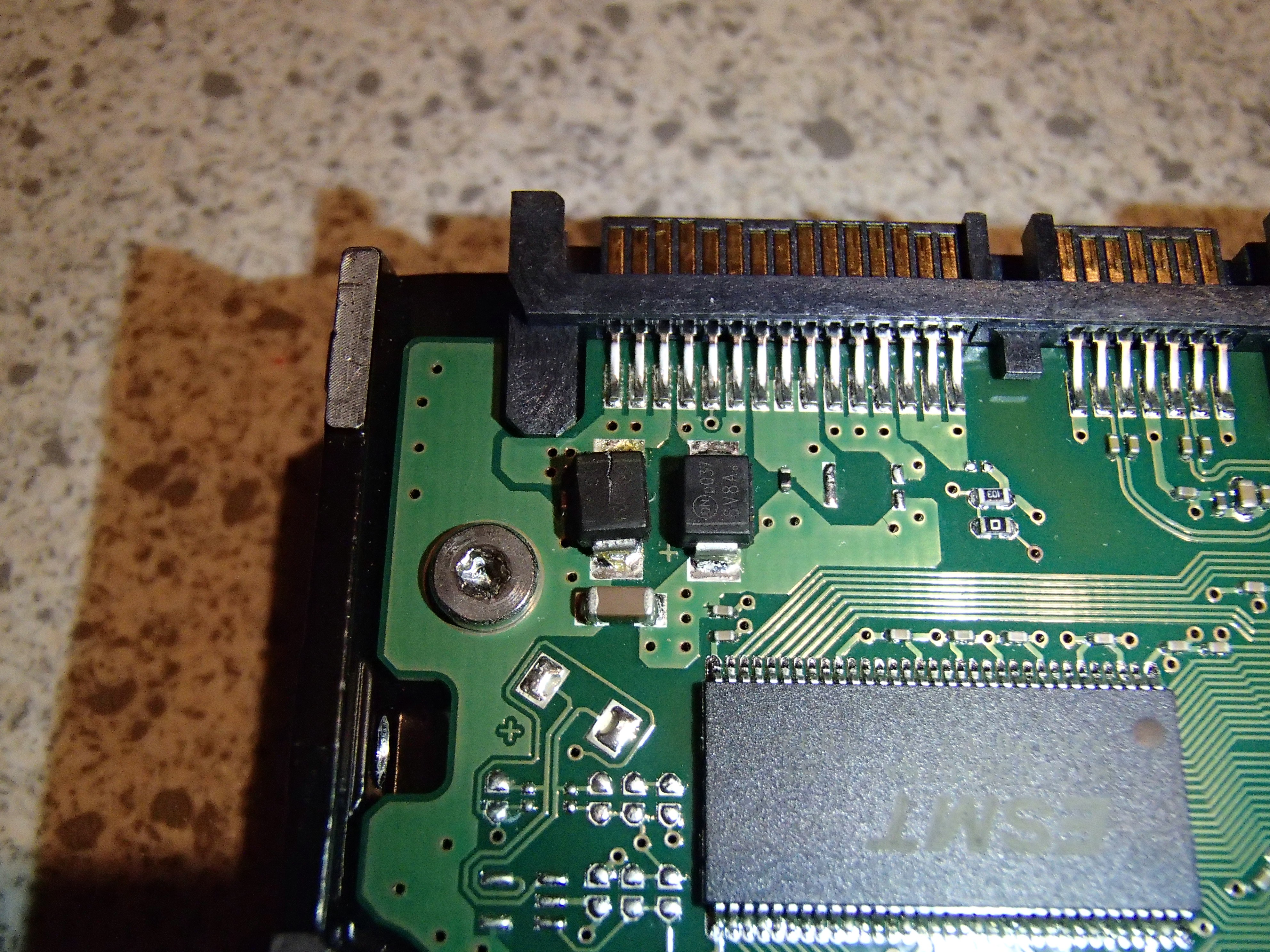

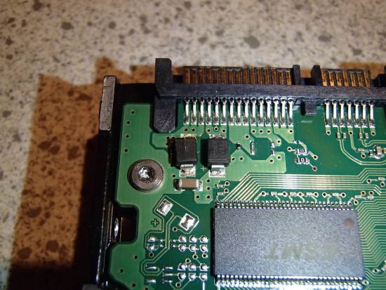

I receive Samsung HD103SI. Drive doesent spin.
I check PCB and I found that one selectde element is broken.
Is thic common problem for this drive?
Picture is not from this drive
 Post subject: Re: Samsung HD103SI burnt PCB
PostPosted: December 17th, 2013, 8:01
TVS Diode. Search this forum for it. :-)
PostPosted: December 17th, 2013, 8:28
Posts: 17337
If the 12V TVS diode were shorted, then it should shut down the PSU.

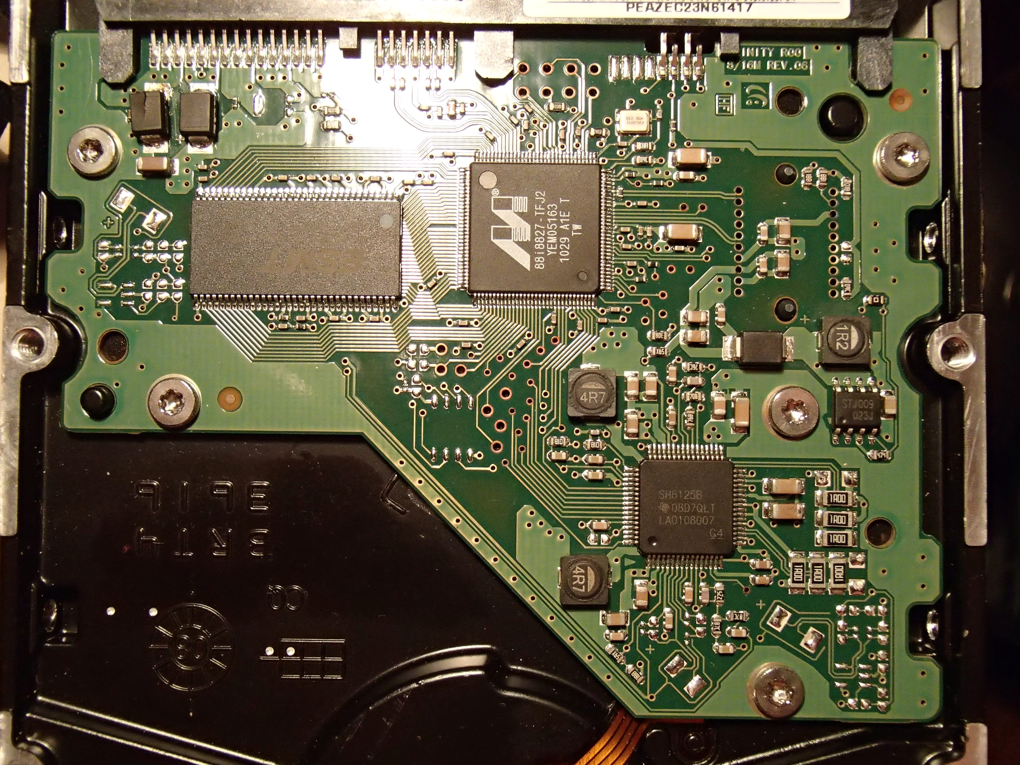

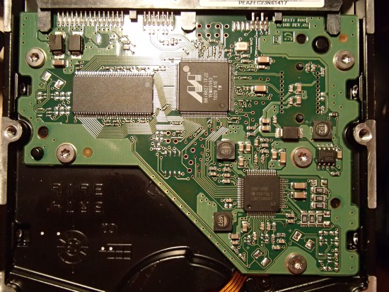

thank you Mr. Zabkar and PCimage for replay.
It's hard to read. PCB photo attach. How to identify right model?
PostPosted: December 17th, 2013, 22:12
Joined: July 2nd, 2011, 14:16
Posts: 463
looks like the drive sustained an over voltage and the Black diode might have done its job. Snip the broken black thing off and your drive should work again. If not, then the fuse could have gone and you will need to do more work on it.
PostPosted: December 19th, 2013, 3:38
Posts: 396
Location: slovenija
Hello ShaneWard,
thank you for your suggestion. I unsolder diode and drive spin up and I was able to recover all data.
Just one more question. How to identify type of diode to replace it eith new one?
PostPosted: December 19th, 2013, 5:06
Posts: 17337
Just replace it with an SMBJ12A. My FAQ tells you where to buy one. Alternatively, just use a 12V TVS diode from any other board.
