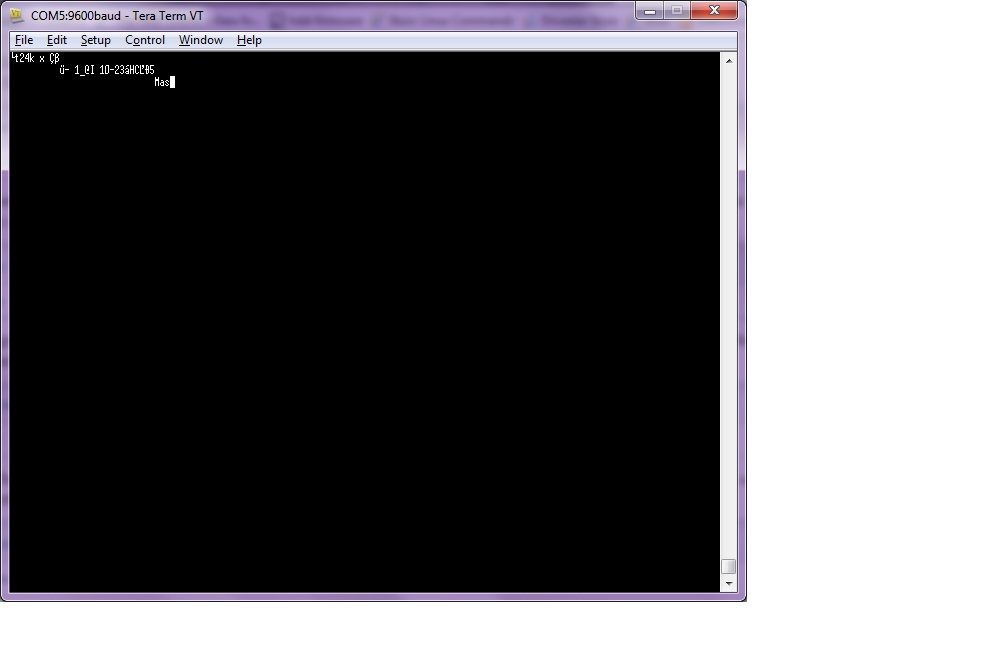

I'm unable to communicate wit ST380215A via terminal
TX upper second pin right to left
RX lower second pin right to left
ground first pin right to left
baudrate 9600
FW: 3.AAC

I think the baud should be 38,400

RX/TX signals on Seagate hard drives:
http://atola.com/products/insight/manua ... ction.html
3. Open up the terminal window, select the port number and speed (for Seagate 7200.10 and older: 9600; for 7200.11 and newer: 38400);
 Post subject: Re: Seagate Barracude 7200.10 ST380215A
PostPosted: December 17th, 2013, 3:52
Posts: 17215
The "[10]24k" would suggest that the baud rate is correct. Other than verifying the parity and start/stop bit settings, I would measure the voltage levels on both sides of the TTL interface. I would also confirm the grounding.
PostPosted: December 17th, 2013, 4:13
Yes, and the "Mas" is the start of the "Master" output from a healthy drive of this type.
PostPosted: December 17th, 2013, 5:24
Posts: 396
Location: slovenija
Problem SOLVED. It was problem with grounding, like Mr. Zabkar mentioned.
I connect ground directly to HDD.
HaQue, thank you for your baud rate suggestion. For this model is 9600
Thank you Mr. Zabkar, HaQue and PCImage for your replays and support

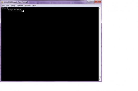

PostPosted: December 17th, 2013, 5:26
Posts: 396
Location: slovenija
ground on HDD chasis/screw
